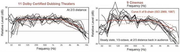

And then there's the movie industry which is so proud of their "standards":

It's the other way around actually! The wild variation makes the job more critical, this is why you probably have records you cant listen to. Small spectral "mistakes" are *amplified* by inaccurate speakers and rooms, and a what would appear to be small peak turns into a big one if doubled at the listerners room, Think about it.
What do you want me to think about? Getting tonal balance right is a moving target as long as there are no strict standards. There are general trends though, just like in the fashion industry. Listen to recordings from different decades. One can hear the NS-10s, Genelecs, etc. and control room design philosophies.

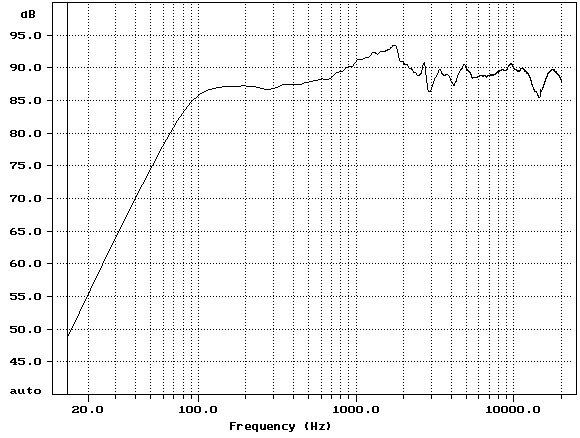

Actually the NS-10 is a good example of wider "Q" deviation in freq. response always "coloring" the sound. One full octave (from 1kHz to 2 khz) is about 3db higher than the average.

The graph you posted shows the NS 10 midrange peak some 7 dB louder than the low frequency response.Actually the NS-10 is a good example of wider "Q" deviation in freq. response always "coloring" the sound. One full octave (from 1kHz to 2 khz) is about 3db higher than the average.
If you listen to these within a foot or so, I'd bet things would improve.
The response does not improve when you get closer to them, a 7 dB on axis peak does not go away without -7 dB of EQ.
The average looks to me to be about 88 db. The average "bump" in response between 1-2 kHz seems to be about 3-4 db higher.
As you move further into the near-field from 1 meter, the entire output "tilts" in favor of the lower freq. response.
Nearing 1 foot in distance (..sort of a "non"-headphone, headphone), I think it's likely that the response will effectively raise the net average, perhaps enough to account for that 3-4 db.
(..same thing happens with headphones, though to a more extreme degree because of the closer proximity.)
Now, if you move further out than a meter in distance you will end-up with an even broader-band deviation for lack of baffle support (starting at around 700 Hz), which would make things far worse the further away the listener is from the monitors.
Basically if someone has these as monitors at 2 feet and someone comes into the room a few feet behind them, the result will be dramatically different for those two people. Not bad for the person in the "hot seat", and utter piercing sh!t for the person 6 feet away.

A broad 2kHz peak is a peak. Any apparent tilting of the overall response with change in distance doesn't make it stop sounding like a peak. Besides, the overall response already tilts up, and already has no bass to speak of. NS-10 are nasty. This is not news.
