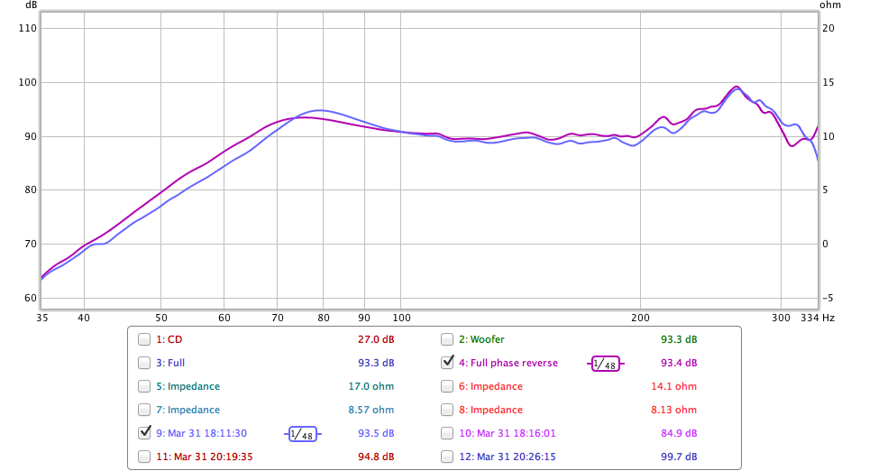

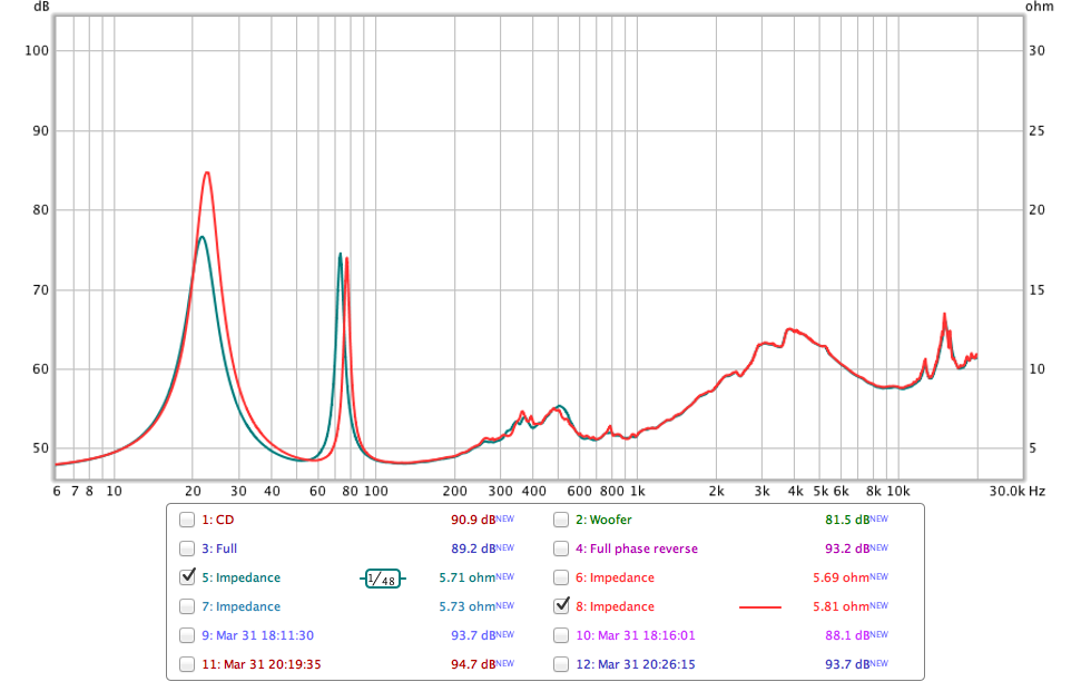

I did enlarge the vent holes also. Made them more than double the size. Tuning went up a little bit, but not as much as I had hoped (see impedance and SPL graphs).

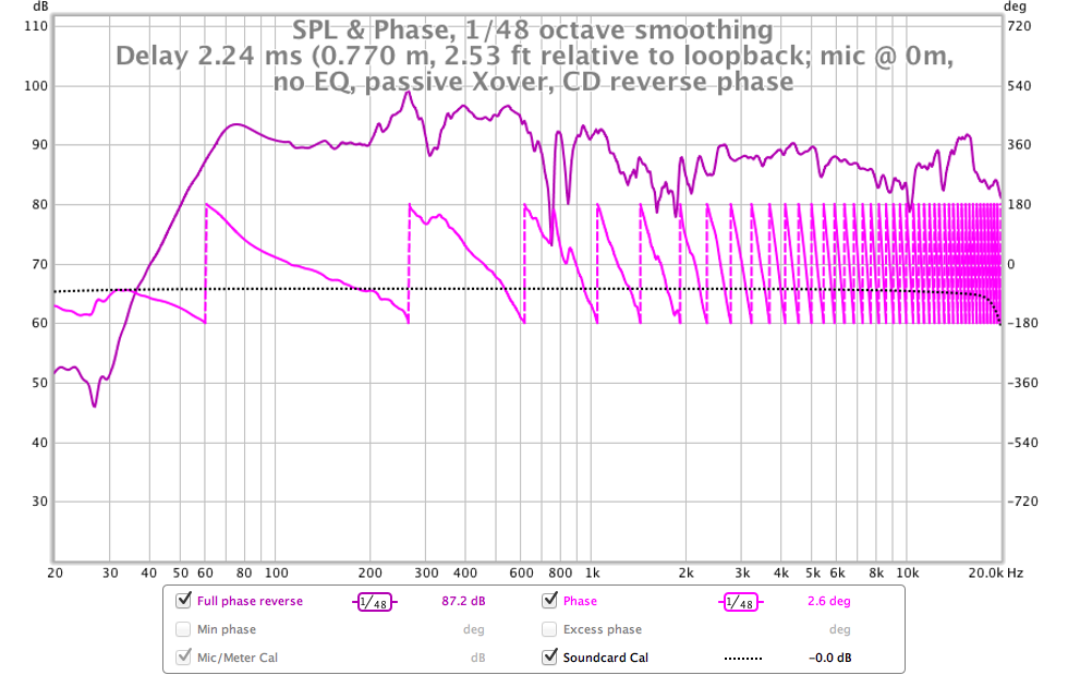

  • SPL Full, delay 2.24ms relative to loopback, mic at 0m, no EQ, passive Xover, CD reverse phase.png

Correct. I did that because it results in a much flatter phase response. The phase response worsens the farther away I move the mic from the horn.

Just to be clear: Are you saying that the phase response should be more or less flat at any distance from the horn mouth?
Maybe I should try different measurement software? With REW the phase response just goes all over the place if there is a delay. I mean, the pink curve is taken with the mic right in front of the horn (at '0 meters') and the only difference with the green curve is that I have the loopback as timing reference option enabled, which displays the delay of the DCX2496 AD/DA conversion... (note the scales on the right)

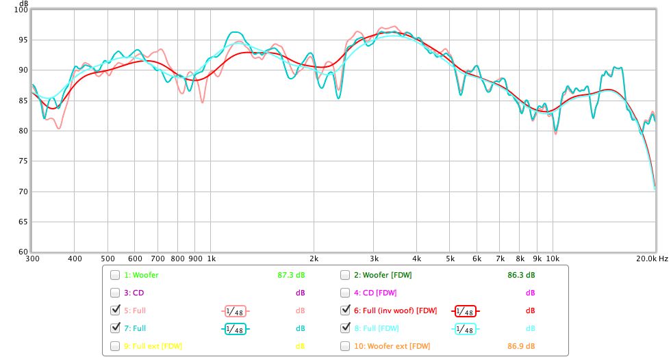

Another way to deal with phase is to make three measurements -- woofers only, tweeter only and both playing together (all without crossovers of course, and including phase measurement and measured without moving anything between takes). Import the FRD files into something like Xsim. and simulate the situation of both playing together using the separate measurements. Adjust the delay on the tweeter (in Xsim's "tune" window for it) until the "together" magnitude matches what you measured.... then the relative delay (which is all that matters) is correct. Jeff Bagby has a detailed description of this somewhere probably at the Techtalk forum.
I think you will see nicer looking phase if you set the IR windowing in REW to 5 cycle FDW instead of fractional octave smoothing. Part of all those phase wraps may be due to the room/reflections; especially since you say you get smoother phase when measuring right at the mouth.
Did that...

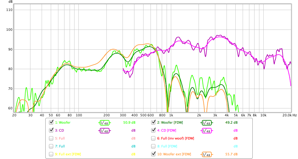

...and that today outside on the roof, speaker pointed upwards. Here are the results. Phase looks much better now:spin:.
Going to try this in a bit... Stay focused.
And thank you guys!! ;)
Also included measurements with and without horn extender. The effect can bee seen clearly: almost 4dB more:cool:

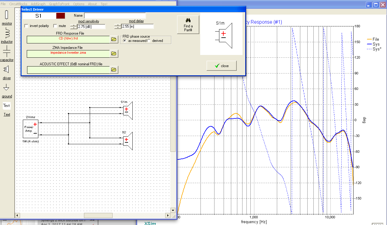

Like this?
(Btw, nice little program you wrote! Makes it very easy to mess around with Xover components :cool:)

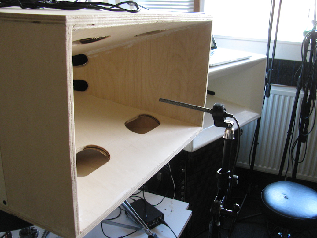

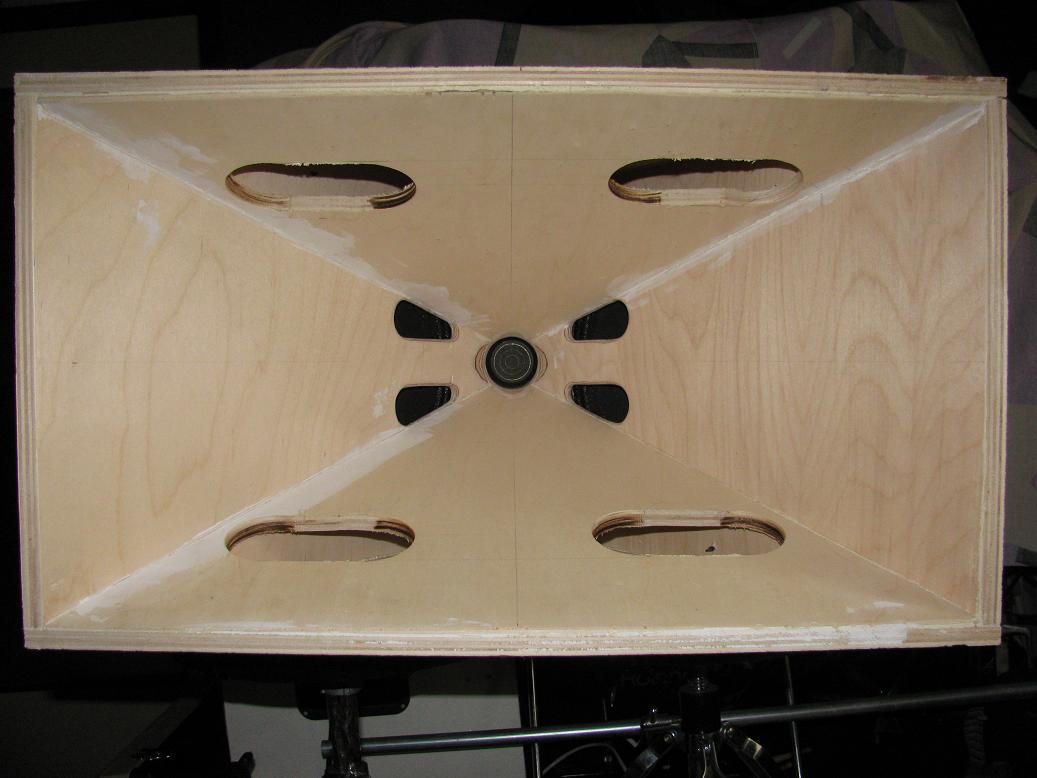

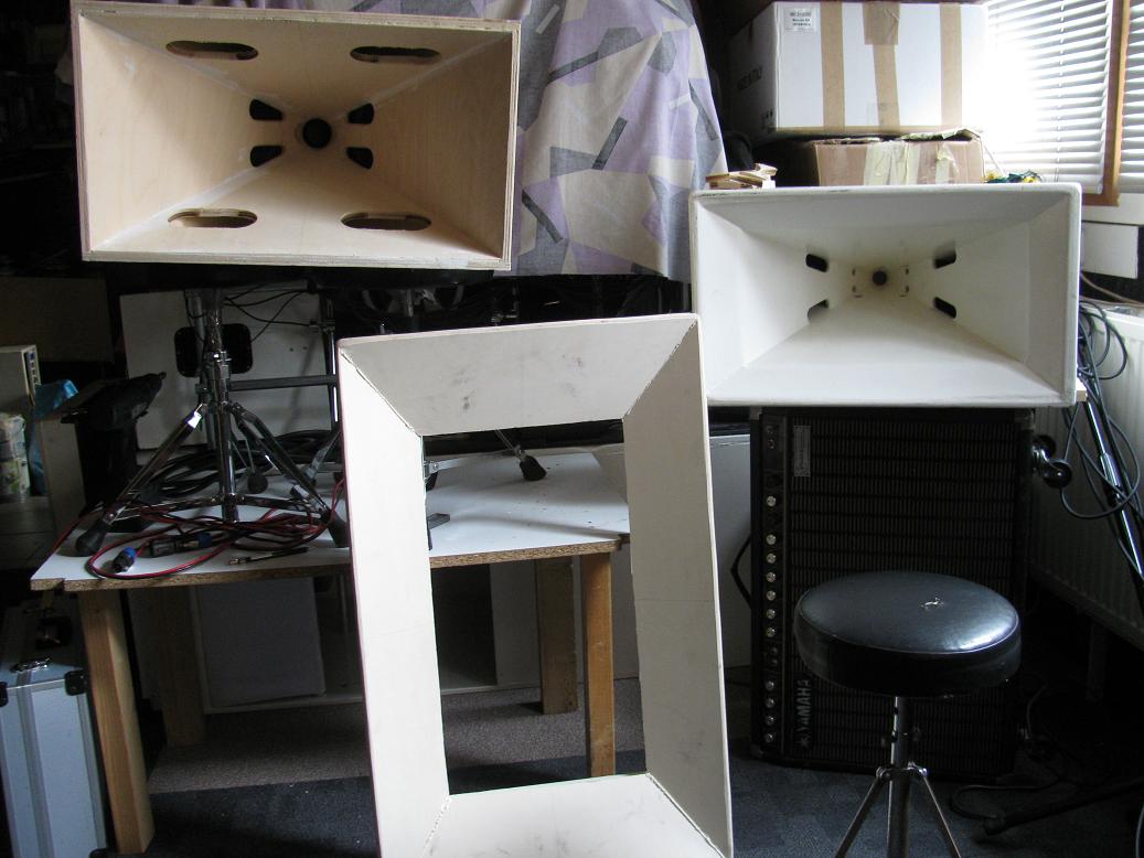

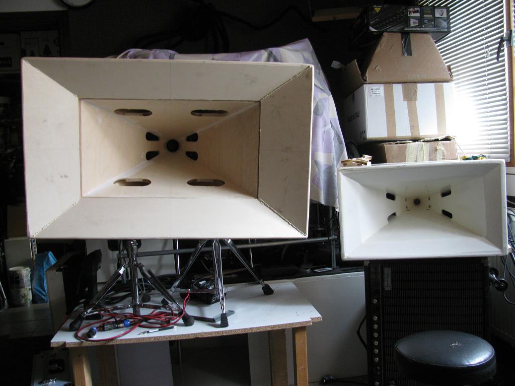

Some pictures to show the current prototype. With and without dixie cup extender. The white Synergy on the right is the one I made with the BMS4550, Visaton M10 and Eminence Beta12 (see my other thread).

Like this?
Yeah, that's basically it. I'd expect the match to be a little closer, though, but in the area where windowing of the IR is used that can get messed up some (windowing isn't a linear math process). The effects of the delay error will be strongest at higher frequencies, so I preferentially optimize for match there like you did.
(what's the 'Dixie cup extender' you're referring to?) edit --- Never mind, I think I see what you mean.

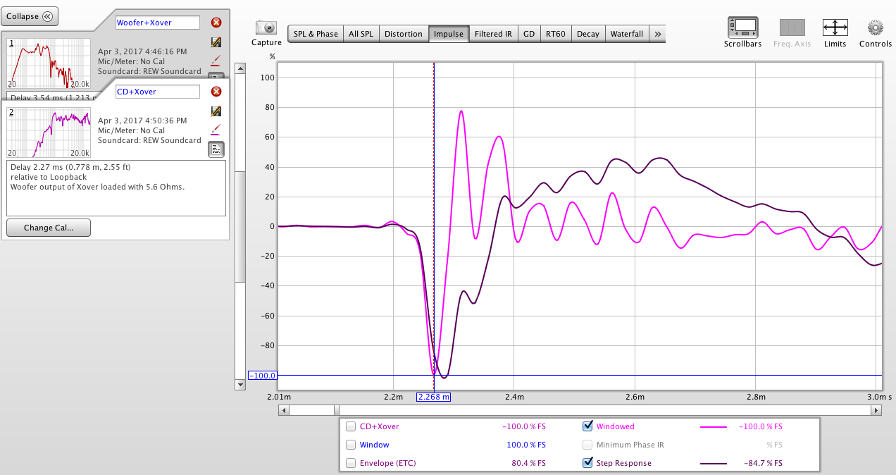

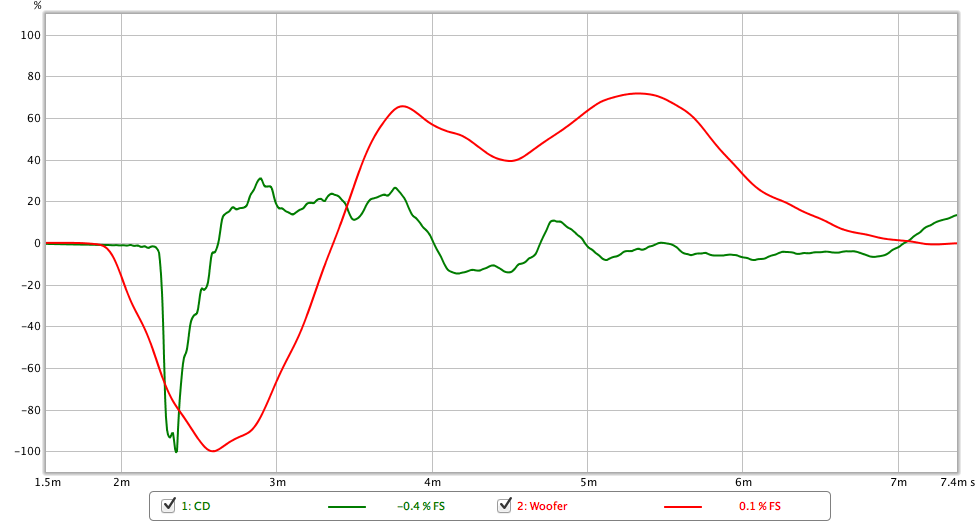

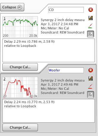

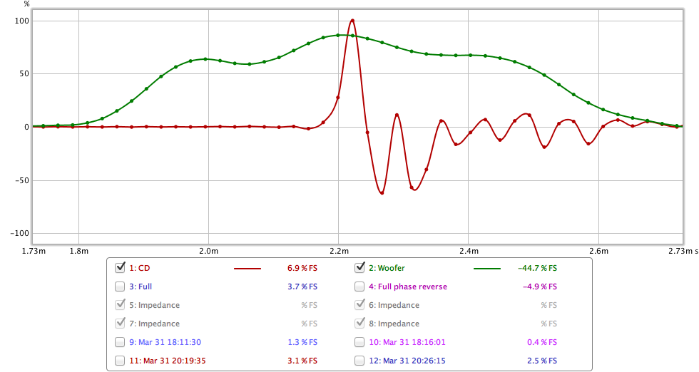

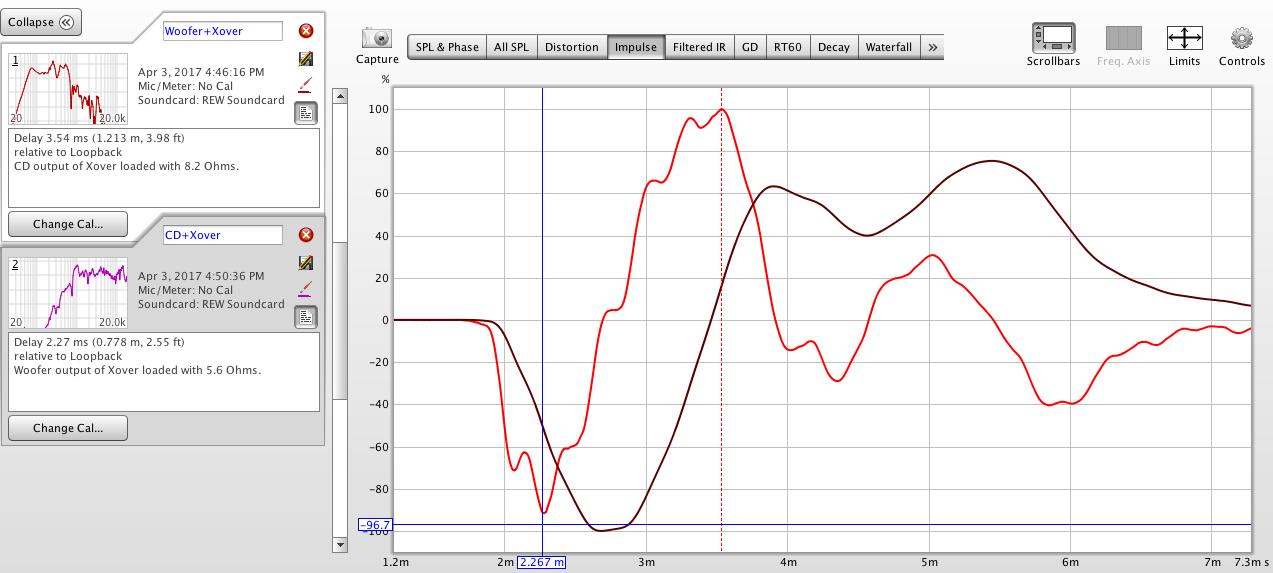

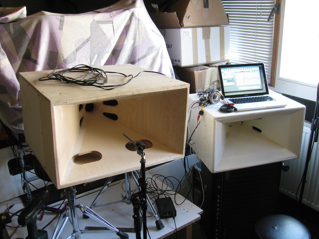

Delay measurements
I was still unsure about the delay needed for the CD, so I figured I could specifically measure woofer and CD delay using REW's loopback timing reference... So I did some measurements again using this setup to have as little room influence as possible:
attachment.php
attachment.php
Then I did about 10 consecutive measurements to rule out glitches and other errors. This resulted in the following:
attachment.php
These numbers kept turning up each measurement, so I'm pretty sure they are correct. This means there's only 50 microseconds of path difference, or 1.6 cm, or 0.05 ft, or 0.6 inch. The impulse responses look like this:
attachment.php
And the step responses look like this:
attachment.php
All measurements were taken without any EQ, delay or crossover (that's why the CD doesn't start at 20 Hz, but at 200 Hz).
So unless my measurement setup (see first two photographs) is wrong, I don't think I would really need to delay the woofer section (yes, the woofer section, no the CD). I've seen that the majority of impulse response charts on this forum have scales in milliseconds, not microseconds, so I guess I'm on the right track here. Can anyone please confirm? This looks a bit to good to be true :eek:.

If it looks too good to be true, it usually is as I've found out to my embarrassment a couple of times.

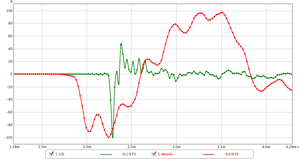

As I may have mentioned before, with minimum phase filters you align the drivers such that the starting points of their IRs are aligned. My eyes say the IRs in your measurement are about .4 ms off. Your woofer apparently has a high BW so when you align starts of IRs, the entire leading edges of the IRs will be just about coincident. You are fortunate with these IRs that have no pre-ringing, the starting points are easy to determine.
Ultimately, you need to do the measurement with the XO filters in place but only one driver at a time powered. Given you are using passives, you may need to substitute a dummy load for the un-driven driver. The reason for this is that the filters have different delays and thus affect the time alignment. The differential filter delays can compensate for a path length difference.

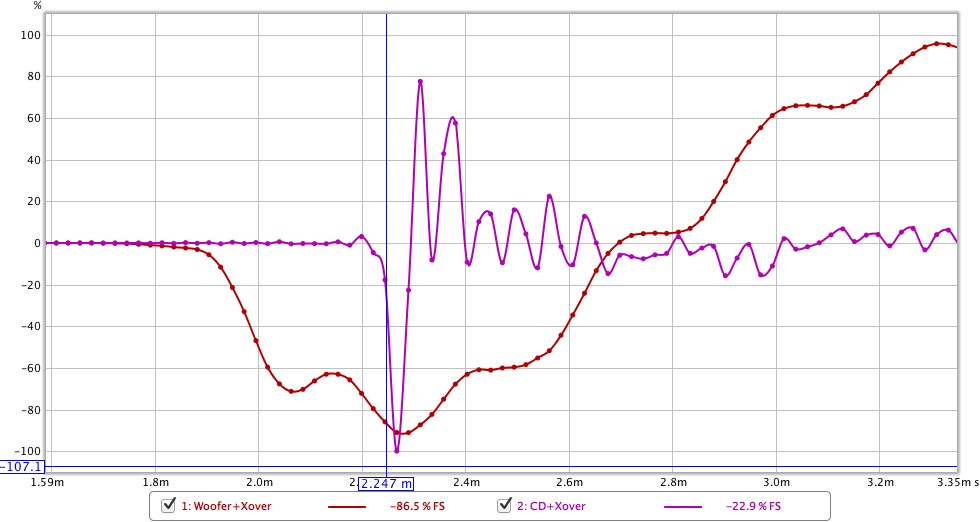

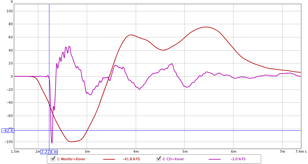

Delay measurements with Xover
These are per driver with the prototype Xover in place, substituting a load for the non-connected driver, overlayed in REW...
Impulse response:
attachment.php
Step response:
attachment.php
REW screen:
attachment.php
The woofer delay calculated by REW (vertical red dotted line) is obviously incorrect. I placed the cursor at where I think it should be: 2.267 ms. That's (almost) exactly the delay of the CD...
attachment.php
From the step response, there's still 0.4 ms between the start of the response, the peaks are time aligned. Who thinks that should be corrected?
The prototype doesn't sound bad at all, on the contrary :cool:.

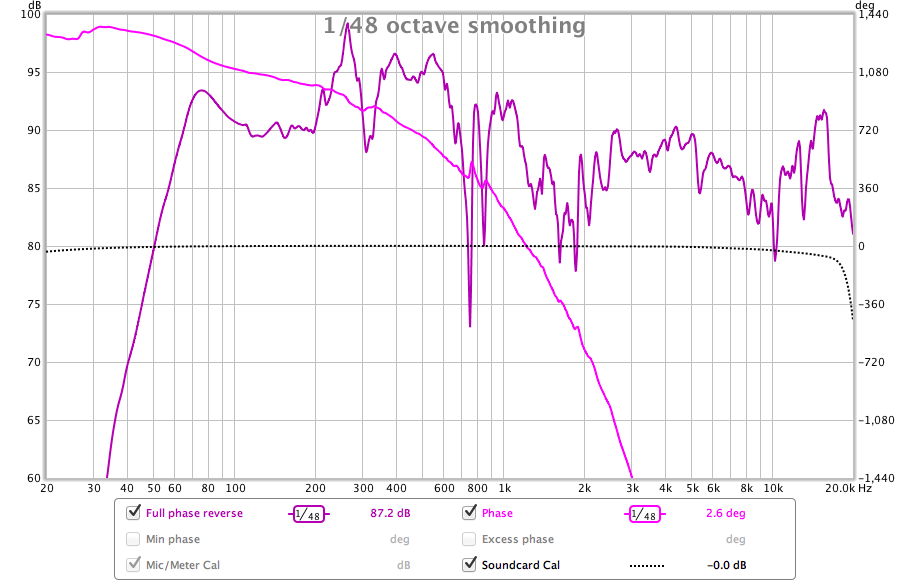

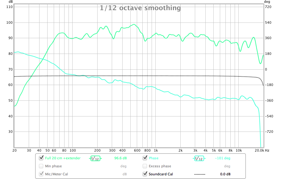

ra7
Joined 2009

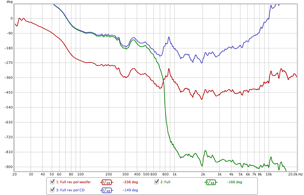

Why not measure with the crossover in place and look at the phase response through the crossover? If there is a jump in the response then there is a delay there. Remember that high-pass and low-pass filters also add their own delay. Getting these impulse responses exactly aligned means little in the final design. What you are really looking for is a smooth phase response through the crossover.

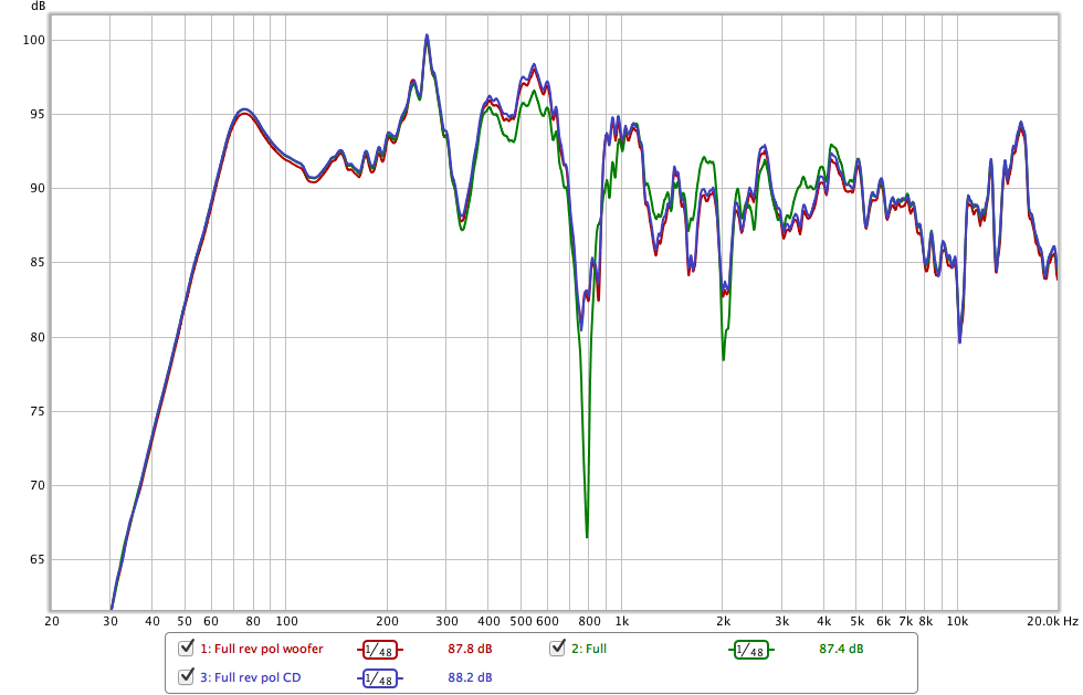

Thank you for the suggestion. Using the same measurement setup, this results in the following phase response, using various crossover configurations (woofer inverted, 'normal' and CD inverted):
attachment.php
Looks like one of them definitely needs the be connected inverted. The green curve (both drivers connected 'normally') shows a big jump in phase.
But the SPL curve shows a big dip from 700-900 Hz, so the crossover still needs some tweaking :s.
attachment.php

ra7
Joined 2009
Looks like both drivers connected to same polarity results in significant delay. Ditch that option. Reversed polarity for one driver is the way to go.
From the measurements, is your crossover somewhere in the 700-1k region? That would correspond to the little dip and peak in that region in the blue plot of the phase curve. You can calculate the approximate delay by knowing the jump in phase.
1 cycle at 700 Hz =700 cycles/second
Or, 360 degrees at 700 Hz = 1/700 seconds = 1.43 ms, i.e., it takes 1.43 ms for one complete cycle of 700 Hz.
So, for example, if you want to shift the phase by 50 degrees, delay = 1.43 x 50/360 ms
What would also help is if you plotted individual driver responses with crossover so that you can see the phase overlap through the crossover.
