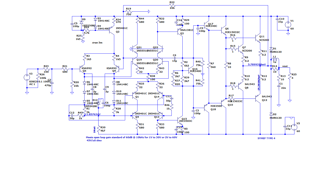

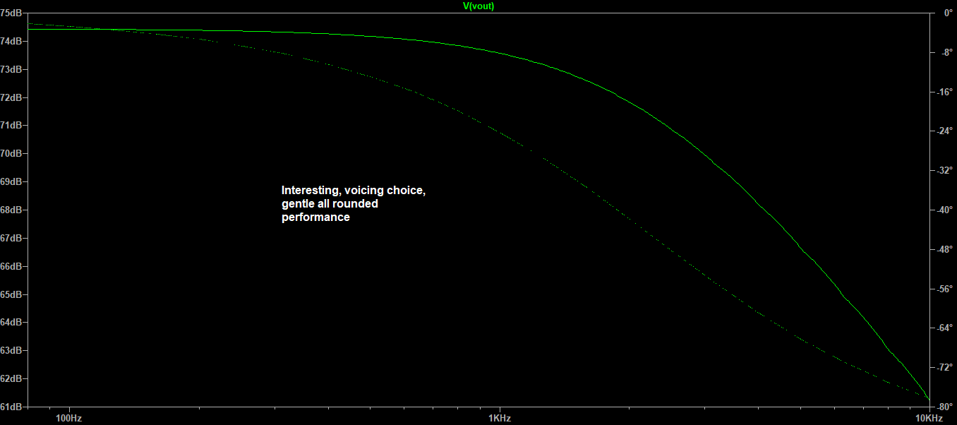

This is simplified Hafler P700 with different output stage..There are many amplifier standards. Instrumentation vs audio amplifiers also have different standards. So which is the most enjoyable amplifier standard. Heres another way to do the symef by our standards.
Current through D13 is 36mA. 5mA will be sufficient. R33 should 5k6 or more. As it is both of them are dissipating way to much heat.
Otherwise, it's interesting. Hafler P7000 supposedly sounded very good..

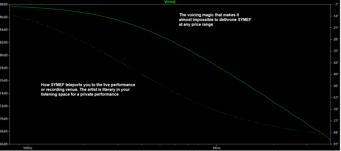

Most amplifiers are voiced as tweeter amplifiers due to customer preferences. If you notice many amplifiers have no bass definition and are difficult to use when mixing bass or drums, bass sounds like a single muddy tone. The next batch of amplifiers are voiced as midrange amplifiers. Very few amplifiers are voiced as bass amplifiers. But we do have Chameleons for example here's the voicing for the amplifier in this post https://www.diyaudio.com/community/threads/symef-amplifier.198500/post-7418716. It will get you there but it isn't a king but a prince its more like a full range speaker. There's a cult following for such voicings.

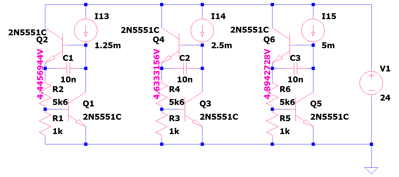

How good are popular current and voltage references, should we care?
Not most can beat the 1n4148 https://www.diyaudio.com/community/threads/morpheus-ultra-low-thd.406485/post-7601404
