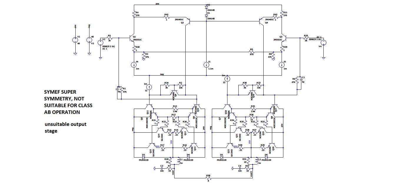

Here she is in super symmetry mode. The OPA604 uses an extra internal LTP to regulate the distortion contributed by the output stage loading the VAS
  • opa604.pdf

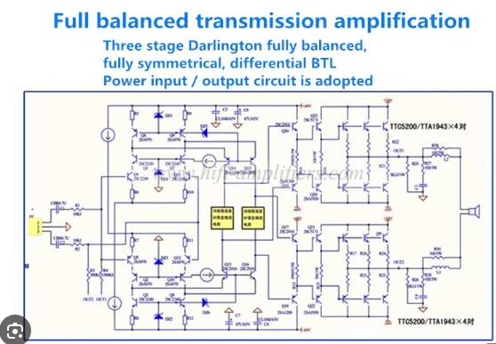

This amplifier exists in so many versions out there, but I still think we have the best 'one'. It might also be infatuation. You see most people grew up thinking their mama cooks the best cause thats the food your taste buds got conditioned on. Its like telling some people who grew up listening to class D and small digital amps that there exists class A, AB amplifiers. The issue is that its our brain that hears and once conditioned it will hear what it wants. The age group at audio shows is also telling. Theres a lot more grey hair than other hair colors. Nico is this yours:)
The original 1DIFFQC is a crazy amplifier. It does everything right and only uses 50% feedback. On the other hand the SYMEF does something the 1DIFFQC cant and that is it makes even unlistenable music listenable, it cleans up the music probably even better than a tube amplifier. It makes people that suffer from listening fatigue or who have bright speakers want to listen to music again. Lets see how the new tough cookie on the block the 1DIFFET will be received https://www.diyaudio.com/community/...ier-for-whatever-speaker.401371/#post-7405506.
