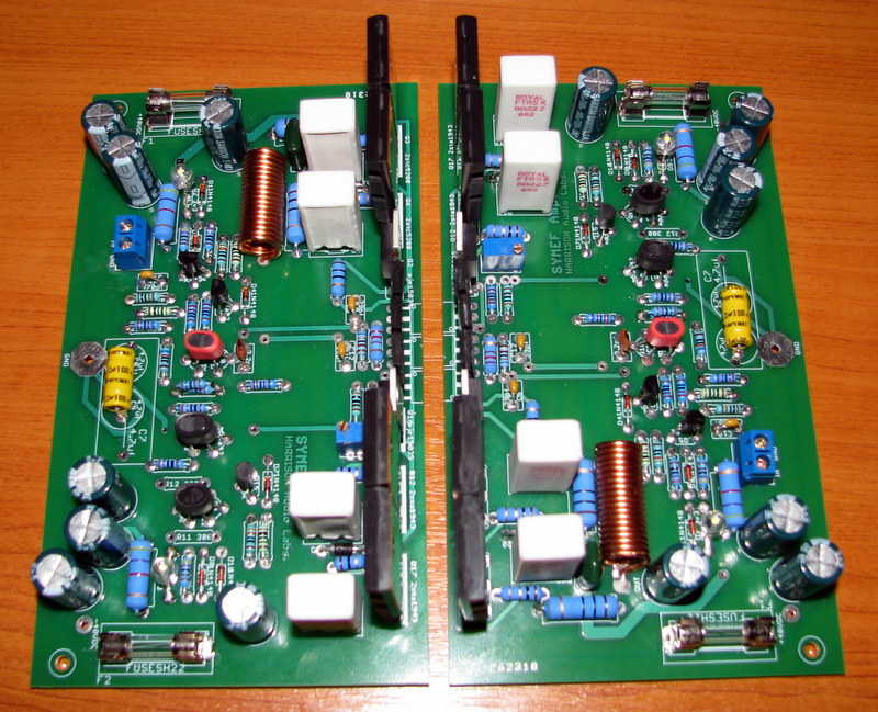

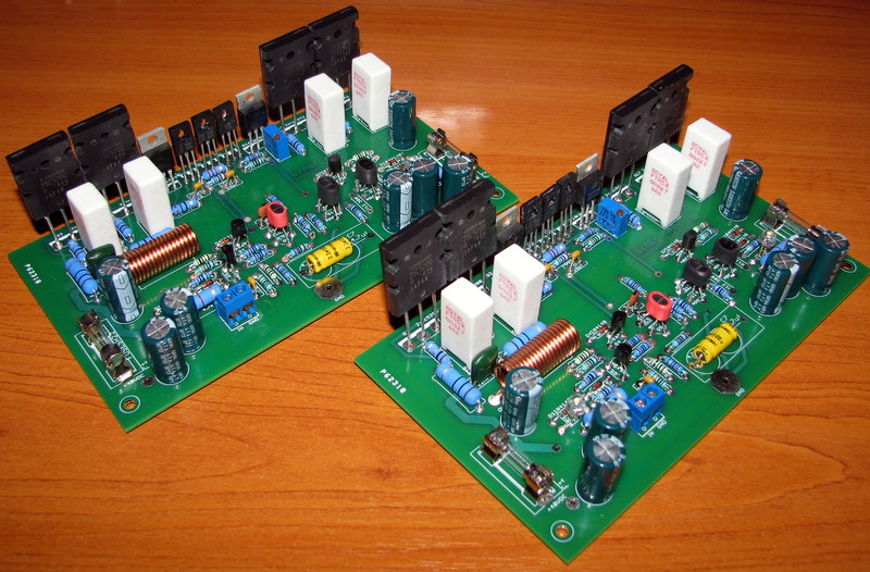

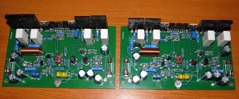

...... have finished boards
..... soldered last components arrived today ..... I have only to attach heat sinks and start testing ..... Thanks you Harrison !
All the best Alex.
All the best Alex.
Great job, Mr. Alex, as usual!
We are very anxious for the news.

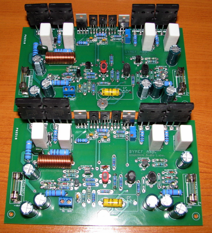

I would like to build this amp, but I have a question: why not minimize the empty spaces throughout the board? I like more concise builds, and I think this amp deserves a new, optimized, single and/or double-sided layout.
Max.
