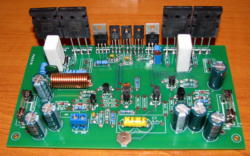

Heres how I do it.
1. Test all your components for defects including PCB (Note on this PCB there is one jumper)
2. Stuff PCB starting with small components working your way to large components i.e. output transistors
3. Examine assembled unit for any solder issues or bent pins shorting others
4. Attach assembled unit to PCB isolating the transistors from heat sink.(Test this)
5. Ensure bias trim pot is set for maximum resistance
6. Attach bulbs on positive and negative rails
7. Do a jig then power up, if bulbs light up, wash rinse repeat, you may have done this in poor light
8. If all goes well, set bias, attach scopes and torture amplifier, if it holds up
9. Plug in your speakers (some use speaker protection)
10. Plug in the "I like to move it move from Madagascar" CD
11. MOVE IT !!!!!!!!!!
12. WE LIKE TO............

It should be fine .
Bias is about 46mV across both emitter resistors.
i'm sorry which are the emitter resistors? R17, R10?

Hi Digger,
1. From schematic on site: R13,R14,R24,R25.
2. Yes use isolation pads to prevent short circuits
3. If you have a variable power supply, that will work too
All the best

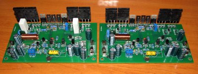

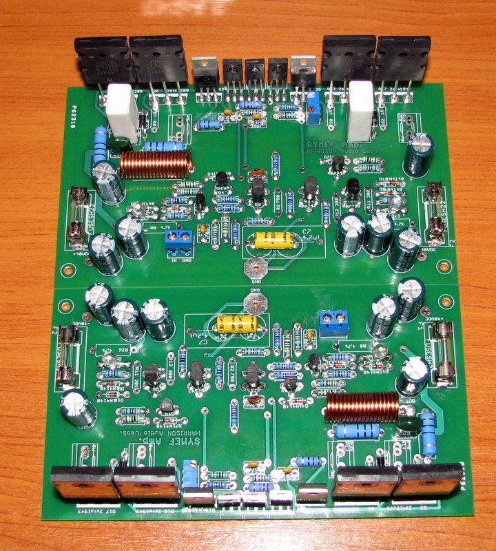

I just got the two PCBs
.....and second channel
.......stil missing few components , next week I hope to finish PCB's
Thank you Harrison ..........
