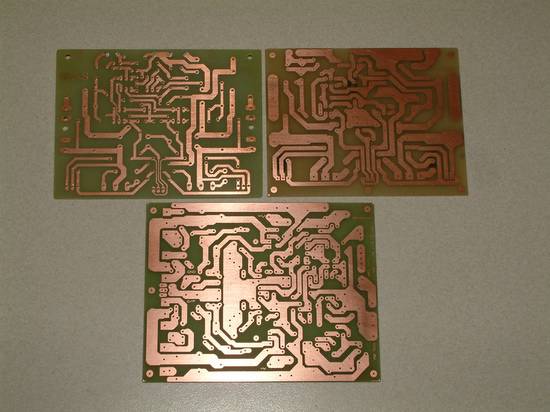

chalkandtalk said:Does anyone have any of these boards that they are not going to use?
If you mean the AAK version, then no, but I did etch a Symasym pcb based on MikeB's original layout, one only, top LH one in picture (the other two are also Symasym)
If it's of any use, you're welcome to it.
Brian.
