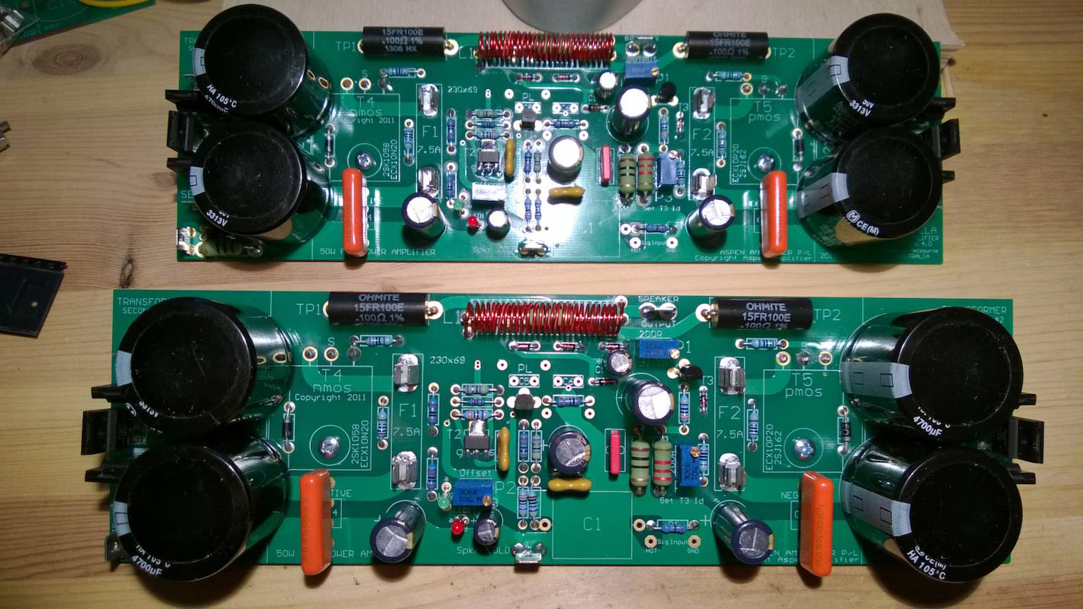

I've finally build two of my four boards aswell. Still waiting on the 1uF M-cap Supreme's I want to use on them, then they are ready to set the bias and be build into an enclosure.
Two questions though:
I was wondering, do I need to either place the caps at C5 and C6 ór place the resistor at PL. or can i leave them both out?
And secondly, I made the induction coil out of 27 windings of 0,8mm wire instead fo the 0,9mm (I couldn't find anny 0,9mm where I live, so subtituted for what i had on hand). I take it this won't pose to be a problem?
A pic of the boards, almost ready to be put in the enclosure.

Yes, Eric, this will do it very nicely........ what you are doing with a 100k across the PL pads is introducing nested feedback, and by this you are REDUCING the global feedback. This has advantages for this amp, namely in more resolution, but also, better imaging.
