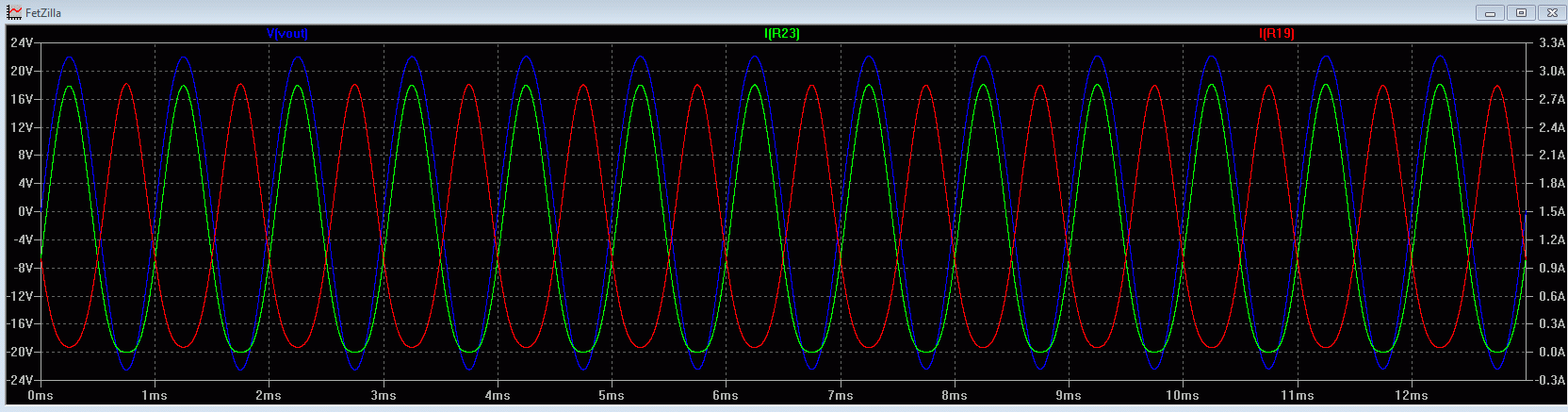

Would it be possible to run the FetZilla into about 10 watts in Class A under 4 Ohms or more and the rest in Class B?
If yes, what would be the adjustments to make and can we still keep the same supply voltage?
I'd love to try high Bias on this amp since I have quite a large heatsink attached to it.

Hi Otto,
Yes you can put in a jumper on one of the diodes on the bias string - one would reduce the quiescent from 1A to 770mA, and a jumper across two diodes would reduce it to 560mA. In both cases, the 295R resistor beneath the diodes would be unchanged.
Supply would slightly rise, maybe from 34Vdc on each rail to 34.5V and maybe 35V. Effectively this would not much change the output power to Class A but this will change radically with the impedance of the speaker and the quiescent current.
Do,

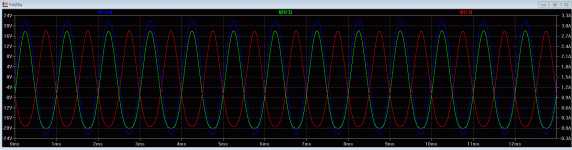

My LTSpice indicates that at 1A quiescent and 4R load, Class A departs at 11.8Vp, which is 17.5W. Beyond this, power rises to 26.3Vp into 4R, which is 86.5 watts into 4R. This looks good, but it's pushing the outputs at 6.6A peak, and it will generate quite a bit of distortion. Here are the figures at flat strap:

H2 appears to be higher than -52dB, which is VERY high.

Aksa,
you said similar a while back, maybe in this Thread.
Your definition of ClassA is different from mine.
I can't accept "not turning off" or "turning off more slowly/softly at the low Vgs end" as ClassA.
If we look at the plot you kindly took the time to compile for us, I can see the gross 2nd harmonic distortion in the waveform.
That, at least for me, shows that the nearly turning off device is not actively controlling the ClassA output current.
That sentence indicates where my definition of ClassA comes from.
Both devices in the push pull stage must actively control the ClassA output current.
And from that: if one of the devices is starting to "turn off", then it has lost the active part of the control. It's the quite precise "balance" of the upper and lower devices that gives the lack of "crossover" distortion.
In my view, if a device goes into a current passing (not quite turned off) phase of operation but not actively controlling the ClassA current, then it is not in push pull ClassA operation.
It's that type of operation where some designers deliberately design for "not turning off" and claim ClassA operation with AA and AAA nomenclature and others, to differentiate from true ClassA.
I suspect we will not agree on this.
If you have a counter argument, then the Members will probably want to hear, so each can decide.
Sorry that does not sound right.
If you want to take the time to present a counter argument, etc.
No problem Andrew. We agree to disagree.
Either way this is an ideology difference, with no effect on reality.
What is important is whether the FetZilla sounds better or worse with more quiescent, and indeed this is a subjective assessment.
I concede that as current through an active reduces, it loses control over the signal, as shown by increasing H2 on the source emitters, but then, the active device is dominating procedure anyway. The H2 created at the output signal is very small; all you see is the current through the source resistors.
Nonetheless, any difference between Class A at 16 watts or 29 watts is probably immaterial for the FetZilla, since the first two or three watts are definitely the clincher on the sound quality.
