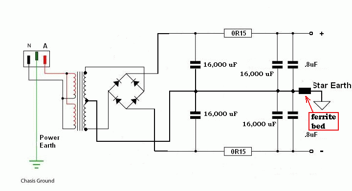

Hello Hugh
To cut hf noises coming from the power supply ground tap, how about a ferrite bed between the power supply cap center tap to the star hearth connection (like in my image) ?
Bye
Gaetan

Gaetan,
that would likely work well, however, the FetZilla supply has two full wave bridge rectifiers to each module, one for positive rail supplied from one secondary, and the other for the negative rail supplied from the other secondary. The two secondaries are independent, and can be from one or a separate transformer.
Aside from that, your picture is spot on,
Hugh
