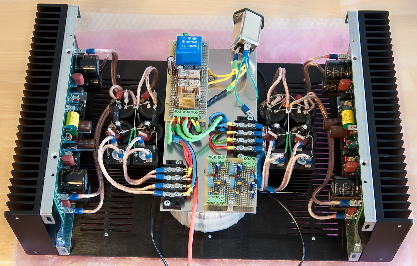

Hugh,
Thanks. I have made some temperature measurements and they are OK too. The hottest spot on the heatsink close to the MOSFET is at 41C (22C ambient) after few hours of running at 400mA. PCB itself has temperature of 34C measured on GND spade in the middle of the board. Those measurements are taken with heatsinks sitting on the bottom cover without front and back panels and without top cover.
Here is the picture of work progress so far.
George
George

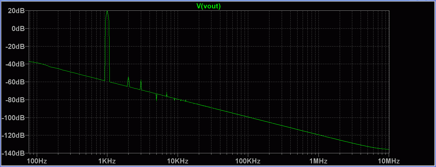

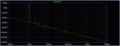

Very nice work, George, neat and tidy. I see you have your own power supplies, and these use 35A block rectifiers, which are not as good as the Philips BYV32Es I specced. However, it will still sound marvellous.....
I have a distortion profile, simulated, at 1KHz sine into 8R. It is instructive, because although the THD is 0.024%, quite high in my experience, it's mostly second and third harmonic. 7th is highish, -91dB, but 5th, a bothersome artefact, is -102dB. These are very good results and account, in my view, for the very engaging, natural sound.
