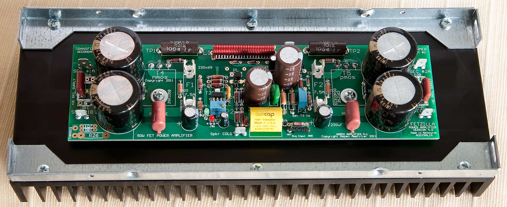

PS I'm building the first FetZilla here, nearly done, here's the picture! HD

Where are you looking? These are standard 1/4" x !" PCB fuseclips and fuses AKA type 3AG. Mouser # 504-1A1120-10 is close, but a better type clip has an end stopper to avoid misalignment. i.e. their illustration G rather than R as listed. These are so-oo common and been around longer than most of us.
'Guess I should say source will be Taiwan, China etc. and sizes may be more suitable from them.

I will go back and recheck, I hope you are correct and I missed something. My recollection from yesterday's search is as follows: I found Cooper-Bussman, Keystone, and Littelfuse brand fuseholder clips at Mouser. I follow the links to those manufacturer websites and download the pdfs containing their full line of fuse holders. Then I go through the catalogs reviewing the dimensions. All three manufacturers had clips but the post dimensions were .060" to .064", and their recommended pcb drill size is about .078". I checked the Fetzilla holes with pin gages, they are plated to about .050" to .052".
If I find an exact fit I will post the part number here.

I have used this fuseholder but had to modify it by cutting one leg and trim another (hole on the board is too small) fit on the board. You can see it on the picture of my board posted today.

Yes George, that is what I will do if I don't find a drop-in part. However, the fuse rating is dependent on the contact area, so I don't want to grind/cut the pins down too much.
apparently this forum disables the Edit feature after 30 minutes. I wanted to change the .078" typo in my post #445 to .068" and did not catch it quickly.
No drop-in part found by me, so I will be grinding. Bussman and Keystone both make clips which can be bent and cut to fit. The Keystone 3513 is similar to the Bussman 1A4533, these have pin spacing close enough to the pcb hole spacing that they can be bent there, but the pins are fatter. The Bussman 1A5602 has good pin spacing and .047" pins, but its a 5mm fuse holder, limit is 7A maximum.

Scoop. you are right, of course, that the large US suppliers to Mouser all standardise on !,5mm or larger pins. Asian stuff can be either size, so don't stick to Mouser - your local city parts supplier may have other options. Incidentally, Littlefuse for one, do make a low profile clip with 1 mm pins - #100-058 - apparently not stocked by Mouser.

hi Ian, I did look at that one, but where the board fuseholder pins are going north/south, the Littelfuse 100-058 has pins going east/west. Hope you didn't order any of those.

The conundrum is that in Oz I get my fuse clips from a local supplier who imports from China, and it now appears he's changed his stock. The new clip does not fit my board; only the old version with the finer legs fits the pcb perfectly. This is infuriating for me too, so there needs to be a better choice of fuseclip for all. It occurs to me the integrated clip for 20mm fuse (3AG?) with plastic cover might be best.

Re: fuse holders, I would just recommend a mouser standard clip and not one of those fancy plastic things. Seems the only miss was the pin size. I'll either file down the ones I have or, heaven forbid hog out the hole and solder it in from the top. (I'm used to making my own double sided boards and see plated through holes as a luxury item - I have drill press and will use it at the slightest provication)
