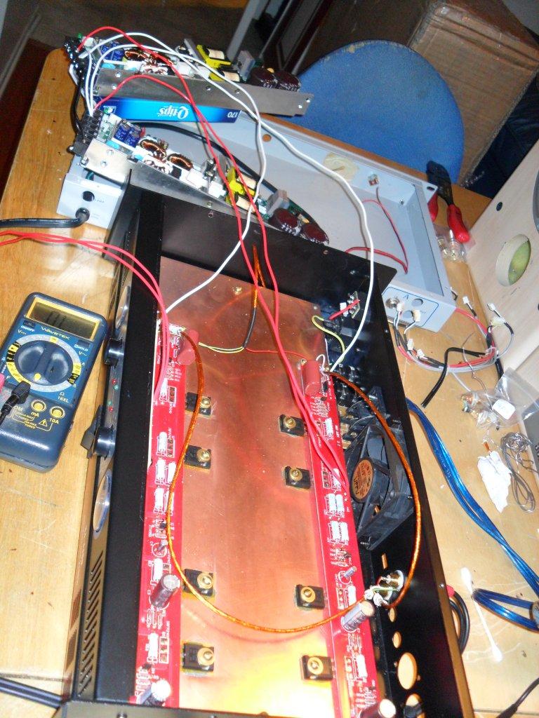

Ok, those look decent, but we need to be able to read the printing on the board.
Where is the output?
Do you have a link to the PCB anywhere?

no it do not look okei.

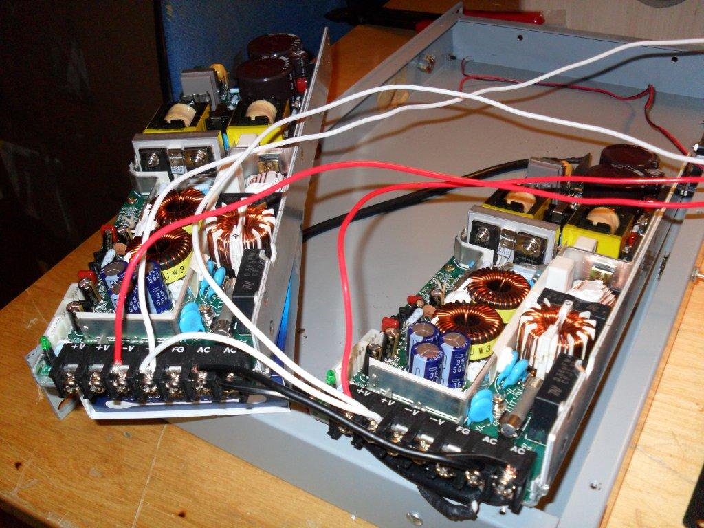

you have only +24V.
when i measure from chassis ground to +24 -24 points on pcb I get both.
connect pluss from left PSU to plus in on amp. minus from left PSU and plus from right PSU together and to amp ground. minus from right PSU to minus in on the amp.
Yes i did this.. it is strange because both boards do the same thing?
- switching power supply.. can't get -24v?
