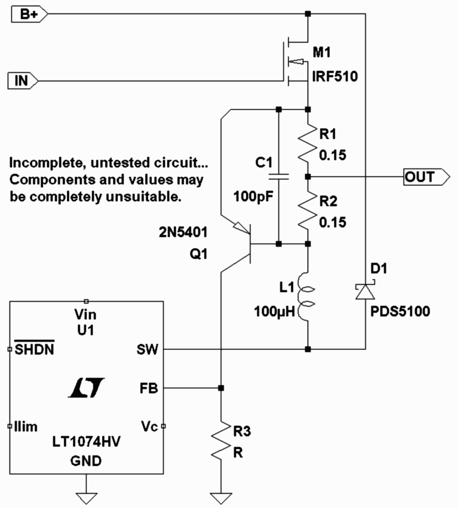

kenpeter said:Here's a very crude picture, sorta what I was thinking....
This PWM is only 100Khz, all my passives are probably dead wrong too.

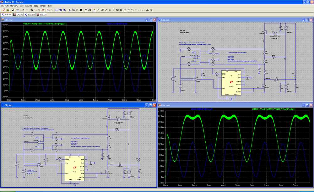

So are you going to sim it? The results would be very pertinent to the scheme were discussing. It'll be a while before I'm up to speed with LTspice - I haven't even managed to sim a simple common-source amp yet.
Just to show that I'm paying attention, the picture in post#49 shows a buck regulator IC. These have a series switch to the +ve supply which is no good here. A boost reg. with switch to ground is what we need. Unfortunately I can't get LTspice to simulate a LT1170HV in its place. Still getting to grips with the program though.kenpeter said:Here's a very crude picture, sorta what I was thinking....
I believe my disclaimer stated that any and all components
might be completely unsuitable... Glad to hear I didn't waste
my time writing that bit.
Of course, you could maybe use buck to drive an external
MOSFET??? But with the right regulator, no external switch
should be necessary...
I wonder if there is any value in a synchronous rectifier in
parallel with the Schottky? So many watts burned in class
A side already, hardly a drop in the bucket...
Anyways, I just grabbed that power supply regulator as a
convenient black box to simplify my explanation of emitter
comparator Anti-Triode. I figured you probably already had
a superior discrete PWM built, as you quote 500KHz. Didn't
feel any need for that section needed to be re-engineered
by me, certainly not just to show how a simple SEPP bridge
might be implemented...
Now for somebody else, not wanting to PWM from scratch...
TPA2005D1 driving an external mosfet might be suitable???
Might even be able to make use of the differential inputs?
At least the switching framerates are up around 250KHz...
Its hard to find an Audio PWM these days that isn't over
cluttered with "features" that only seem to get in the way.
Especially when you want to do something non-standard
with it, like drive the other half Class A... I think there is
an MSOP8, which has pins and don't need fancy solderin.
I don't know the availability of a SPICE model for that one?
Check TINA-TI to see if maybe its in the default library???
TINA-TI is free like LTSpice, only its TI... I think you have
to use at least one TI part in the schematic somewhere...
http://focus.ti.com/docs/toolsw/folders/print/tina-ti.html
And the specsheet for the PWM mentioned above.
http://focus.ti.com/docs/prod/folders/print/tpa2005d1.html

I now have a working simulation (kind of) in LTspice. Files are attached so anyone should be able to play around.
BTW The Transient Analysis phase appears to go on forever, so I always take up the invitation to hit ESC after it gets to around 0.5 I have no idea what this is all about - but it carries on and simulates the model anyway.
As for abusing the sense resistor as per Ken's suggestion - I still haven't figured out what it really does for us. I have attached a screen-shot of the sim with the load in both positions so anyone can take a quick look at what goes on. The power dissipated in the follower goes way up with the load tied to the center. It doesn't appear to make much difference to the VI product in the load though (actually it makes it slightly asymetric).
