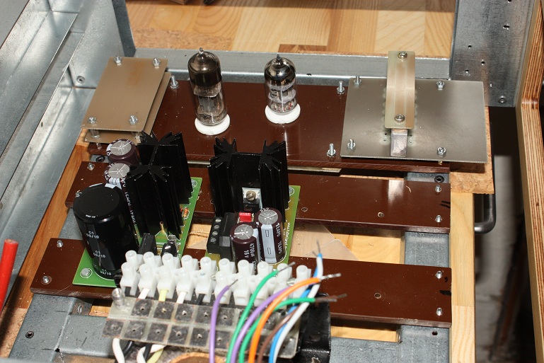

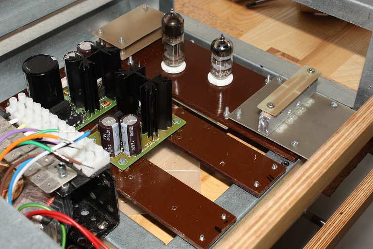

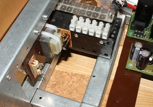

rearranged the inside
tube board and solid state board shifted place
matches the new curcuit layout with BA3 at input instead of output
and thought I would like to see how it looks with tubes :cool:
Hi tinitus, you will want to do a ''true bypass'' where the section is switched out completely. I posted a link for the basic wiring. To avoid any ''thump'' sound when you switch over, a 1 meg ohm is sometimes added from signal line to ground on the input to that switched section. The Led occupies 1 section of the triple pole, usually switch to ground and complete the circuit. A cool option is to use a dual LED, like yellow/red and switch in either one depending on which ''channel'' or bypass selected.

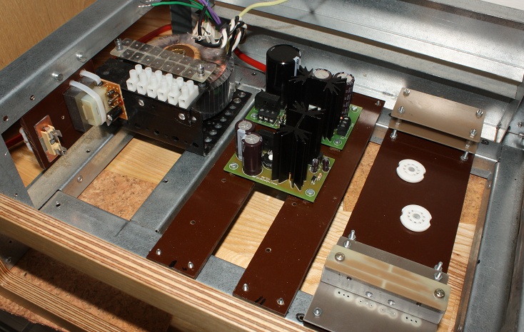

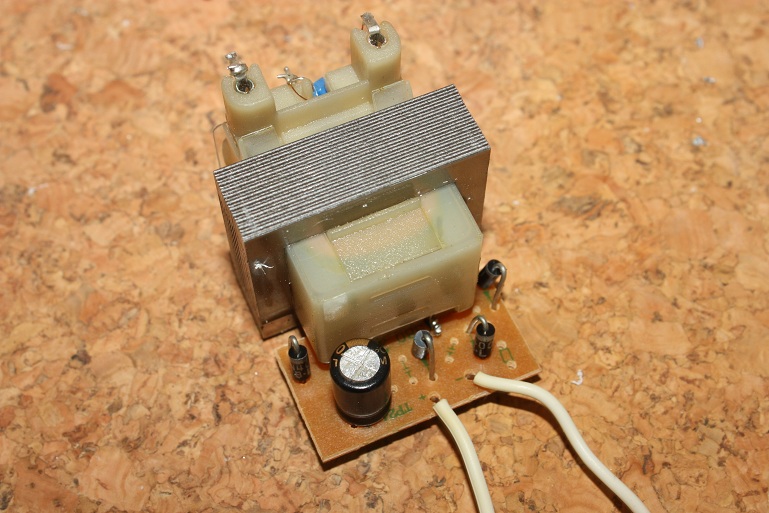

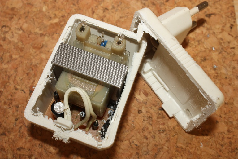

small trafo for the LEDs have now found a new home :)
and btw, it will have its own mains fuse, so that it dont take out the whole amp in case of errors
which is also part of my point with having both solid state and tube curcuit
should a tube fail, or in need of being replaced, it will still be a fuctional preamp
still need parts for the regulated +/-20V :scratch2:

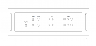

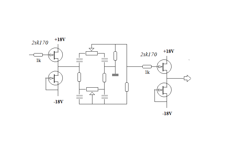

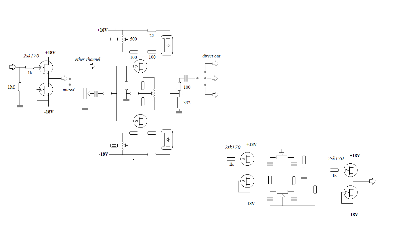

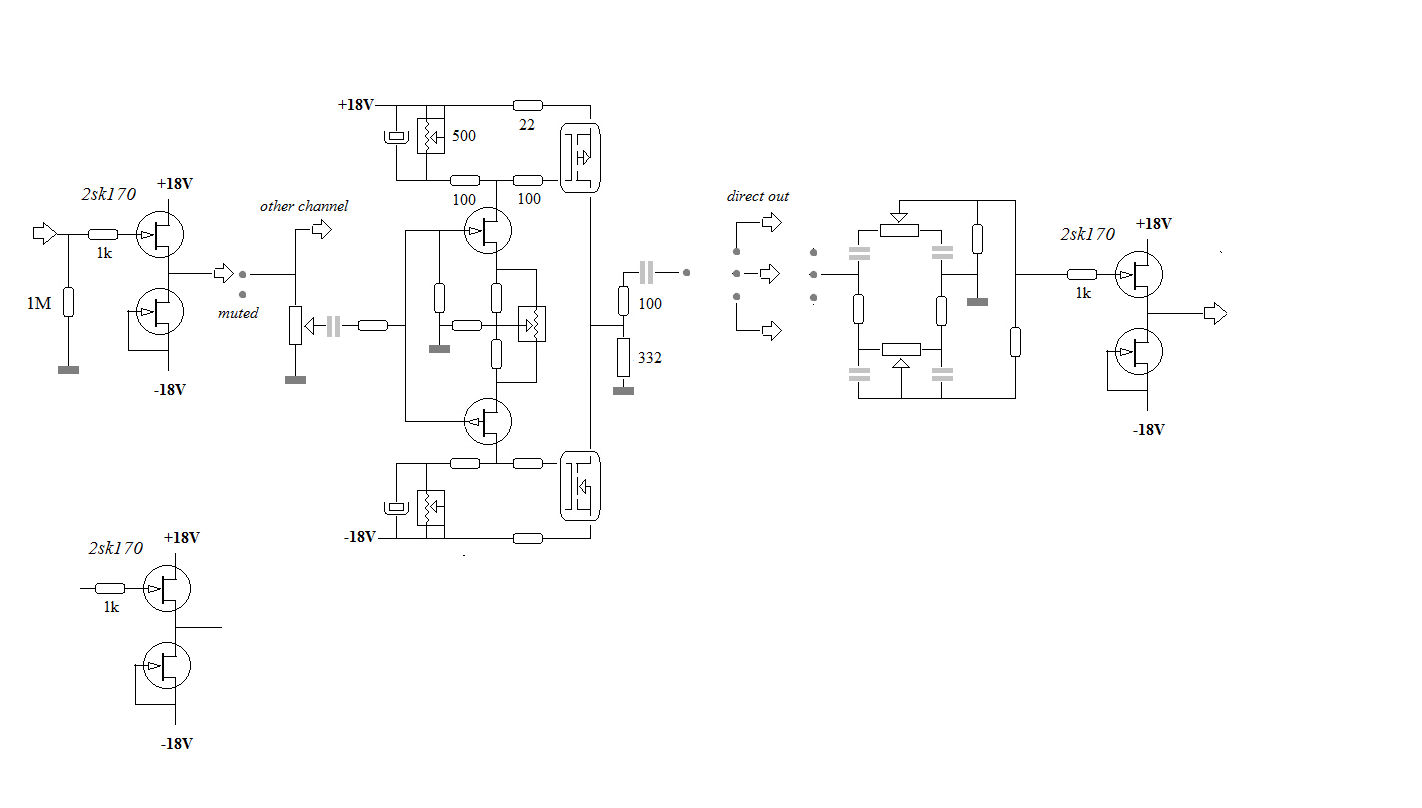

trying to rethink my curcuit/function layout
first, the tone control
I suppose it would optimally have a buffer on both input and output
despite the fact thats it means adding further curcuits
and that its best not to place any att in between
buffers will be placed together with the control knobs
all mounted on a small bord behind the front plate

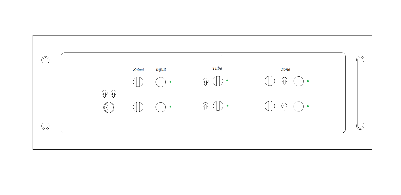

Ex-Moderator R.I.P.
Joined 2005

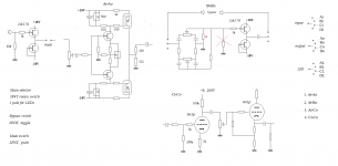

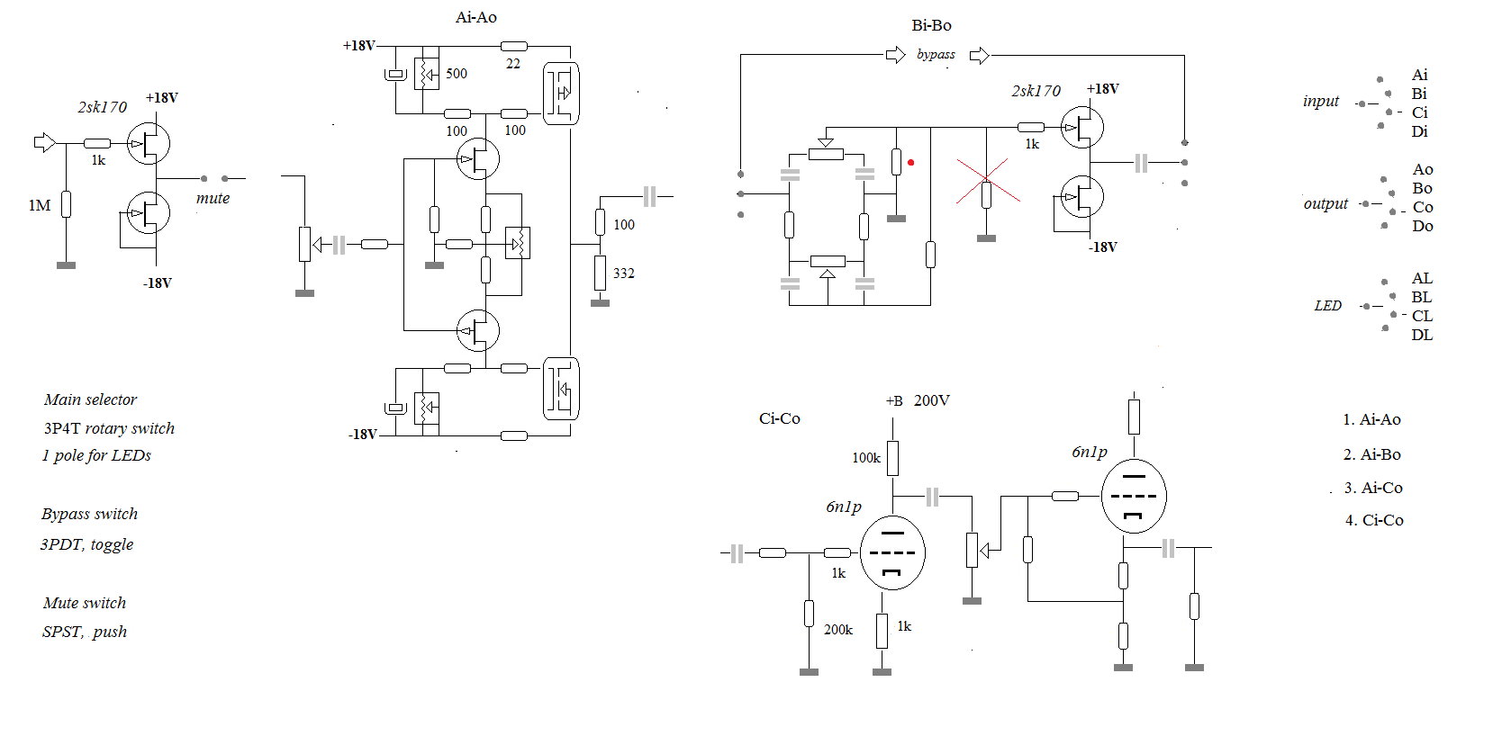

3P4T rotary switch
could be I have solved it now
pos 1 is first gain stage direct to output
pos 2 involves the tone control (toggle bypass for fast tone defeat)
pos 3 involves tube stage output
pos 4 input direct to tube stage output
Ex-Moderator R.I.P.
Joined 2005

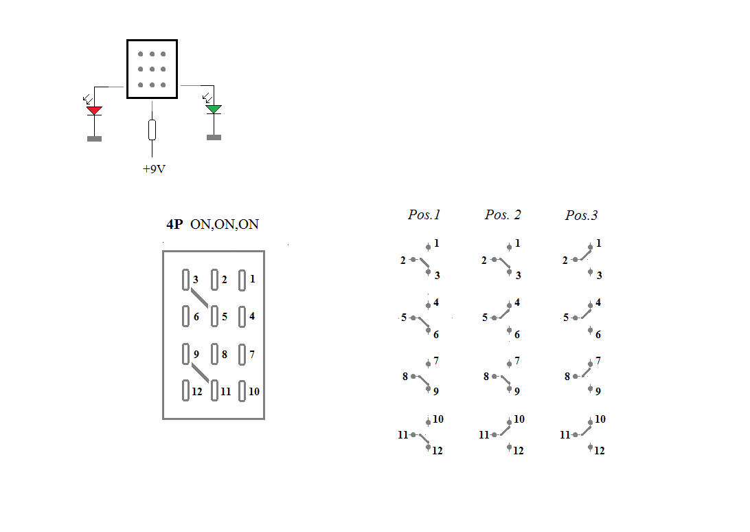

man, thats a tricky one
its a 4P ON/ON/ON
but with jumpers made a DP3T
read that jumpers are external and may be cut to make it 4PDT
I do need at least 3P because of the LEDs
but maybe the last 4th pole could work with leaving one of the jumpers
which would make it a mixed 4PDT/3P3T hybrid, or whatever :warped: aint switches just a lot of fun :eek::D

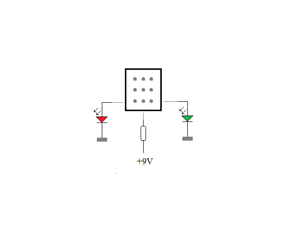

Ex-Moderator R.I.P.
Joined 2005
and the 4P switching with both jumpers cut
it gives 3 options
and able to 'create' complicated connections
or in other words, it can do signal in/out switching and bypass at the same time :cool:
and still have a free pole for LEDs
now I only need to figure out what is the reality :D
