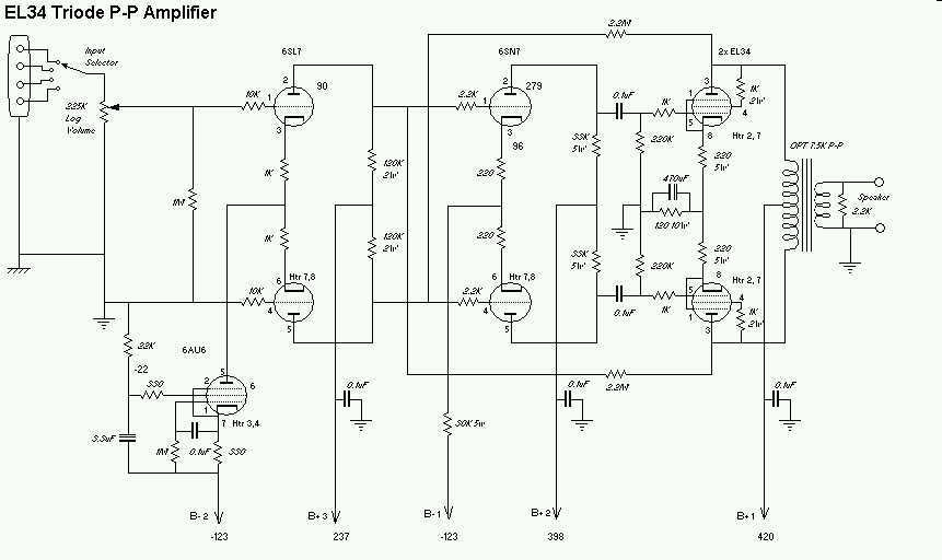

Well, there is certainly nothing wrong with pentode mode, just needs some form of local or global Fdbk to lower the output Z and distortion. Pentodes are capable of lower distortion than triode mode in most cases, since resistive derived feedback is more linear that the internal triode Fdbk (when a load is applied certainly).
Applying local feedback of some form is quite useful for cheaper OTs, since it can improve their performance. For the high quality OTs, global Fdbk alone can work quite well. Some of the best known amplifiers used both local and global feedback, like Citation II or McIntosh etc.
For local Fdbk, many choices: CFB, Schade, plate to driver grids, plate to driver cathodes, even plate to driver screens (special driver Vg2/Vp conditions). Combinations have been used as well.
Schade or Fdbk to driver grids or cathodes are the easiest. Fdbk to driver grids or cathdodes will give the lowest distortion, but may be clinical sounding if over-done.

Here is a Schade (Fdbk back to the driver cathodes) +CFB schematic, the ARC D51
I would just consider it an idea model, from the driver to the outputs. The input stage is hideous. The CFB using the secondary is probably more marketing than useful, since the plate feedbacks may have more gain and will over-ride the CFB.
On second inspection, looks like they made the plate feedback resistors so high in value that the Schade and secondary CFB loop gains may be comparable.

A Thorsten Loesch type "local" feedback design by Ray Moth (I haven't found the original Thorsten L link yet) I think it needs some DC isolation caps on the 6SN7 grids yet.
"Local" Fdbk in these contexts meaning: not including the OT in the loop. "Partial" Fdbk might be a better description for these. (more traditional Local Fdbk means just a single gain stage in the loop. )
http://www.diyaudio.com/forums/tube...al-fb-decent-damping-factor-5.html#post517524
One could also take the Fdbks from the UL taps in this type of design.
A few comments needed yet about the Ray Moth/ Thorsten L design above.
Thorsten made some comments on the advantages here:
http://www.diyaudio.com/forums/tube...al-fb-decent-damping-factor-5.html#post525580
But some disadvantages should also be mentioned.
The Fdbks to the driver grids lower the impedance at the driver grids, making for loading on the 1st input stage (or the splitter). One usually likes to be able to use a CCS load on the input stage. I guess a Concertina splitter would not be bothered by the low Z load, since it acts like a buffer anyway.
The driver stage needs to be a real differential stage (CCS tail) due to the crossed Fdbks, if the output stage is running in class AB. Reason being that when one output tube cuts off, the other active output tube's N Fdbk is crossed over to the dead P-P side. So no correction will occur in the actual active output (except for phase lagged signal THROUGH the OT from P to P), unless the driver is differential, to spread the correction to both P-P sides.
Ie, a class B output (moment) without a differential driver would periodically cut the direct feedback off. The momentarily un-driven side of the P-P primary does however still act like an unloaded CFB winding with good coupling to the output. So the N Fdbk is dynamically varying the amount of resistive winding loss (from load current) injected into the correction process. A more consistent N Fdbk could be obtained using the earlier mentioned scheme of 40% CFB using crossed UL taps for the cathodes, since each tube would always be driving BOTH UL winding sides. (assuming the N Fdbk tapped from the UL taps then.) This issue applies to any of the schemes using plate or UL feedbacks.
But then, once you have a differential driver stage, one doesn't really need a splitter anymore. So back to the loading issue on the input stage then.
So every scheme has its plus's and minus's.

Corrections.......................
A closer inspection of the winding loss effects in the P-P plate or UL partial feedbacks makes it clear that the class A opposing (cancelling portion) current/winding effects cancel out (with a differential driver), so that one is left with one Fdbk having the expected tube drive current*winding Ohm effect, and the other Fdbk effectively not. (so only the active net drive current * Ohms shows up steadily) So then the average of active and in-active tube Fdbks is taken by a differential driver stage. No strange modulation of winding loss is taking place after all. That should be OK. One does still want a differential driver stage to get that consistancy.
So the partial (or "local") Fdbks to a (differential) driver stage looks like a good design, just low impedance inputs to deal with for the Fdbks to the driver grids case. Easy to do like the other partial feedback schemes.
Also, on the Citation II, with two "local" or partial feedbacks back to the same driver grids, I may be wrong about not being able to satisfy both demands. Just think of the two feedbacks as summed linearly. One then gets a linear summation of corrections for both error terms. Each offending (distorting) device in the forward path gets its correction allotment in sequence, with the remaining correction term passed on to the next offending distorter. So I'm adding the Citation II configuration to the list of well understodd partial feedback schemes.
The RCA 50 Watter one is still a mystery to me as to why they stuck the short path Schade Fdbk into the larger driver cathode Fdbk loop (reducing the outer loop gain quite a bit). Have to think about that one some more. If the gain reduction in the larger cathode loop were the same as the smaller Schade loop gain added, then it would be a no effect trade-off. But the plate resistor loading is burning some unused gain. Maybe that can be fixed up for the RCA design.
