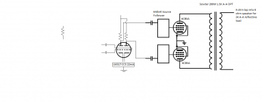

Another thought on the partial feedback to the driver grids approach. This approach is the easiest to design (just set the forward gain in the attenuator ratio like for Schade), so it would be nice to eliminate the issue of crossed feedbacks with a class aB output stage.
By using a small CFB winding, the partial feedbacks can be taken from the cathodes rather than the plates (or UL taps). This inverts the phases, so no feedback crossover (for phase) is required. Then the driver stage does not necessarily need to be differential. An R tail should be fine. A simple approach would be to just use the secondary 0,4,16 Ohm taps for P-P CFB, but this introduces questions of turns matching in the secondary, and makes most of the Fdbk signal (like 90%) have to cross primary to secondary (a stability issue maybe).
The Crowhurst Twin like arrangement or similar (below) would work perfectly for CFB derived partial Fdbk taps.
Another reason I like the Crowhurst Twin like arrangements is that each OT used in it can be thought of as one bobbin section of a split bobbin balanced OT. By flipping around the phase of one OT ( phase flip both primary and secondary leads), one cancels out any inherent P-P winding assymetry in a cheap OT. (the cap OT to OT couplings cross link opposite dis-symmetry sides to balance it out, for leakage L and winding resistance of the P-P sides) So one has a simple way of making the equivalent of a very expensive OT, using two low primary Z Edcors for example. Not to mention the doubling of possible output power. A 200 Watt, high quality, off the shelf OT is no sweat at all. And its still much cheaper ($100+100 versus $335 1650WA at Mouser) than Hammond's 280 Watter.
