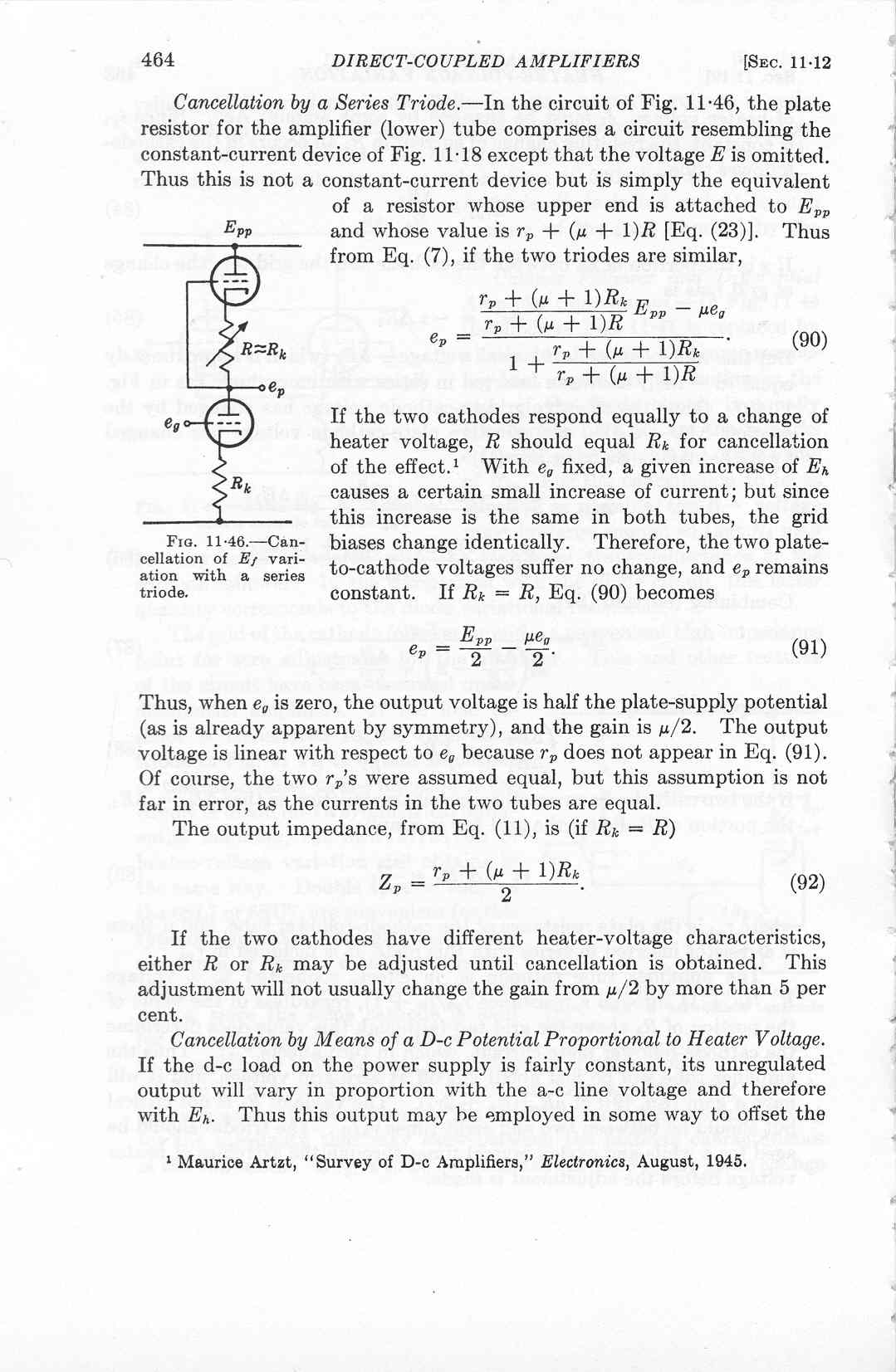

The first place I recall seeing the theory is from the 1940’s in the MIT Radiation series #18 “Vacuum Tube Amplifiers”. See the attached photo of page #464. They go through a lot of math and show rp is equal in both the top and bottom triode. This is true for idle conditions.
This is me scratching my head; as a signal is applied to the bottom triode control grid the voltage on the top triode grid is going the other direction. As we slide up and down the plate curves of the pair of triodes the instantaneous rp’s of the triodes are moving in opposite directions and not canceling out as is assumed and shown in equation (91) on page 464.

For an ideal triode (3/2 law, constant mu) rp (ra to us Brits) is a function of current only. In that case the half-mu stage with an infinite impedance load should give distortion cancellation, as the two triodes will have the same current so same rp. To the extent that real triodes depart from the ideal law they will have degraded distortion cancellation. Whether a CCS stage or a half-mu stage will win depends on exactly how mu varies, as both give perfect results for an ideal triode.
Many real triodes can be biased so mu is almost independent of current, over a limited range. What we actually want is mu almost independent of anode voltage. I don't know if any datasheet gives the curves for that.
I guess the book assumes ideal triodes.

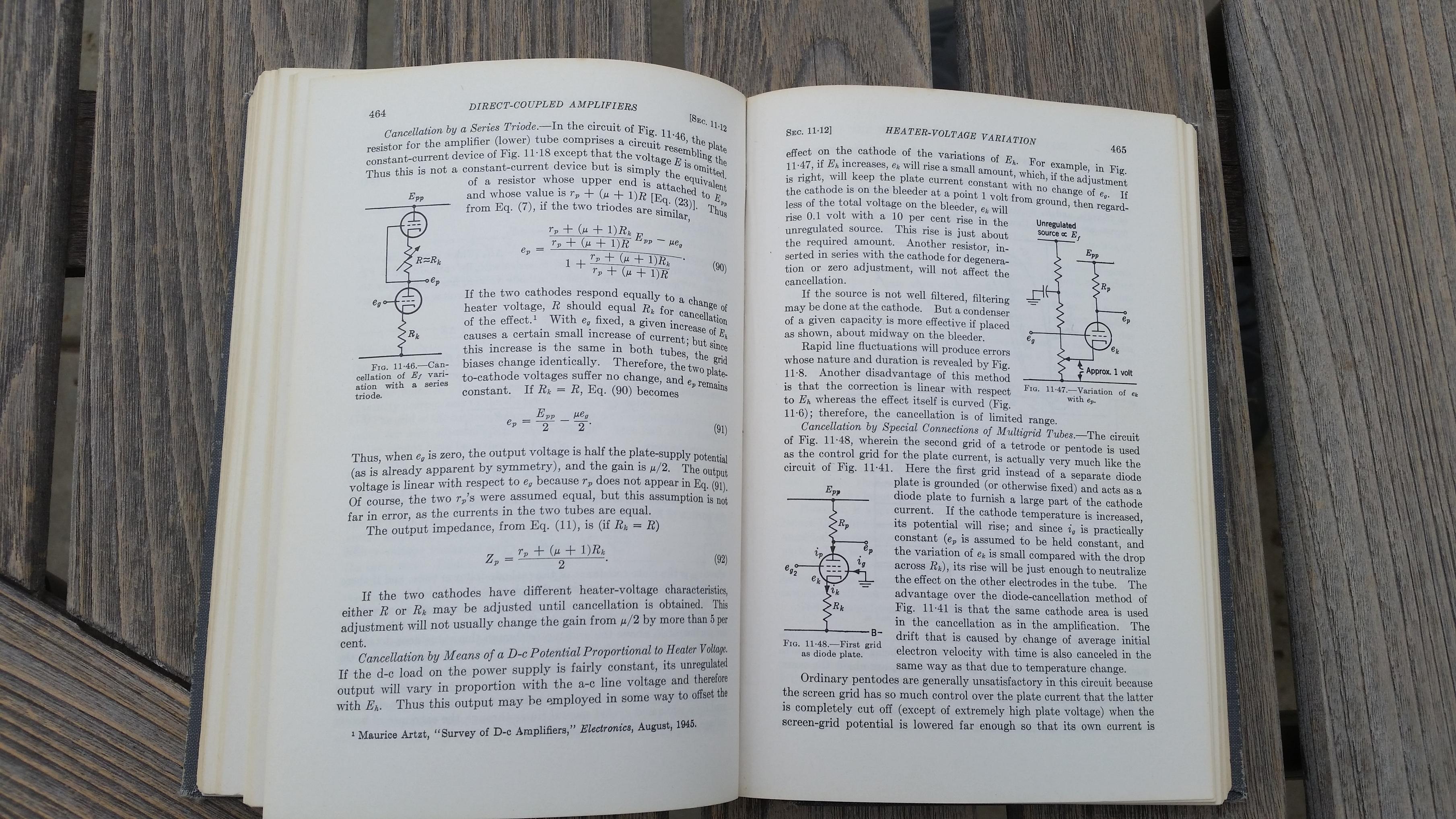

Here is a closer scan of the MIT book, page 464.
(these reprint books are falling apart now)

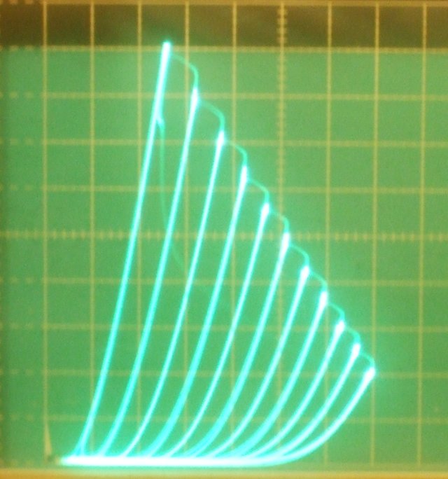

Then a typical triode curve set pic.
Every triode curve set I've seen has a roll-over effect at high plate voltage. (so higher Rp at higher Vp) Just a matter of how much between different tubes. Likely a grid "island effect", from grid wire proximity to the cathode. The Aikodo stage is probably popular because it preserves some 2nd Harmonic distortion from the plate voltage effects.
One can get an anti island effect by using grid 2 for input in an aligned grid tube. (grid 1 connected to cathode)
But then the "triode" Rp is way too high.

True, the current changes in the Aikido circuit versus signal. But the theory (for 3/2 power law) says the top and bottom Rp vary the same way with current, so that should null out. So all should be well. (does a simulation with 3/2 law tube models show constant gain?)
The variation of Rp with plate voltage (at constant current even) is definitely an issue though.

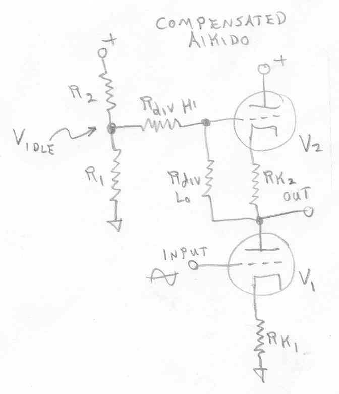

Another idea:
With the simple Aikido stage, put a high value resistor from the top grid to some fixed (idle) voltage. And a low value resistor from the top grid to the top tube cathode (as usual). That resistor could be adjusted so as to compensate the top tube for the varying Rp with voltage. (as the center point of the Aikido gets pulled down, the top tube would draw a little extra current)
Ran out of time for editing on the last idea. Should be:
Another idea:
With the simple Aikido stage, put a high value resistor from the top grid to some fixed (idle) voltage. And a low value resistor from the top grid to the bottom tube plate (as usual). The high value resistor could be adjusted so as to compensate the top tube for the varying Rp with voltage. (as the center point of the Aikido gets pulled down, the top tube would draw a little extra current)

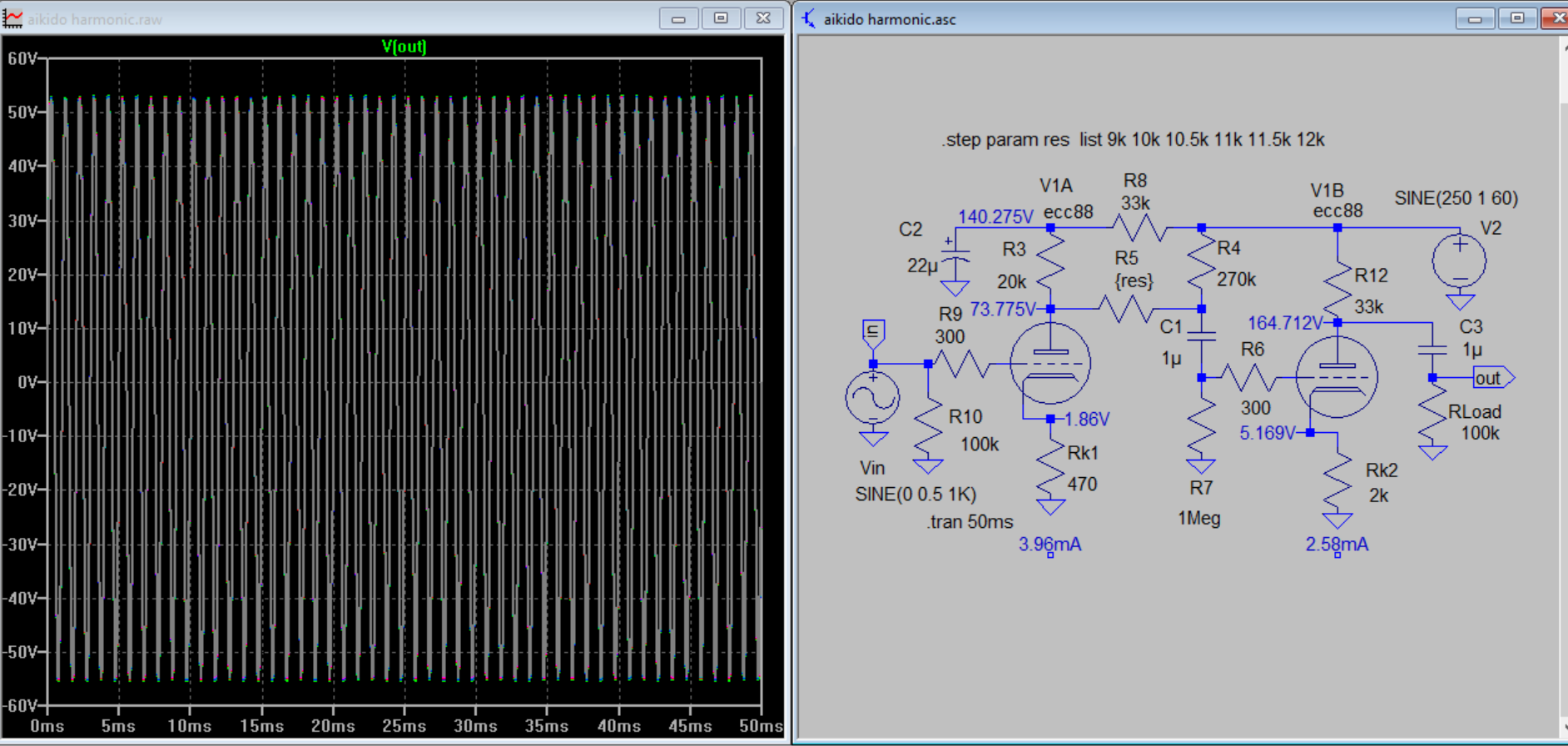

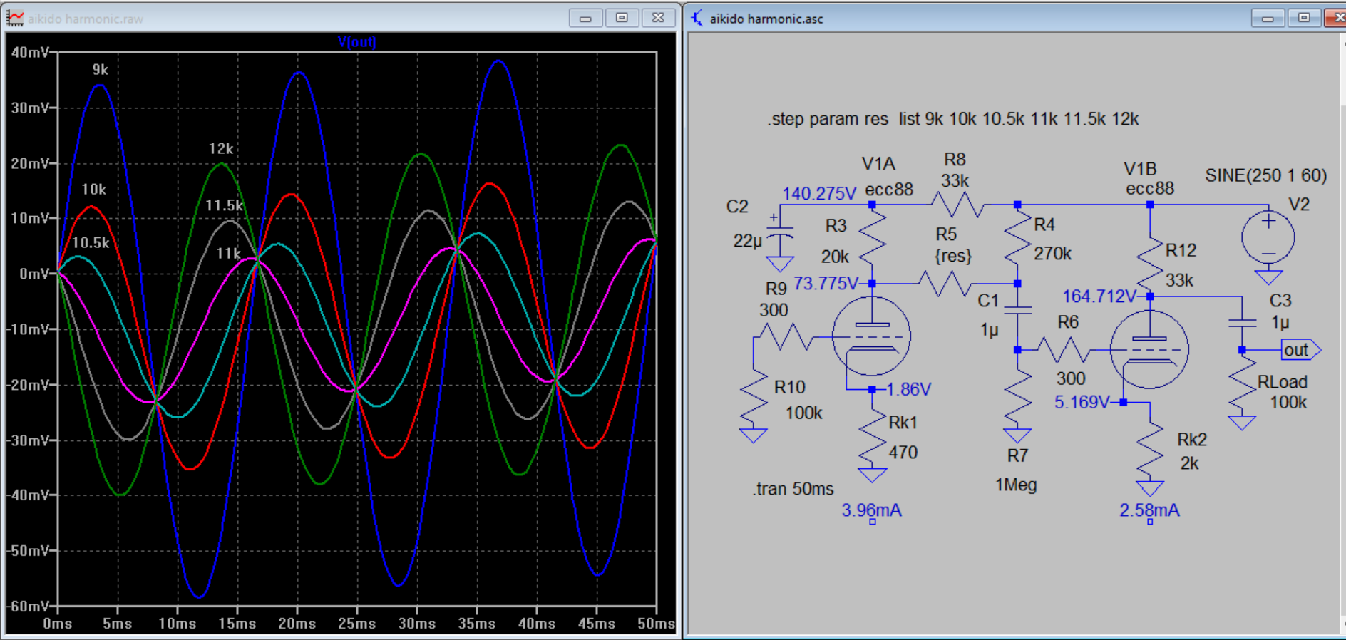

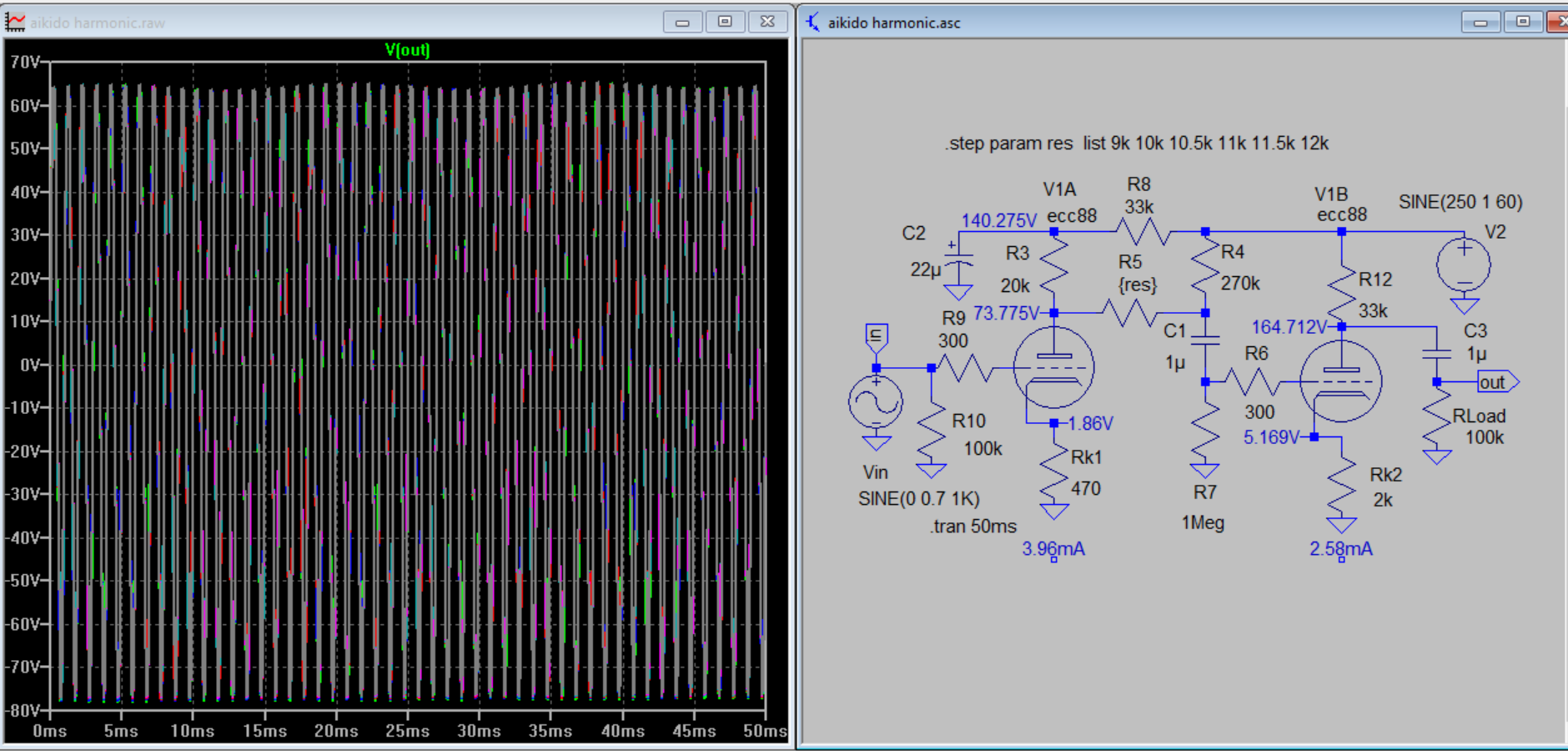

Here is a simulation based on JB article A New Look at Harmonic Restoration
The supply is modulated with 1V 60hz to simulate the hum.There are some phase shift just before and after null occurred. Do you see the 60hz hum still on top? That is because the top has entered clipping, more clipping more hums.
