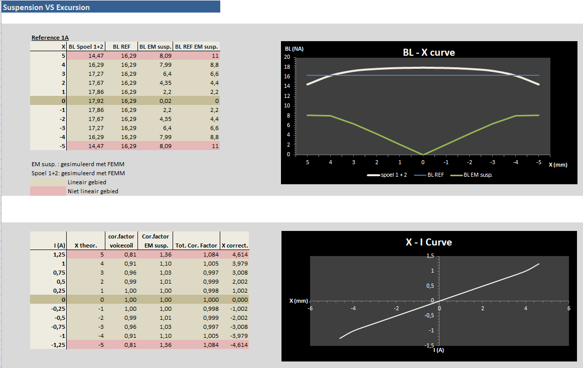

1) I thought about cone termination that's why I try first with surround and then without to hear the difference. rocking modes or not the sound is much better and defined without, and yes also on high volumes. If the cone is light and stiff with good damping over the whole surface (thin rubber layer) the rocking modes or not that much. I think also because of the very stif outerdiameter of the cone with the alu ring (thin but high)
=> there are artikels to depend on and there are real world testing results... you must consider both to judge.
2) The driver works vertical no problem. I love to discuss some aspects thats the whole reason that i place this threat but the "clueless enthusiasts like you say" do believe me. Lying is not the purpose... and has also no contribution for me and others.
3) Why ferro don't work? Works like a charm. High BL value, high viscosity ferro applied only on the inside of the former (perfectly smooth) the outside is not good because of the ripples from the coil. You have also to be sure there is no pressure change in the magnetic structure => the ferro will stay in the gap. I have also a video were you can see how the speaker is driven to it's limits.
4) the issues of interaction of magnetic and suspension
linearity have been well covered previously => Do you have andy prove or example? Yes maybe there is but at the expense of other problems.
you can see the suspension compensation in the picture.
green line => suspension force. yellow line => voicecoil force.
X-I curve is full lineair till +/-4mm.
I want to see if someone can make this with a spider? No, impossible.

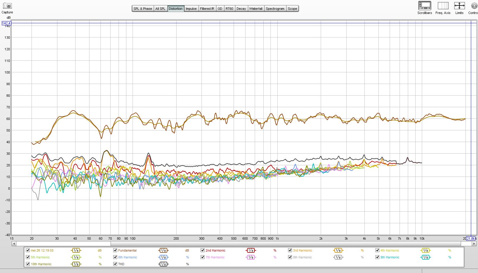

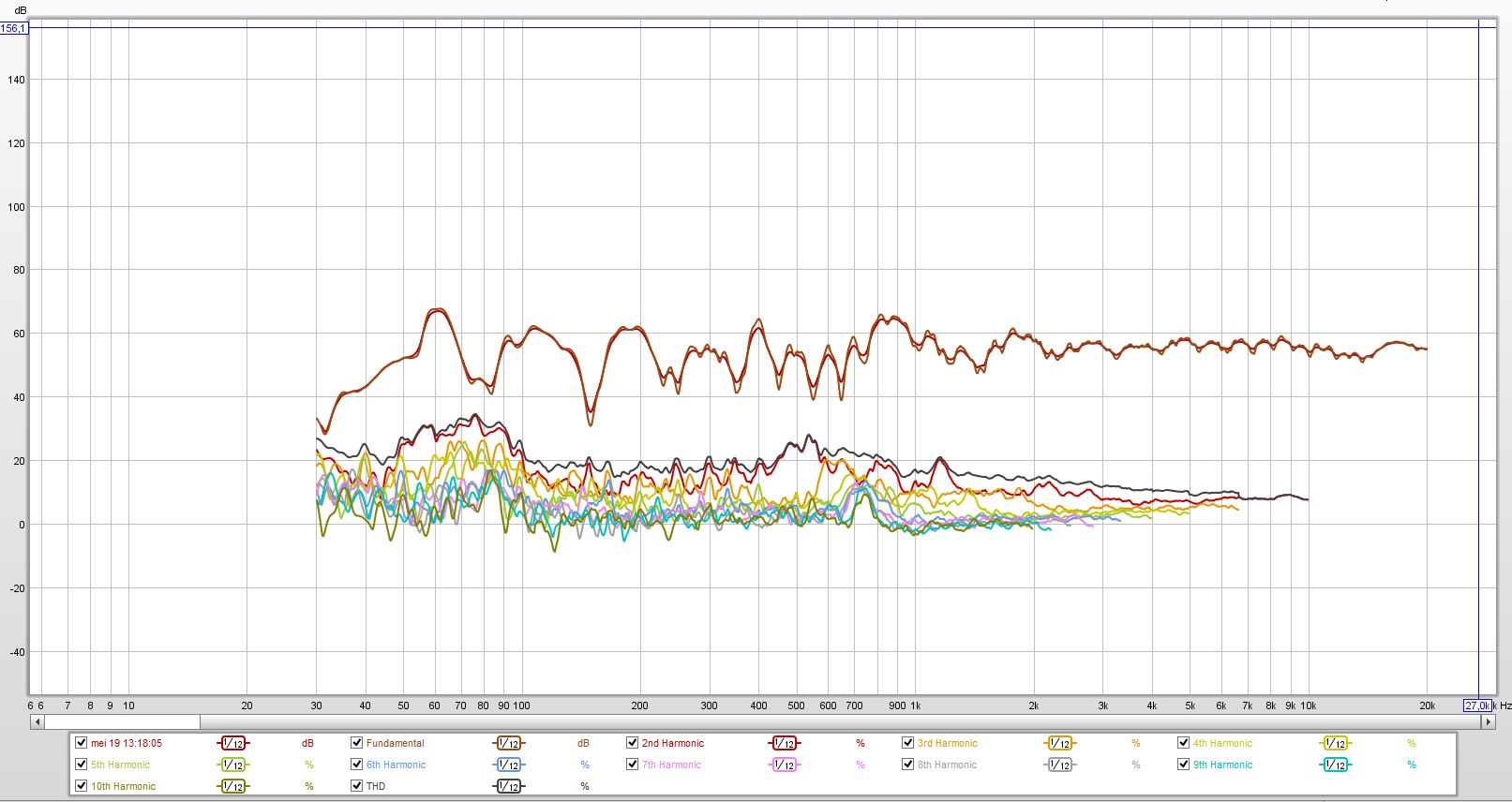

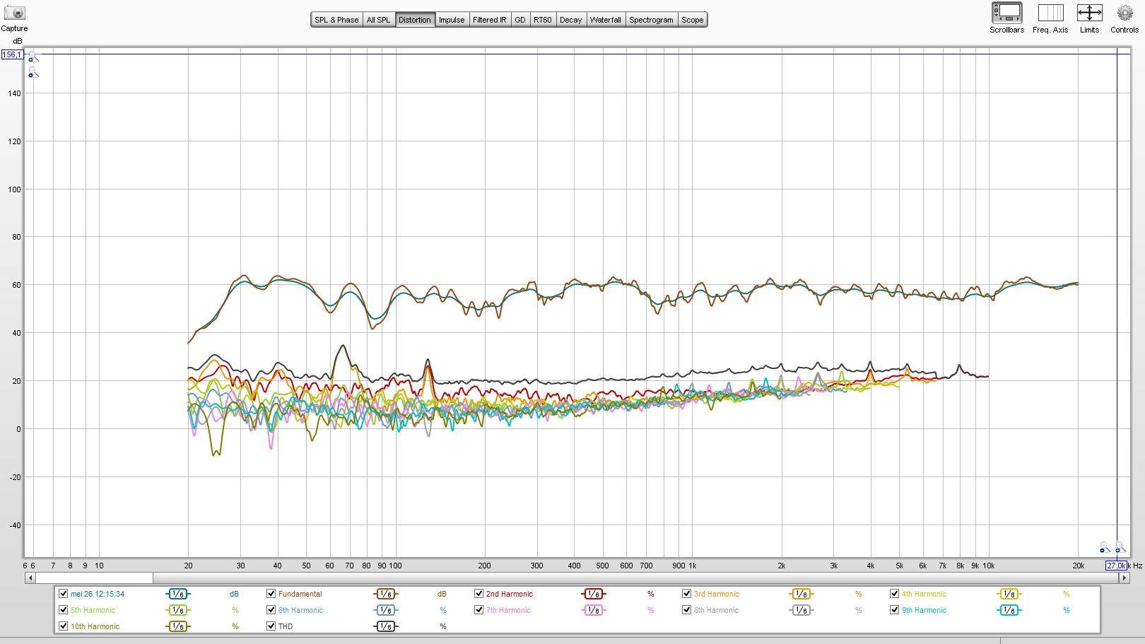

I don't suppose we can get some FR and distortion measurements of this thing? It looks interesting.
Yes you will, but for the moment I only have these data when it is placed in a closed cabinet and with surround and papercone setup. But the paper cone was rubbish too thin. I just decided to make two whole new drivers like the last one. no surround and spider and kevlar dome but this will might take a while. The driver I talk about here (the one i tested last weekend) is dead so I can't do the measurement of it. The reason it is broken is my own fault. On the back there are 4 bolts to hold the bottomplate to the sidewall. I wan't to change the basket for testing but this is also bolt to these four bolts. When loosing them the polepiece just came out of center against the outer ring of the airgap. Almost impossible to disassemble without any damage.
distortion and FR but in a full setup (2way with seas tweeter) so this don't tell much. Also with the thin paper dome.
The dark brown line is the plot of my Keff-Q75 for reference. Oke this is not a top notch speaker but also not a bad one.
Rgrds,

Your scale is between 180dB and 200dB. That's way WAY to much to see anything meaningful. When I design crossover I work on a scale between 60dB and 100dB. For reference, Stereophile measurement are usually on a 50db, Zaph uses 90dB...
You can make anything look flat with a 200dB scale.
Nice project!
Chuck
I understand the concern, the measurement is a quick sweep on location with a laptop. So the measurement is not good. If the next driver is ready (I am started this week with the almost final version) good cabinet and active crossover on a higher level. Also going to make a iec baffle for FR response. But I think this will be ready end of august.
Rgrds,
