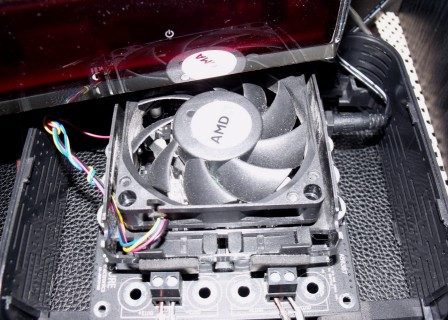

yay, i recieved the new version with the fan on yesterday, its the exact same height as the heatsink. Id be interested in knowing how much current the board uses from the LM317 regulator, it gets too hot to touch quickly just on idle. Id like to run an additional led from it...
