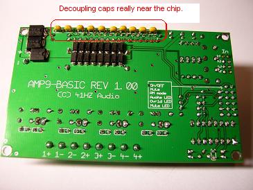

v-bro,
Do you think it would be an idea to simply solder 100nf ceramics to the chip pins on the input side and then to a ground wire? Seems to be quite a bit of room and the pins are thick. Below is a pic of the chip.
http://pix.minirig.org.au/main.php?g2_itemId=276
Hi, well not only the inputs, what would be more important is the 5V section. I don't have that amp right here, but I'm sure it uses some kind of 5V regulator. It's either on board of the IC or separate.
Most of the times it's a 78L05 or LM317 regulator when it's external...
You can just place these caps without any harm on any lead that has voltage on it. Most important is to do it real close to the IC. When it has a separate 5V regulator than place two caps, one near the regulator and one near where the 5V enters the IC.....
Use 100nF and at least 50V, the inputs can also use two 100pF ceramics to filter on a really high frequency range.....

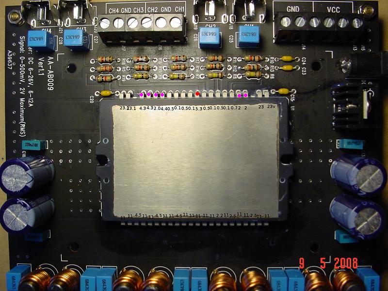

voltages on the pins with 24v going in no load
this is the volts on the pins.
http://pix.minirig.org.au/main.php?g2_itemId=279&g2_imageViewsIndex=1
there is no external 5v regulator, must be on the chip.

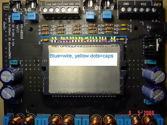

Hi, I put some coloured dot on your pic, red is a must try and purple are also pins to try a cap on, I don't think the outputs really need them.
Just first try the input side of the IC.
Than also add caps on the input pins, you can beep these pins from the blue input caps(the square ones) with your DMM. The inputs go to the blue caps...than measure between the other pin of each blue cap towards the IC pins.
Than the best would be to solder the cap directly on the IC pins and than to a near ground plane... (or add a ground wire)....
cheers for that, very helpful. Will go get some ceramics. I might do them one by one attaching them to the blue wire using your purple dots as a priority order. If I find one change that makes a dramatic reduction in hiss will report back. Even if I smoke the thing is no biggie as I have 2 amp9-basic on the way ;-)
