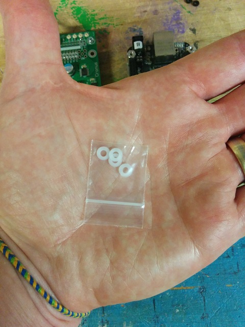

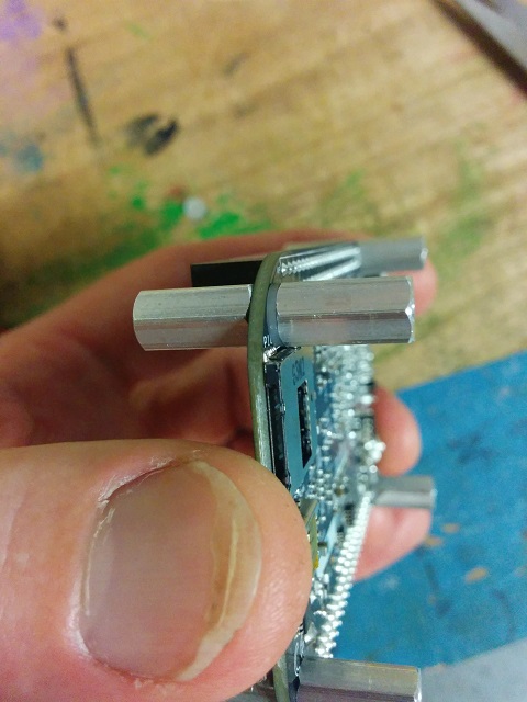

Researching the microSD card issue, I checked the solder pads under a binocular scope. I was surprised to find physical contact had been made between one uSD card reader pad and the stock TPA aluminum standoff that was usually in place on the BBB. That would ground the pad. At worst, two reader pins could even be bridged, though I'm sure that didn't occur. So be aware of the standoff type/placement on BBB!
Frank
I am now shipping a set of nylon washers with the kits.
If you already have a kit and want/need some washers, drop me a line. I will email all current users about this as well.

The BBB's substitution is really an easy task. Dismounted the 4 standoffs (with 4 plastic washers), resoldered the 4 pins for the battery and reinstalled the new BBB. No way way to make it play again... I reinstalled the old BBB but doesn't play. All the LEDs are lighting (2 fix at power on and one when complete the boot), the 5V are there but nothing out. I even tested the DAC with a Waveio and changed the 3 U.FL from Cronus to the DAC.
After some hours of troubleshooting I installed back the S03 and both the BBB are playing.
I have really no idea what may have happened in one week that the board seat in the table. I will ask some help to Russ
