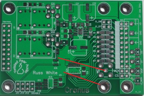

I have to reassemble BBB/Hermes/Cronus/BII
You are meaning voltage on MCLK output on Cronus?
Reconnected every thing and tried speaker test, get output of hiss only, should be different frequencies? I have the clock pin in position 1 on the hermes.
Hiss is in both channels...

Joined 2004
ichiban...
Does your clock work? Please measure DC voltage on MCLK output. It should be non zero.
I measure varying DC volts about 160mV .... at these points.......
