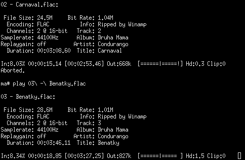

And you can also try geeky way and use terminal and exec "play" command from command line. If you don't like command line there text-mode "Norton Commander" alternative, install the "mc" and try it.

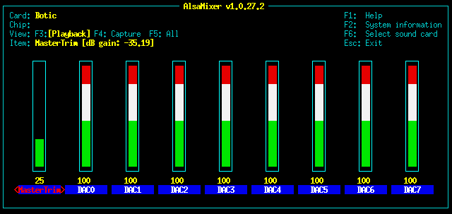

Another screenshot from terminal, the 'alsamixer' volume controller. The v5 supports only ES9018 volume controls (MasterTrim, DAC0-7). You need to have I2C to DAC and installed botic helper script: https://github.com/miero/botic-tools
At the moment it is not very responsive (shell script executing I2C commands), I'll try to improve this later.

So, I tried mpd via putty SSH and get this result
root@botic:~# play /data/remote/Track01.wav
[ 721.096851] helper=
/data/remote/Track01.wav:
File Size: 52.8M Bit Rate: 1.41M
Encoding: Signed PCM
Channels: 2 @ 16-bit
Samplerate: 44100Hz
Replaygain: off
Duration: 00:04:59.07
In:0.00% 00:00:00.00 [00:04:59.07] Out:0 [ | ] Clip:0 play WARN alsa: Input/output error
play FAIL sox: `default' Device or resource busy: Operation not permitted
Done.
root@botic:~#
