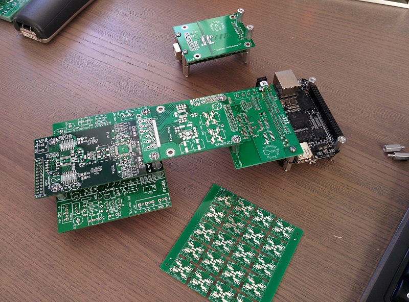

Boards are in
We will be testing extensively in the next couple weeks and hopefully releasing everything soon.
