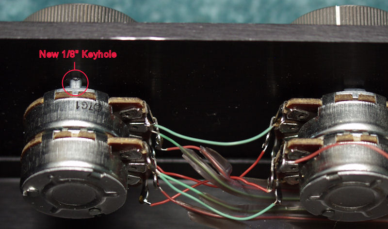

For the benefit of those replacing their Volume/Balance pots, here is a photo of my new pots installed (see Mouser part number above previous message). I had to drill a 1/8" keyhole thru the front panel in exactly the right locations (note that one is on top and the other is on bottom), in order to install the pots. The key tab on the pot are there to prevent the pot from spinning when the knob reaches the end of its travel.

Does the control you obtained for the balance have log/reverse log elements? That is, one element is log taper clockwise and the other is log counter clockwise? If not, that will most likely be the source of the channel mismatch. The original control had zero insertion loss elements when the control was at twelve o'clock. It only inserted resistance when moved to one side or the other. Just the first thought that came to mind when thinking about the problem.
beeger: Yep, I remembered (hard to do at my age) that Balance pots have to be log/reverse-log tapers, so the new one is correct. But this balance problem also occured with the old Balance pot, too, ever since the unit was new (both Line and Phono sources). I just lived with it all those years of use, as otherwise the sound from both channels is equivalently excellent. I get the opp to work on this thing in short spurts, but am planning next on double-checking the component match between Line stages to make sure they're the same values. Does the circuit contain a stage requiring a close match of xstr's?
