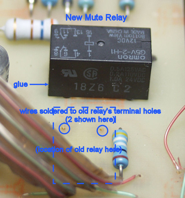

Au contraire. It would have been great if Superphone had used a "conventional" relay. This is an unusual relay. Altho its pin spacing is standard, and uses a common PCB-mount configuration of 8 pins of standard 16DIP dimension, the pin-out is non-standard. The 12VDC coil is on pins 6 & 12, instead of 1 & 16, and the commons of the relay switches are on 1 & 16.
Certainly, there are several choices of low-signal PCB relays available with similar coil current and sensitivity, but they will require re-drilling the PCB board in an open space, gluing it on, and then hand-wiring it via soldering directly to the pins and the original PCB pads in the correct locations...something I'd like to avoid if there's a drop-in replacement. Instead of grass, this one looks to be a rare orchid.

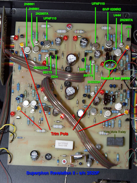

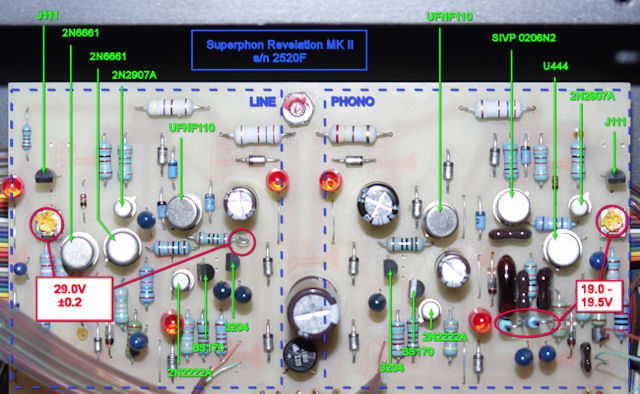

Hi, I just serviced a Revelation II with some new electrolytics for a client and I am shocked at how good it is. I was sad to see it go! I came here looking for some schematics to see if I could make my own but i guess the semiconductors are now hard to come by :(
^^ update… I am now the happy owner of a Revelation II… bought it from my client 😅
I’ve heard dozens of preamps that have come through my bench and this is the one that stood out above the rest. And i’ve recently done some really nice stuff like AR and Aragon
