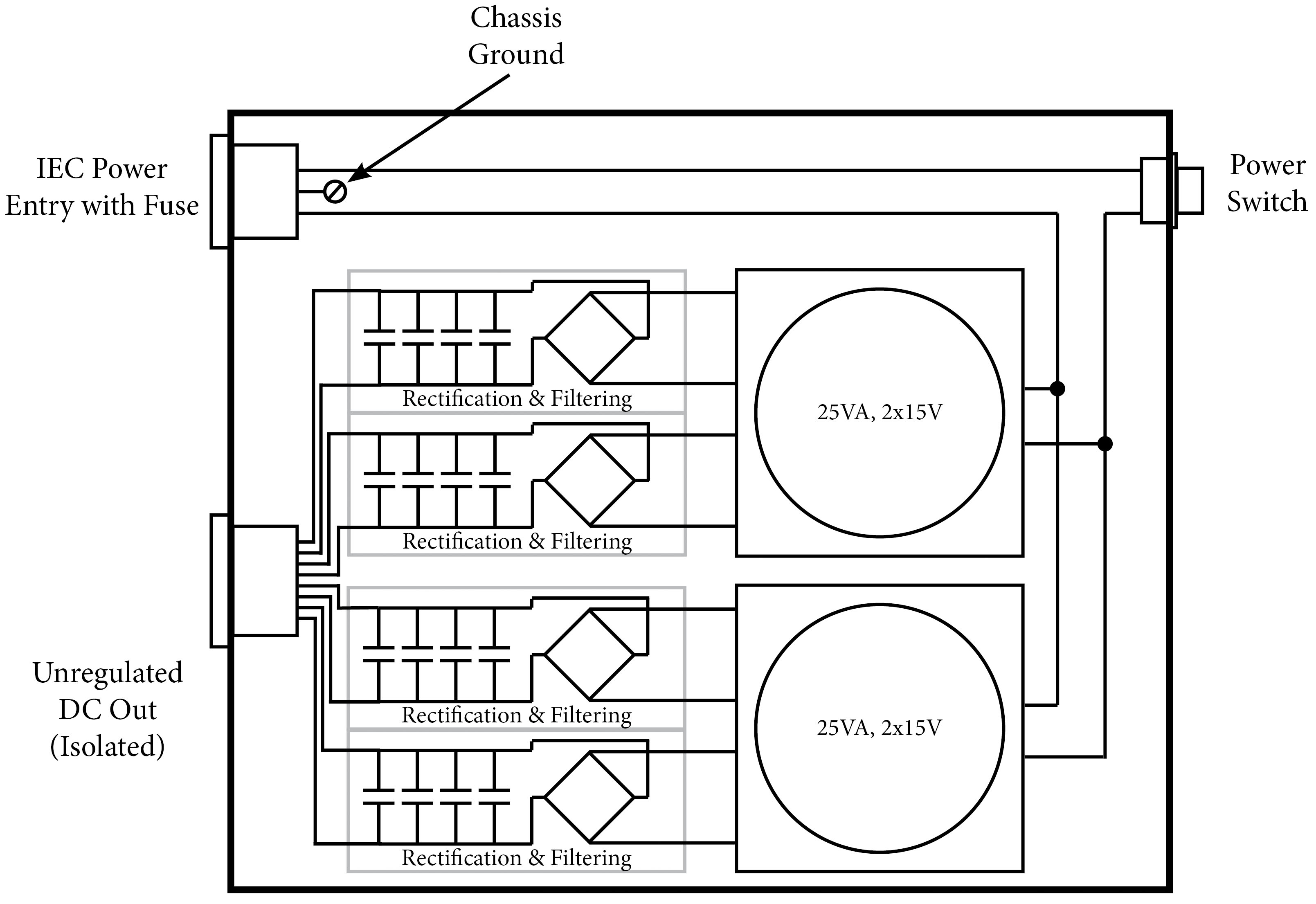

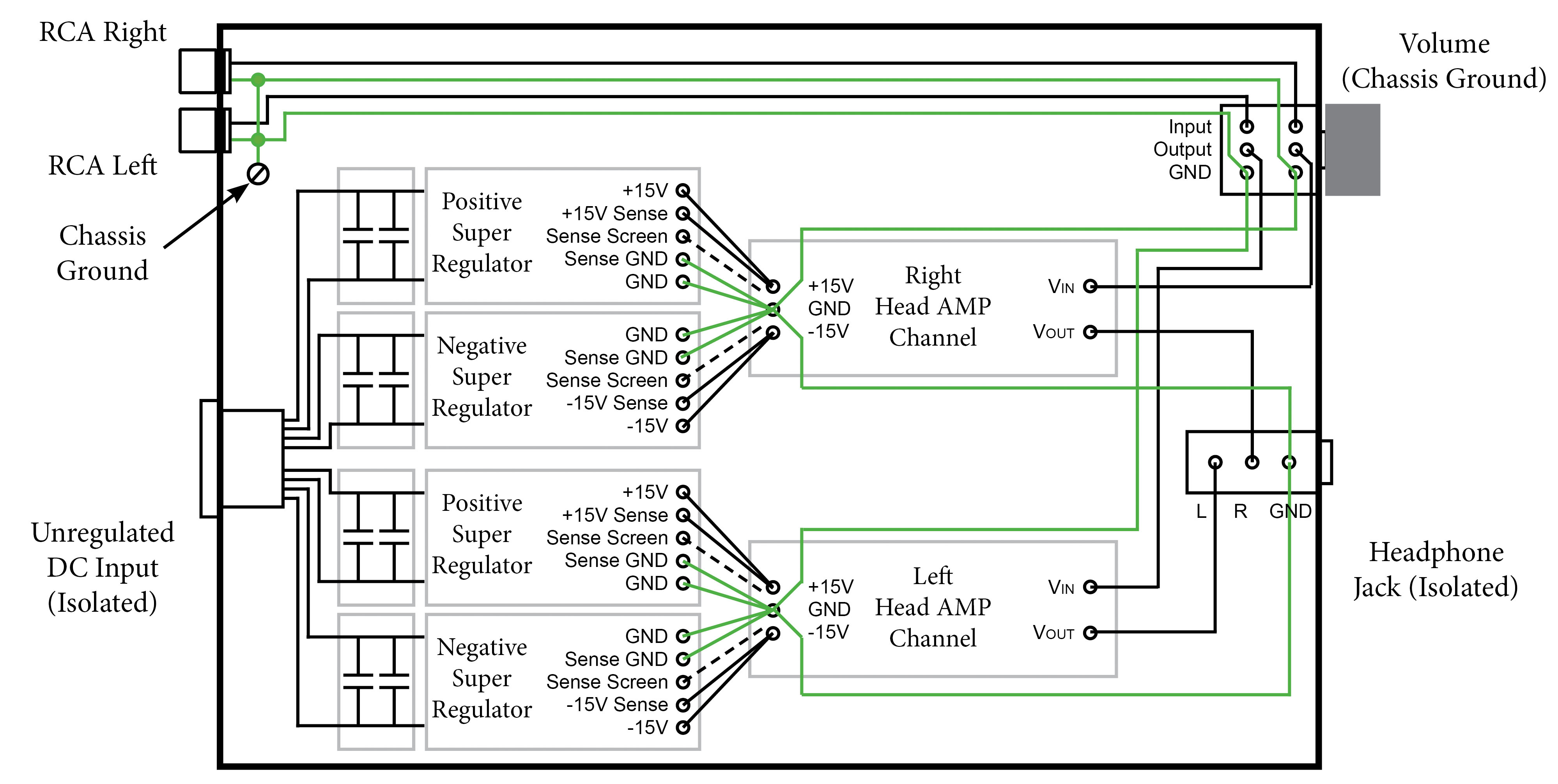

Hi there,
I am trying to build my first diy project.
I read a lot but I am still not sure how to do the wiring and grounding - especially when using the super regulators. My best guess so far is depicted in the images below.
I would like to use four superregs (SR) (2 x pos and 2 x negative power supplies).
Could you guy please help me with my remaining questions:
1. Grounding that avoid potential ground loop problems
- Does it make sense to connect the input ground the potentiometer and to the chassis?
- Is it possible to connect the headphone jack GND as depicted?
- Does the potentiometer GND L / R connected to the superregs make any sense?
- Will the grounding in picture 1 work?
2. Unregulated DC
- I am not sure if I should use 2 x 1,000uF capacitors before SR?
I highly appreciate your comments.
Kind regards
Michael
the volume potentiometer is part of the signal input circuit.
It is NOT part of the Chassis.
The input socket has two wires. Those two wires feed the vol pot.
The vol pot has two output wires. Those two wires feed the two input pads of the mono PCB.
If the vol pot has a metal body, or a metal securing thread, then that metal should be connected to chassis.
Your right hand diagram is wrong.
You have connected the input RCAs to Chassis. Remove this connection.
You have connected the vol pots to Power Zero Volts. Remove this connection.

Indeed, fully agree.
Otherwise, the raw DC routing is spot on.
