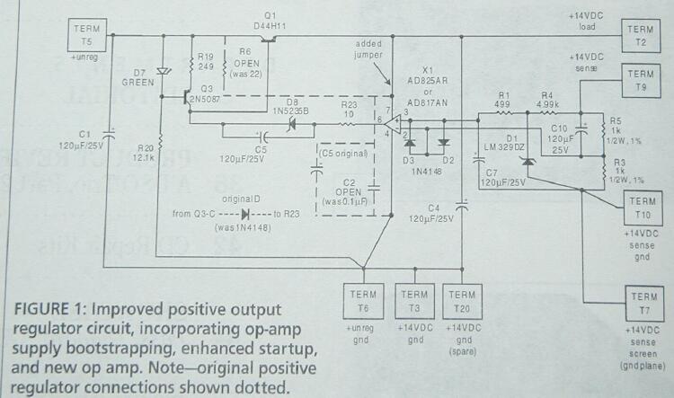

Thanks to a forum member I have now got hold of and read
the TAA article series on the superregulator (and other
regulators). It is very interesting reading and it seems basically
all questions asked so far in this thread were already answered
there. However, I do wonder about one thing. These articles
still use the version with AD797/AD848 and with the opamp
powered from the raw DC side. I understand that more
recent versions use AD825 as the preferred op amp and also
powers it from the regulated side. In fact, I already before had
such a schematic, which seems to be copied from a printed article.
I thus conclude there must be at least one more recent article
than those I have (parts 1 - 4). If this is a continuation of the
article series in TAA I don't know. I would thus appreciate info on
this/these article(s), and would also, if you excuse my boldness, appreciate if someone could mail it/them to me.

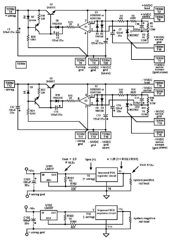

I wonder also where the picture comes from. I've an another picture which is more or less identical but it seems to it comes from a datasheet or application note.
I had the EDN link and read it and the reason why I started this huge thread was that I wondered of a couple of things which the article didn't reveal.
I might be wrong, but I strongly suspect the picture I posted
above is from some magazine article. Note also that it clearly
notes certain modifications wrt. to some earlier version, which
seems to indicate it is a follow up article to earlier publication.
janneman said:This must be from a follow-up to the Audio-Amateur article series. The schematic is for a 5V version done by Walt Jung. I recognise the terminology for the terminal names as the ones I initially used in the AA article, part 3.
Jan Didden
Eh, why then does it say +14V on the output.
Anyway, I would be interested in this or any other article
discussing the changes of opamp and opamp supply.

This is Andy's updated version and not the Jung regulator.
How is Peranders going to get his all in one regulator PCB done if you guys keep confusing him with all these versions? Just don't show him the version with all FETs instead of BJTs. That is the newest one.
'Another excellent resource for the Jung regulator is ALW's site here:"
http://www.alw.audio.dsl.pipex.com/jung_schematic.htm
