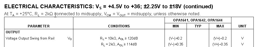

I read Walt Jung's articles and it seems like the opa1641 is actually quite a good choice.
The noise doesn't rise too much at low frequencies ( 8nV @ 10Hz ) and the jfet input keeps current noise low etc, plus it is rail to rail down to 5V supply, and an open loop gain of over 120dB. Output current is 30mA so that should be enough for this circuit and 16x tda, given I'm also using the high hfe pass transistor.
I now understand why the feedback gain resistors work in parallel. I will have something like 4K and 9K so that will be something around 2.7K on the input to the op amp. Seems quite high ?

Why do you need 4 LEDs as replacement for ZD1? ZD1 is used as level shifter and with 4 LEDs and with 6V output you are pushing opamps output bellow neg power supply???
You have pure luck, since OPA1641 is capable to swing that low, almost to the neg power supply rail
Your voltage reference: how do you calculate gain?
Another issue: watch for OPA1641 input range
