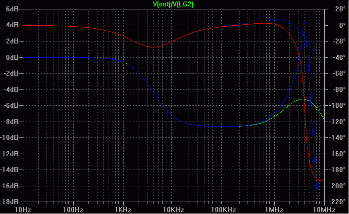

I'm not sure if you've done any stability or transient response simulation using steps of load current for this circuit using LTSpice, but I suspect not. The reason I mention this is the presence of C13, a 0.1uF X7R capacitor directly at the regulator output. I found an impedance plot of the 0.1uF X7R chip cap here: http://www.niccomp.com/Catalog/nmc2.pdf. This plot shows a series resonance at about 19 MHz with a series resistance at this frequency of about 0.07 Ohms. This corresponds to a series inductance of about 0.7 nH. I have attached an LTSpice plot of the frequency response of the pass elements from the simulation of the 90 Volt version of the regulator I posted earlier (which admittedly is a bit different, being a Darlington configuration with different devices). I added this capacitor my simulation and plotted the frequency response of the pass element with and without the capacitor. The phase plots are above and the magnitude plots below. What's happening here is the open-loop output inductance of the pass elements is forming a resonant circuit with the 0.1uF capacitor, causing the amplitude response to peak at 4 MHz (the lower blue plot), and the phase to take a very sudden dive at this same frequency (the red plot).
Combine this with the AD797, which has an open-loop gain of 40 dB at 1 MHz, and my guess is that you have an oscillator here. I see that you have the network of C9 and R9 to provide some lead compensation at high frequencies, and this may be a partial fix. But this design causes some problems too. I tried this compensation approach with the 90 Volt regulator and gave up on it. I was using the Middlebrook technique to look at the loop gain and phase for AC, and adjusted the feedback capacitor to get good phase and gain margins. However, with essentially two feedback paths, the loop gain does not tell the whole story with regard to the transient response of the output to a step of load current. What happens is that since there is much less feedback from the output at high frequencies, the open-loop characteristics of the pass element at these frequencies (mostly iinductive) has an effect that's much more pronounced than you would expect. You get lots of ringing, even though the overall gain and phase margins of the loop might be quite good.
Many of these issues have already been discussed in this thread.
Thanks Andy. Yes I know that choice of output capacitors is a sensitive part. It's not good that they are too good in some situations. The slow down parts are "just in case", first just short R9.

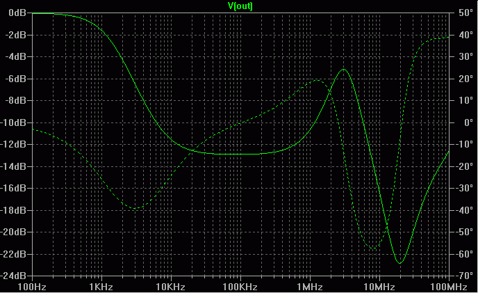

Wow, those are nice transistors. My new simulation shows they make quite a difference. But in order to get good results, I'd need ESL and ESR data of the 100 uF load capacitors. According to the ELNA America web site http://www.elna-america.com/PDF/RV2.PDF, the 35 Volt RV2's only go up to 22 uF. Do you have more values available in Sweden? I don't see these in RV3 or RV4 either. I do see a RV35V101MG10-R. These parts have a pretty high ESR: 2.0 Ohms. I'd guess the ESL would be slightly lower than the leaded types, maybe 20 nH instead of 30 nH?
Anyway, here's the plot with leaded caps with 30 nH ESL and 0.25 Ohm ESR. The loss is 12 dB at about 8 MHz, while the open-loop gain of the AD797 is about +12 dB at this same frequency. So the unity loop gain frequency of your circuit would be about 8 MHz without the 100 pF compensation cap. The phase lag is about 57 degrees at this frequency, while the phase margin of the AD797 is about 62 degrees at the same frequency. So it looks like an oscillator without the compensation cap. Without the 0.1 uF capacitor, the 60 degree phase lag at 8 MHz goes away and you have a very wideband circuit.
