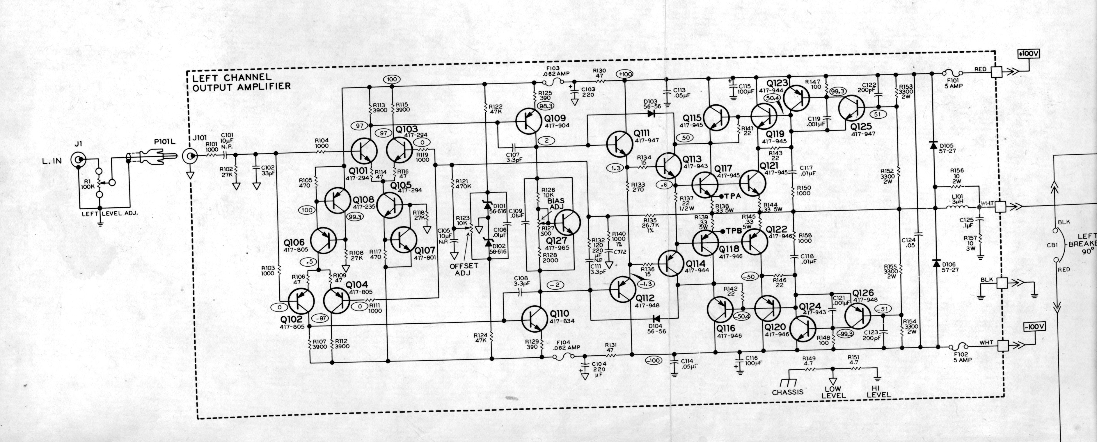

Schematic, note that the series connected VAS is gone, the series connected output is CFP
(Q123,Q124) on the driver, and he uses MIC HF compensation - you might have to login at CSP to see it:
http://www.classicspeakerpages.net/IP.Board/uploads/post-100682-1185488054.jpg
Heathkit AA-1800 schematic attached, posting it here in case you can't read it at CSP:
100V rails are insane.
Definitely insane and not for 3055s.
It's not much of a leach though, the front end is nothing like leach's, it's just a standard fully symmetric ltp with nothing special, seen everywhere out there. Not a specific low tim design.
I find it a bit hard to understand in the way the output stage is drawn.
What are those part numbers corresponding to?
I'm not too sure about that offset adjustment system. Wouldn't that be exposing the coupling cap there to extra dc?
One other odd thing is the bias trimmer. What happens if the cursor lifted?
I don't even see the purpose of the additional fuses for the front end.
What are those diodes D103/4 for?
Curious how a nested feedback loop picks up at the base of Q112, only on one side (nothing on Q111).
There are quite a few caps also sprinkled all over, which shows there may be the same kind of instabilities to fight against.
At least one thing is done right, the freewheeling diodes are actually connected on the amp's output and not on the speaker side of the output LR.
Could be educational to simulate though.

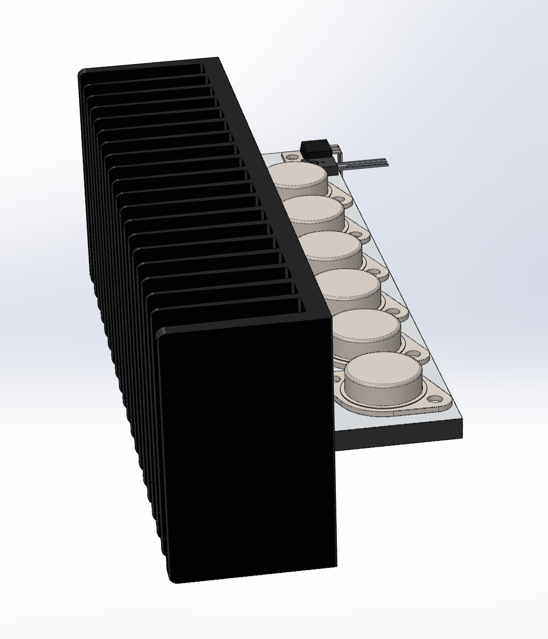

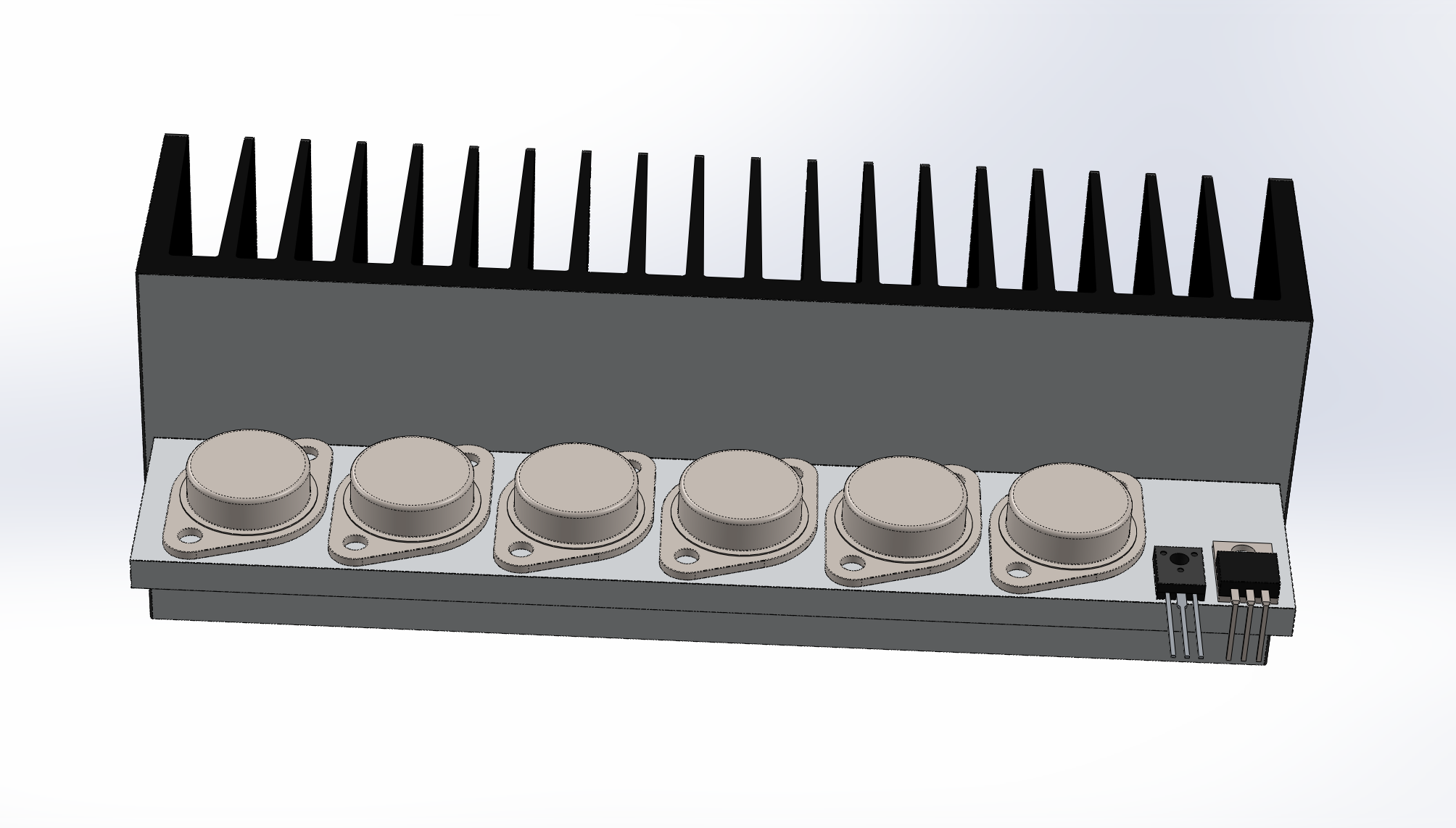

Here are a couple of visuals for a possible arrangement of heatsink, which would work with the conrad MF20 single flanged sinks.
In such a 20cm length, we can fit 6 TO3s, along with a TO220 driver and a TO126 sensor. And it fits just right.
There would be 2 of such arrangements required for a superamp with 3 sets, as long as it's been scaled down to only the outputs stacked, the other stacked devices having been removed from the design.
This could be set up as a single long sink by bolting 2 of them together to make a single 40cm long one, or the pcb could be designed in a way to have each sink on its own side, making the amp more compact.
I was already looking at such an arrangement for a 3055 based grounded bridge amp.
One other thing could be done, to make the thermal coupling even better for the TO126 sensor: slapping that TO126 sensor right on one of the TO3s, bolted with a common screw. This would probably require a little bit of preparation on the TO3 device, depending on how it's made, by filing a tiny bit of the round part of the case to allow the TO126 to sit nicely in its space, and of course an insulator would be required to separate the TO3 and TO126, but that would make a single thermal junction instead of 2, for the thermal link between them, and much less thermal lag.

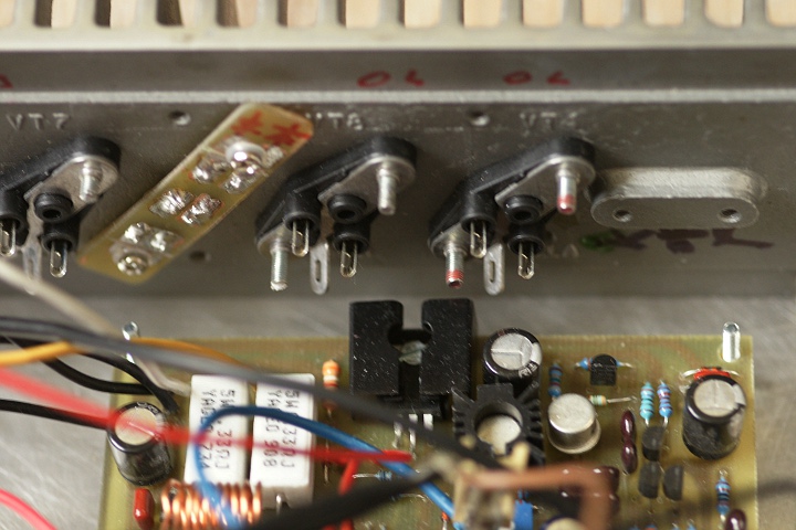

in terms of complexity of mounting thermal sensing diode: I soldered them on a separate small PCB and then i grind them flat and then screw them on heat sink between transistors using thermal grease. Works fine.
It can always be made to work somehow, but what a pain to do. Extra wiring, more stuff to be more likely to fail over time. Plus the grinding of plastic may seem like it would work fine for a better contact, it's still not going to be as good as a properly bolted case on a sink.
I'm certainly not saying it can't be done, I just am not liking that method. I prefer something less flimsy.

The reason why I pointed out the Heathkit is that it might have solved some, if any, of the
stability issues that you are seeing. It is another opinion, with a series output stage and a
normal VAS as I suggested.
Yes, it has less diff pair degeneration, and much more on the VAS, it has Miller Inclusive
HF feedback which Bob C. seems to like.
