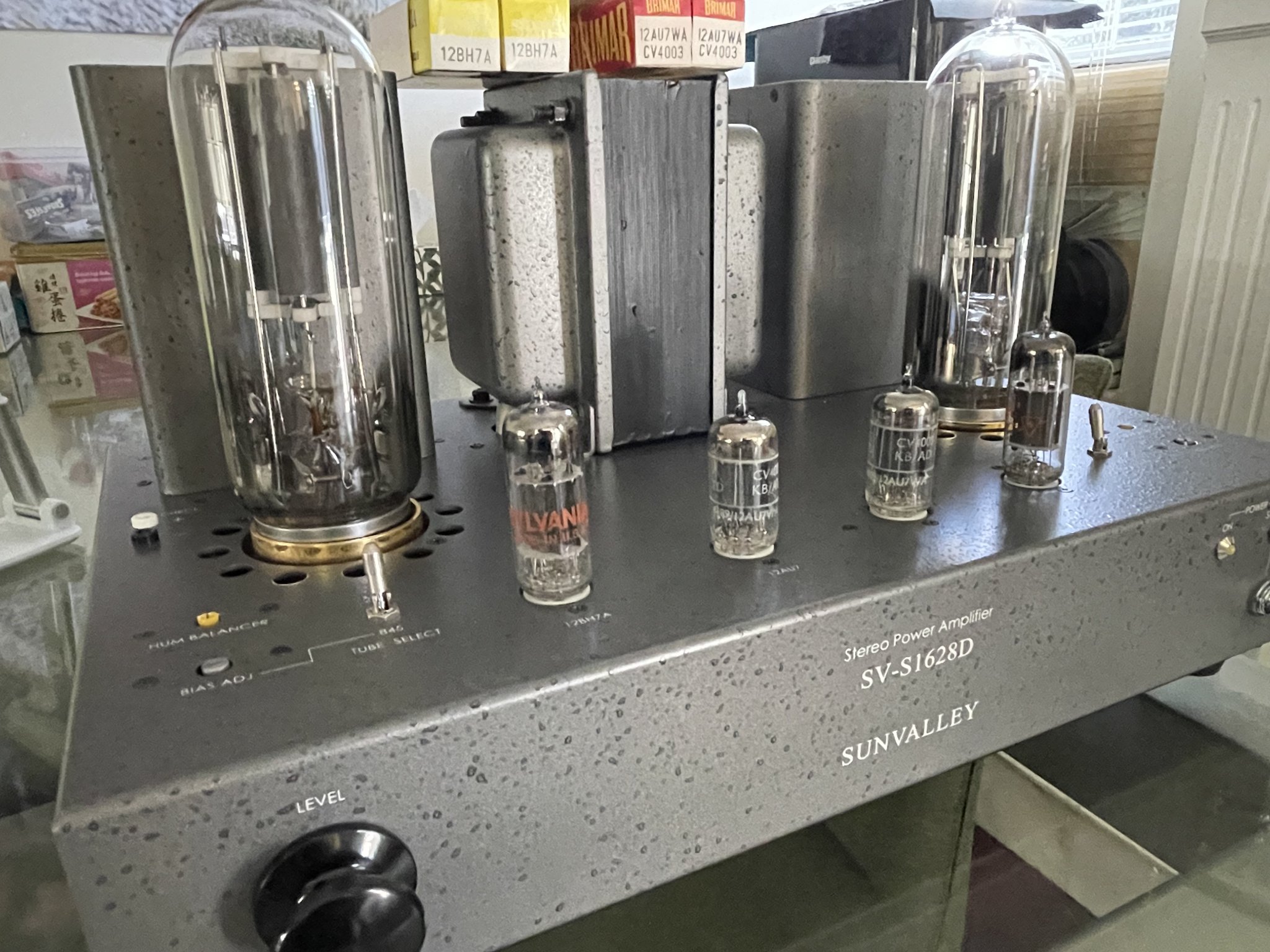

Hello, I too am interested in the SV 1628D amp but having a very difficult time finding reviews of the amp or finding someone who can describe the sound I can expect from this amp. Any comparisons to other amps already on the market? ANY help is appreciated!

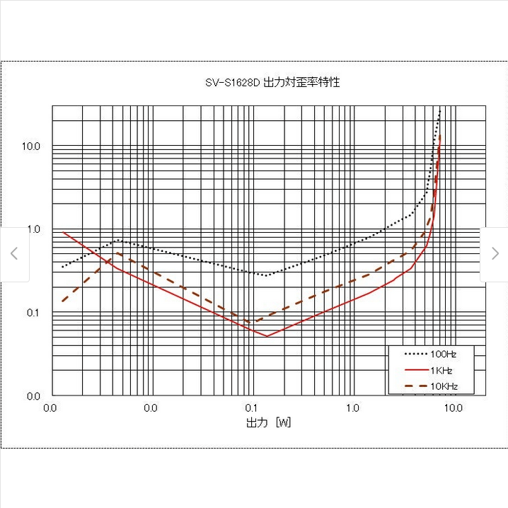

Hi I came across this Japanese blog detailing the amp's measured performance when I was looking for more info regarding the amp prior to acquiring one
https://blogtag.ameba.jp/news/SV-S1628D

Interesting to see the graph of measured distortion. It looks to be the performance with the 211 tubes..
