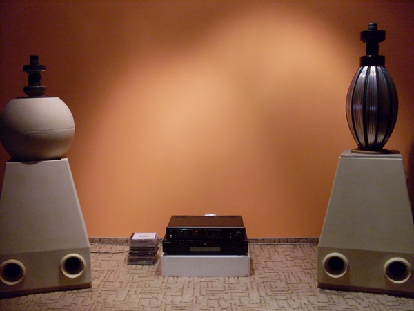

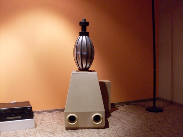

Man, that is work of art :up: :up: :up: :up: :up:
On the speaker to the left ... what is the middle round thingy ....
More pictures please ;)
Kind regards Baldin :)
Just letting you know this clone is not mine. It is Areczek's
http://www.diyaudio.com/forums/planars-exotics/153337-my-mbl-101e-replicas.html
The round thing is just being used to hold up the unfinished speaker.It is missing the big aluminum lower-mid-range driver other than that they are both completed. I will agree they look exactly like the real thing and I have heard they play like it too.

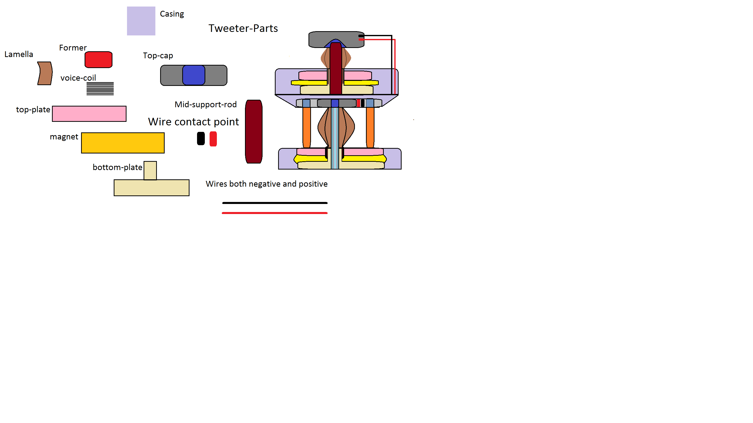

Tweeter and Mid-Range Model

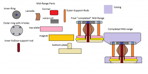

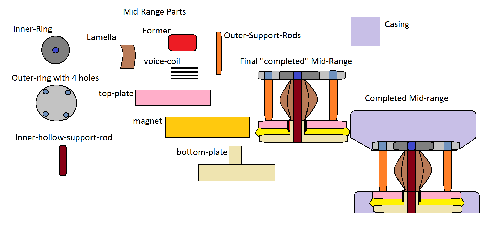

Tweeter and Mid-Range Model showing the bare construction. Lamella dimensions and cooking process have been realized. Next step is to make a model using a pre-existing driver with a native 50mm diameter voice-coil and modifying it to make a mbl Mid.
Driver has been chosen as the Dayton Audio RS52AN. This is a Dome mid-range witch have inherently large voice-coils for their size. In this case it fits one of the many requirements e.g. a 50mm voice-coil.
