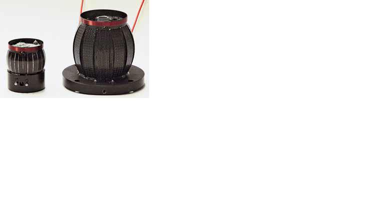

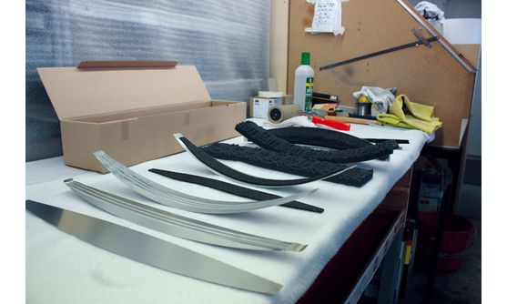

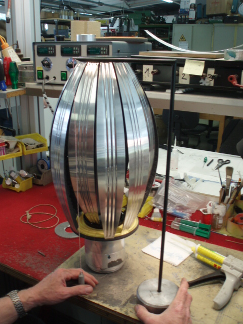

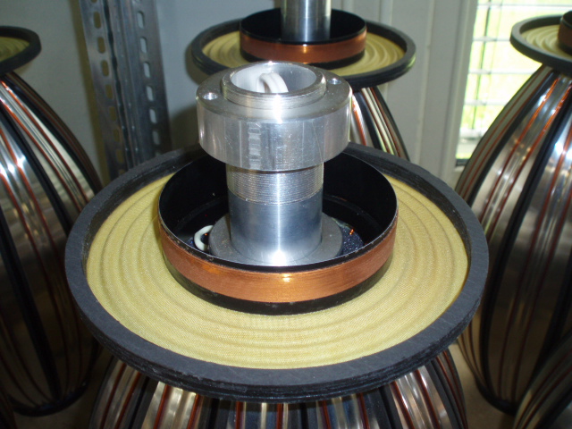

I have a good 2 months out of school and i decided to build a replication of the loudspeakers MBL 101 mkII. The monetary resources to build a clone at least parts of it are taken care of . The following are the complete information of construction regarding the MBL 101 mkII. This project is inspired by this thread http://www.diyaudio.com/forums/planars-exotics/153337-my-mbl-101e-replicas.html

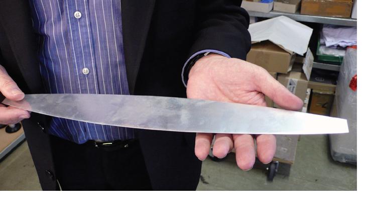

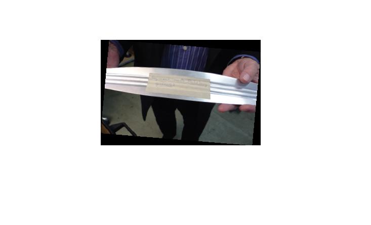

The aluminum lamellas are a sandwich construction of two aluminum wedges held with epoxy resin Wrong. The petals are given 2 days to cool like airplane parts. layers of polyurethane foam are slapped on the back of each lamella to provide damping and additional mass. Each lamella is fitted with 2 thick reddish copper ''wires''. The wires are fitted into the vertical recesses of the petal. The wires add mass and an aesthetic beauty. The recesses of the driver are rolled and not stamped. The whole assembly rest on a cast aluminum plinth coated in automotive grade atracite metallic paint.

Right now i am hopping to simply replicate the mid-range and used them as my stereo setup and as research and design along with resources progress the replication of the other 2 drivers will begin. I am learning to use Femm so that i can design and build the magnetic circuit for the mid range.The processes for building the mid range will hopefully be done in parts such as

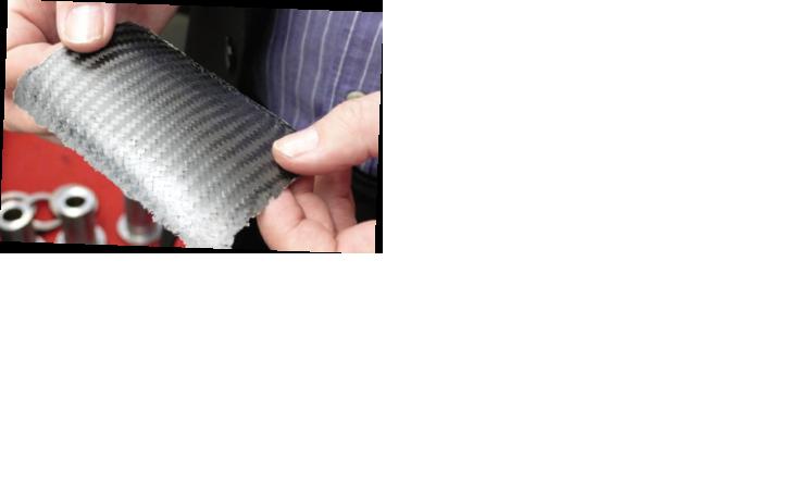

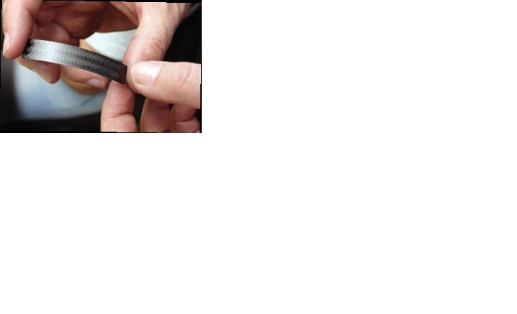

Step 1 : Magnetic circuit fully designed and optimized in femm
Step 2 : ferrofluid properties such as viscosity,heat tolerance,and Gauss rating can then be calculated
Step 3 : Carbon fiber baking methods can be R&D
Please tell me your thoughts on such a project

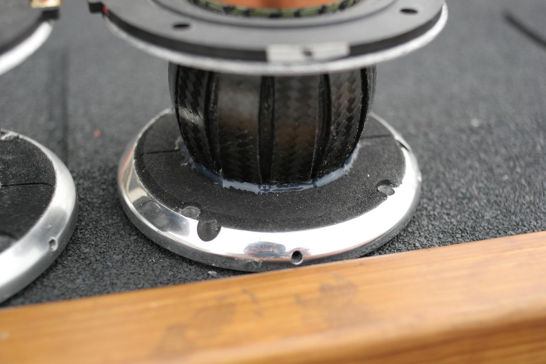

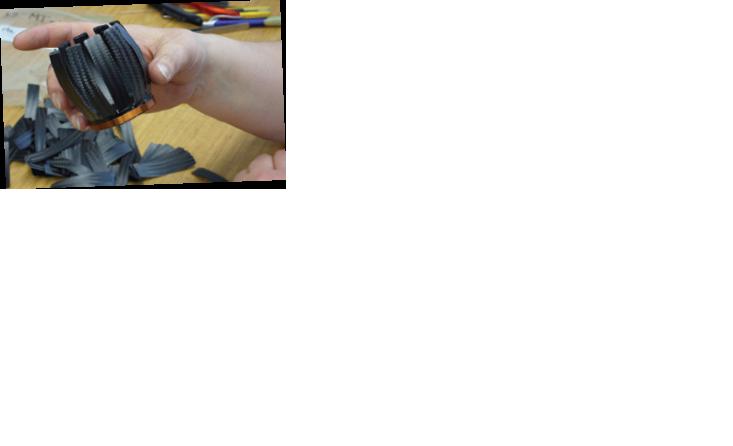

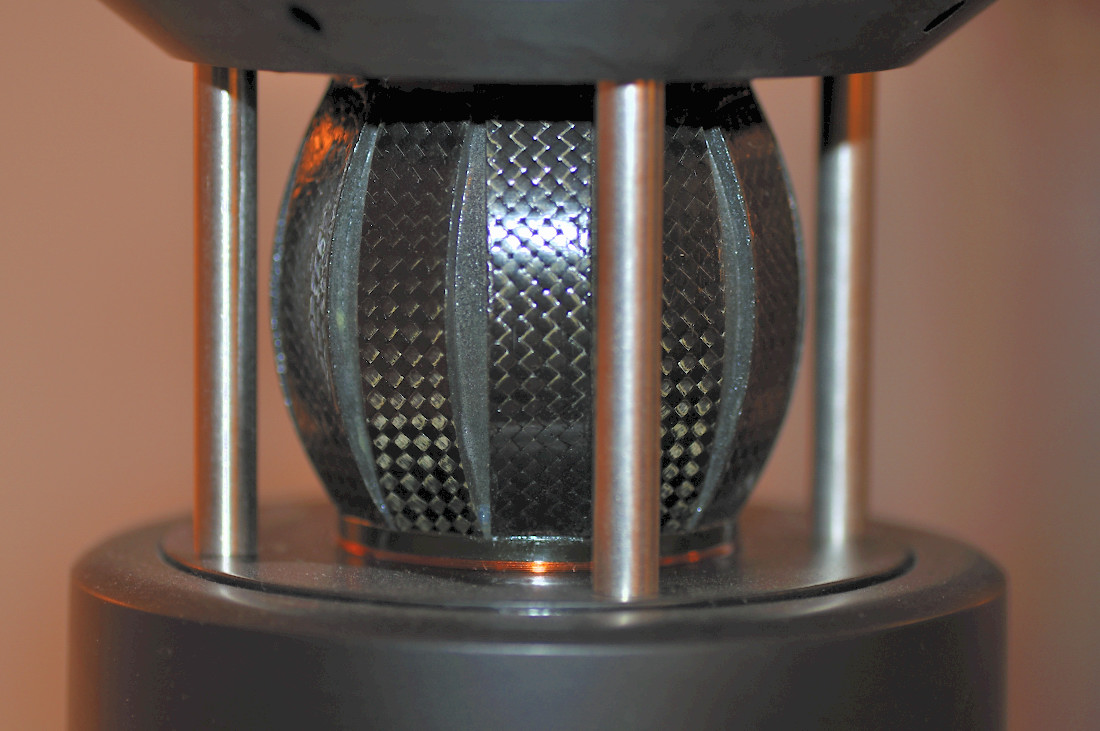

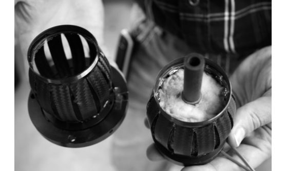

The mid-range
Pictures of the mid-range driver naked
mbl-116F-Elegance-f557x334-ffffff-C-309f4ea2-51568967.jpg21.8 KB · Views: 266
Mbl mid partially asmebled with thrust plate held in place.jpg14.9 KB · Views: 200
Mbl mid the petals are glued to the voice coil and thrust plate.jpg14.8 KB · Views: 275

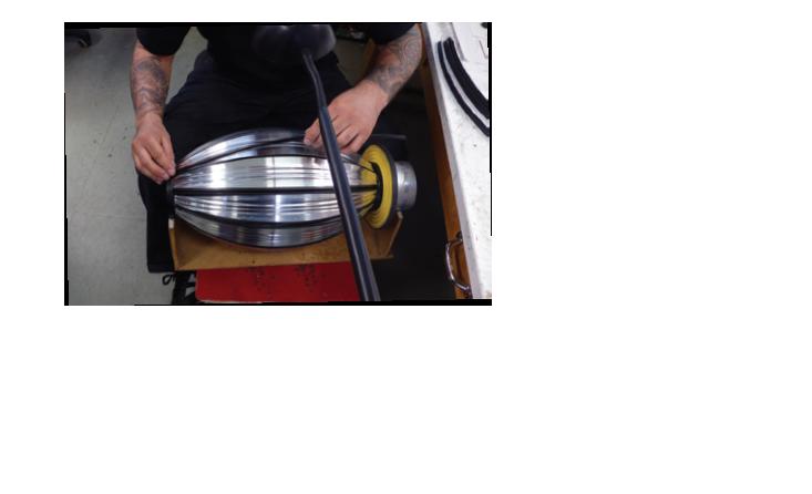

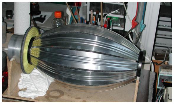

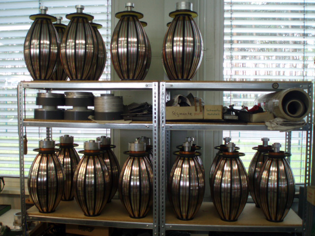

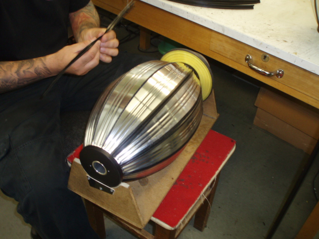

The Melon
Pictures of the Melon naked
mbl melon the black elastic bands are being put on and so is external dampening.jpg20 KB · Views: 123
mbl melon beinge flued to thrust plate and motor sytem.jpg25 KB · Views: 265

Well my goal for this summer break is to at least get the mid-range driver completed. I don't think i will be needing to out source many of the parts, Since I have a friend with a high grade cnc machine at his disposal. Although yes the end goal is to have replicated the entire thing.I think Seth's head just exploded!
So, you are planning to replicate the entire thing? Not outsourcing any parts of it? Hope you don't require much sleep, cause summer break is not a long time to get this worked out.

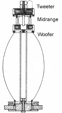

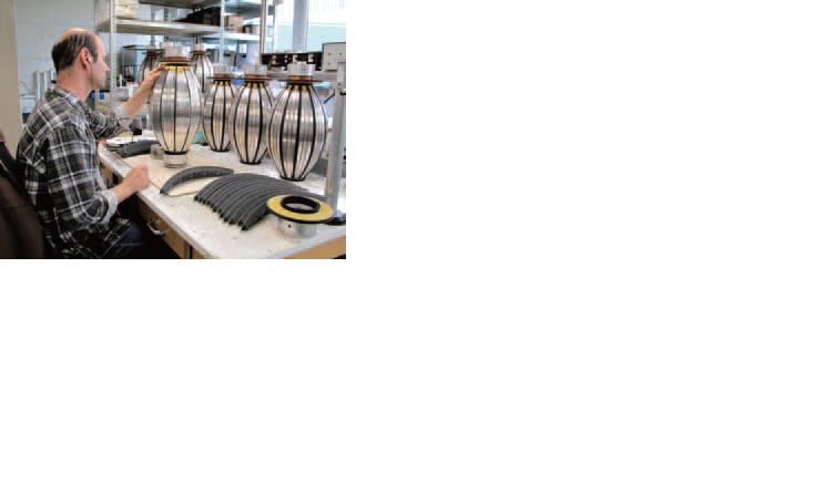

I know this is going to sound silly, but can anyone tell me how the drivers work. If you look at the naked pictures of both the mid and tweeter there's only 2 pieces of materiel.
The only speaker motor that i know of is a sandwich construction. with either a overhung or under-hung topology.tihe the mbl the v-c looks to be literally standing on the magnetic motor structure. Anyone got any ideas?

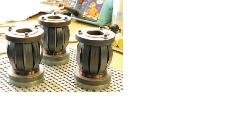

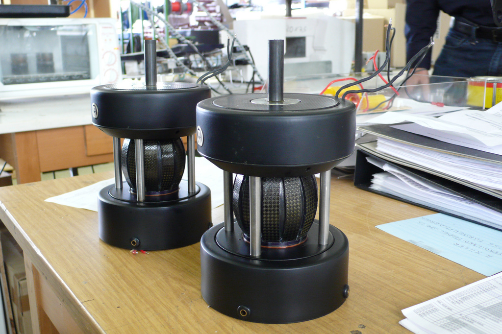

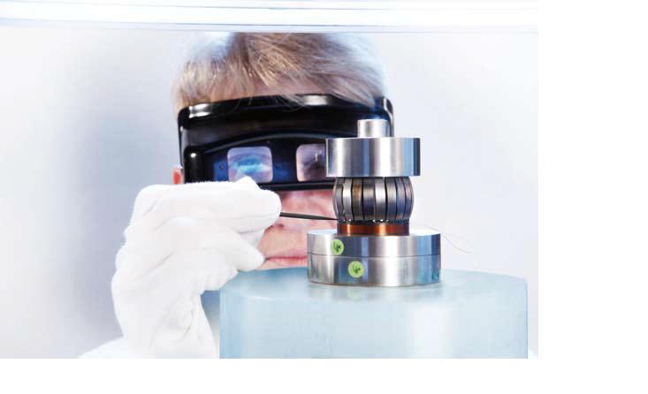

Looks to be a straight forward magnetic circuit with a standard voice coil - looks very overhung - on the end of the "melon" petals... the VC pumps up and down and the petals move in and out in response...
otoh the VC may be pushed into the gap when the unit is assembled... gotta look closely at the pix, I haven't yet.
If you look at the Walsh (Ohm F) driver, it is really quite similar except the "cone" on the MBL is different...
The MBL is frightfully low in sensitivity, so be sure to max your magnetics and get the gap right...
I'd be concerned about the VC moving linearly in the gap, having seen how they assemble it. Very surprising to me that they seem to attach the "petals" to the VC former after the petals are connected to the opposite side. I would have expected to do it in the reverse fashion...
Also I am surprised at the damping material on the reverse side of the bass petals, and the fill inside the midrange...
seems to me that forming the petals accurately is going to be a bit of a difficult thing to do, and essential to the operation of the driver as well...

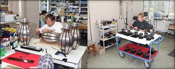

where did you find the pix of the manufacturing process?
Guess MBL is daring anyone to try it themselves!!
Please do post your progress, successful or not!!

The pictures of the manufacturing process were found after days searching on the web finding literally all i could.. I will surely be posting progress updates but before that i am still learning about FEMM and magnetic circuit design. Also Mbl states that the other end opposing the V-C is attached to a thrust bearing what exactly would this add?Looks to be a straight forward magnetic circuit with a standard voice coil - looks very overhung - on the end of the "melon" petals... the VC pumps up and down and the petals move in and out in response...

On the bass "melon"? A thrust bearing??
Perhaps a mistranslation from the German?
I would think that over there is more or less a hinge, so that the bending motion is not impeded by stiffness. So, the hinge would need to have stiffness in the vertical direction (the way that the VC is pushing - that vector) but be able to bend outward to permit free flexing of the petals... or not. Pure conjecture.
It might be marketing hype too... the connection to the VC would likely be the *same* as the connection on the top.
educated guesses... or uneducated blabbering... either way about the same value?

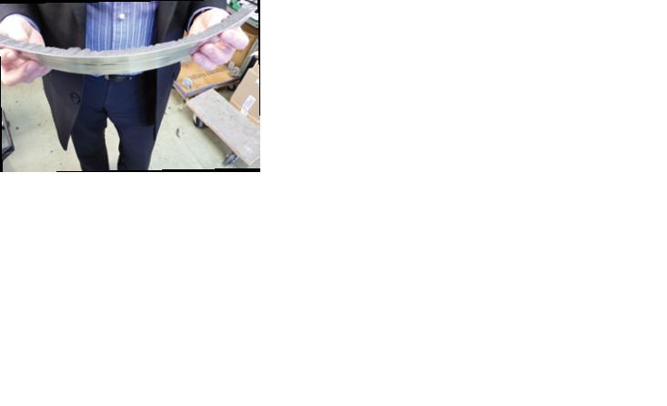

and i just wonder where did you read that the aluminum lamella are made of 2 pieces glued togheter?
Thikness?
Quite sadisfay, but an updated version is ready to be realized ..
I am involved in woofer contsruction at the moment....
Thikness?

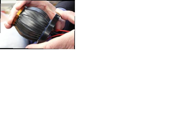

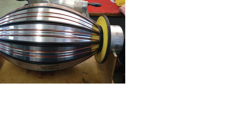

Actually the gap where the lamellas are fixed has to be large enough to permit them to vibrate. The trick is to choose the correct glue. Mbl is supposed to use a silicone rubber glue. Furthermore, is very important that does exist an axial rigid connection to the thrust bearing, otherwise it works as a low pass filter.
I touched the lamellas wilhe the loudspeaker was sounding and it doesn't have a large excursion...as expeted.
