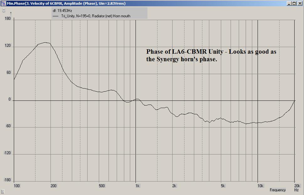

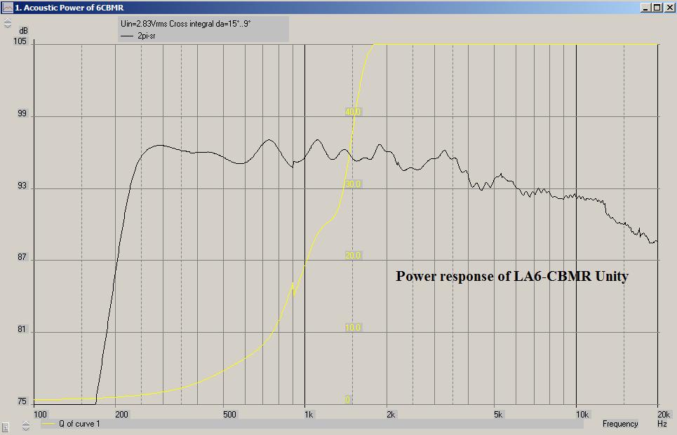

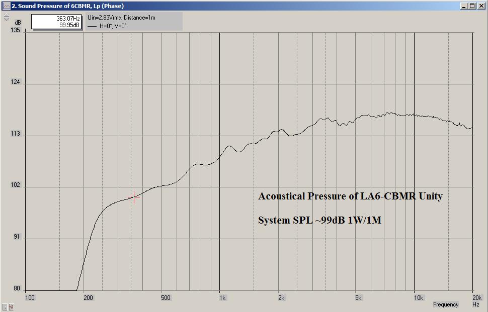

I aim for a fairly flat power response that rolls off above 10KHz. Completely flat power response is way too bright sounding to me. The acoustic pressure needs to raise due to the falling power response of the conical horn. However, it is this falling response that allows the conical to be CD.
I've modeled with the Faital 3FE20 and it works well if you can get a back chamber of 0.037 Liters. That's really small, and I don't know if it is possible. Of all the FE series, the 3FE20 is the only suitable one because it has a treated cloth surround. All the other sizes have a rubber surround. I'm not all that happy about the single roll cloth surround of the 3FE20, but I guess I'll just have to live with it.
I plan to purchase one 3FE20 and see if I can make a small enough back chamber for it. If it works, then great! If not, then I'll just be out $30.

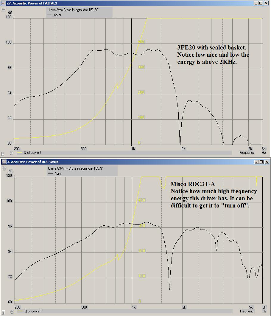

I've been modeling in Akabak with the Misco RDC3T-A and got a complete 3-way Synergy finished. The only issue is the cost to try them. They have to be bought in lots of 30 pieces at about $8.40 each. So, it will run over $250 to try them, and they are non-returnable.

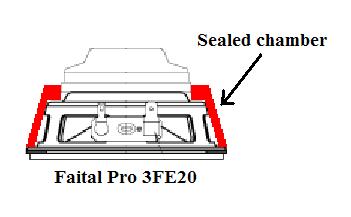

Here's a pic. I didn't seal off the basket permanently, I just used rope caulk to make it airtight. I have a whole box full of ruined Tang Band woofers, so I wanted a non-permanent solution
With the basket sealed off, I measured a Fb of 590hz, and a qts of 2.3. This is consistent with what was predicted. I had to calculate qms and qes by hand, because my Woofer Tester was freaking out over wiggles in the impedance curve.

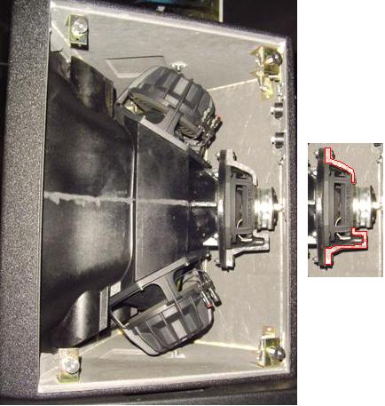

I did something similar to what you're talking about with the corners using 5" drivers. If you make the flat walls extend past each other on one side of each wall, you can shift the drivers off the center of the panels and fit larger drivers closer to the throat. I did this on my horn I built 10 years ago. There are some recent pics of it further up the thread although it's kind of hard to see this detail. I do have single entry points for the mids that are in the corners of the interior of the horn.
The best way to do the holes is to make very small diameter, very short holes with rounded ends to reduce turbulence (like a port for a vented box). Small short holes have high impedance which is what prevents the tweeter from 'seeing' the holes. When I did this on the horn I'm using in my garage, I got great response out of the tweeter (that is, smooth). However to get high sensitivity with relatively flat response from the mids with holes like this, you need certain T/S parameters that my drivers did not have. So my mid response was crap. I then enlarged my holes (a lot) to confirm the prediction of my matlab design script. It worked, and now that horn has great midrange response but horrible tweeter response. It still sounds okay, but the tweeter response is not smooth.

Like in one of my posts above, I want to seal the rear of the 3FE20 just like Danley sealed the rear of the BMS 5CN140 used in the SM-60F. See that attached picture. I copied the section of interest and outlined the cutaway chamber in red. It looks like getting to around 600Hz with the 3FE20 will be possible.

This is what Mr. Sheerin is talking about. It is the same thing I intended to do if we got stuck using 5" mids. Basically, each panel of the horn lap over the next side.
I'm comparing the raw midrange response of the sealed 3FE20 and the RDC3T-A. Perviously I had mentioned that it can be difficult to get the RDC3T-A to turn off in the high frequencies. That complicates the crossover some. It also makes matching phase with the compression driver more challenging. Either way, I got it to work just fine in Akabak. The 3FE20 has better sensitivty, but that point is moot because the compression driver is the limiting factor. Where ever you get the comp driver to EQ out to sets the system sensitivty. That's one reason why the BMS comp drivers are so good for a Unity. They have better high frequency energy than just about anything else on the market.

BTW, What do you make of the shape of the front chamber of the Danley horns shown in the picture you posted to illustrate the offset mounting. The circular channel is relieved for a rolled surround?

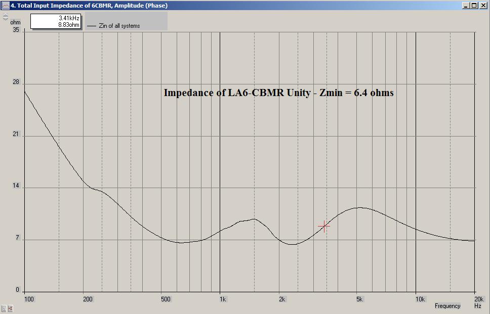

I was looking at the impedance plot of my Misco JC5RTF-B, and noticed that the impedanice peak was almost a full octave lower than what was predicted.
I can only hazard a guess as to what's going on here:
Again, I can only guess what's going on here. Further research is warranted, but it's something to consider since two of us are stuffing our horns.
- Is the added mass inside the horn changing the Fb of the woofer?
- Horn-loading has been known to push down the resonance of the woofer, but not to such a dramatic degree.

The thing you need to know is when you load a 91dB mid into a Unity you pick up around 10dB. How much you actually pick up is determined by how strong a motor the mid has. This partly explains why the Faital 3FE20 has about 3dB more sensitivty in my models than the Misco JC5RTF-B. In addition, due to the increased loading, the Fs will drop too. A weaker motor will drop lower in frequency than a strong motor.
