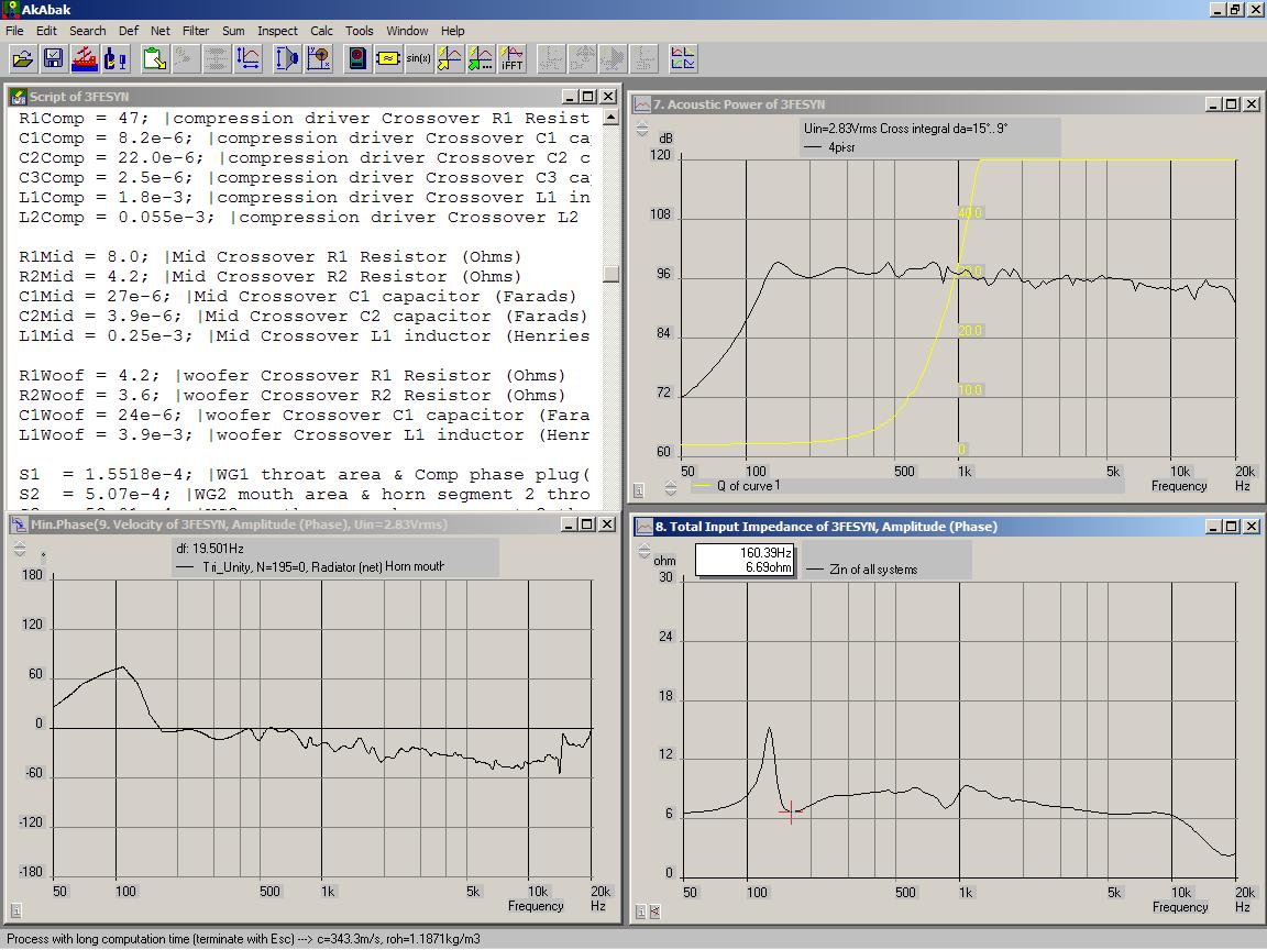

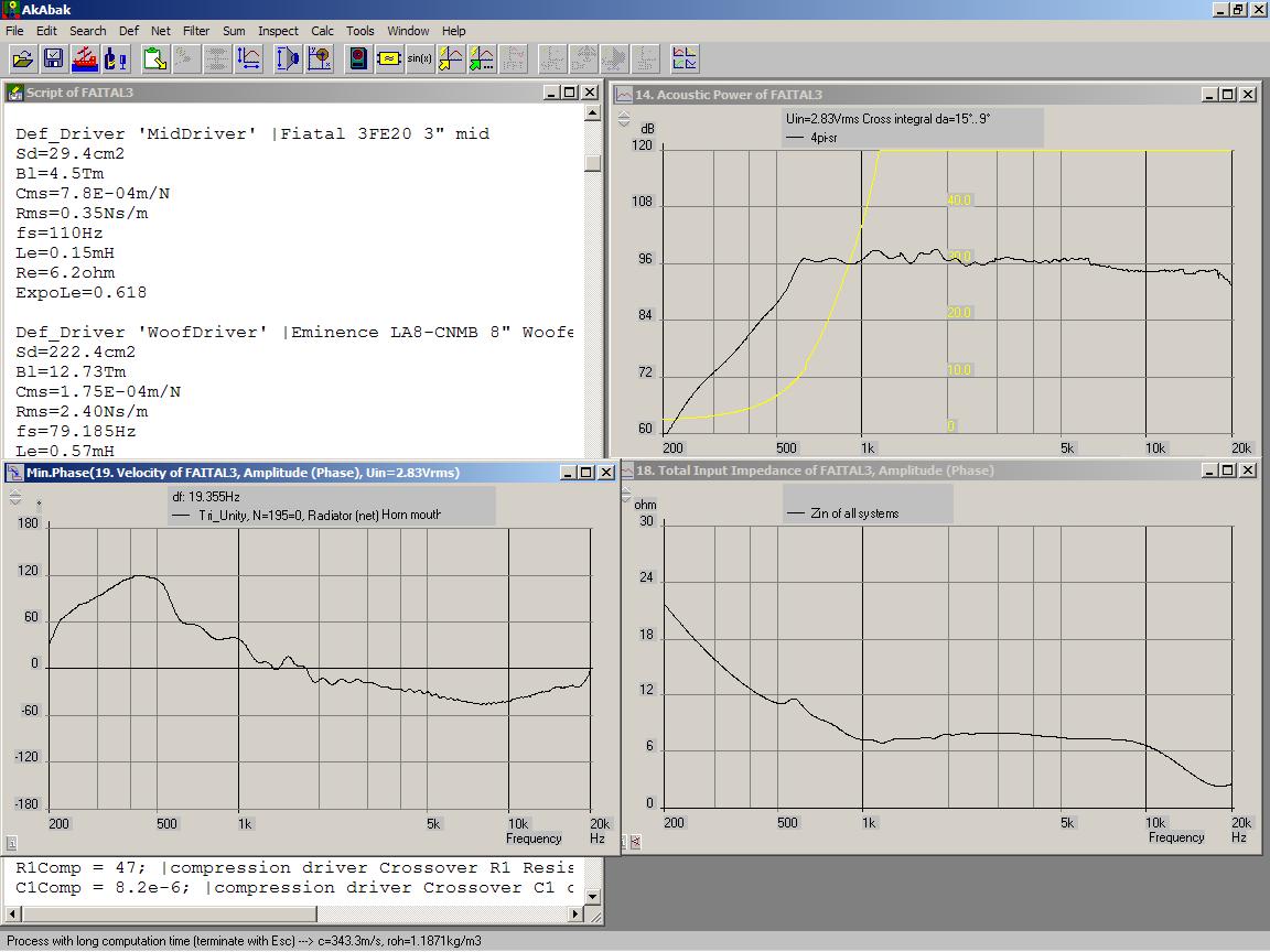

True. One of the things that can be tough is keeping the impedance of a Unity/Synergy up above 4 ohms. If you look at the Danley site, you'll see most of the Synergy horns are rated at 4 ohms. This isn't just to pull more power from pro sound amps, it because thats the way most of them end up by using 8 ohm speakers. The model I'm working on for the 3FE20 is around 7 ohms, which is better than most of my other models.

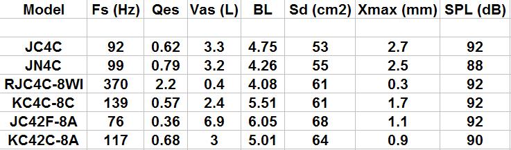

Looking over all the mids that Misco has, these are the ones that could work. My eye tends to favor the JC4C. All of these mids would have to be sealed up. After thinking about it, I'm not sure if the 3FE20 will work out. Sure, the Fs can be pushed up to 591Hz (per John) in free air, but can we keep it up there when mounted on the horn? That seems to be the million dollar question.

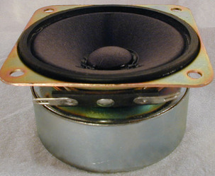

The KC4C-8C looking very good on a horn, flat acoustic power from 400 to 1400Hz.
It also easy to seal the frame on this driver, because it`s nog rugged.

You are correct. What I have found is the frequencies below the point where the horn becomes omnidirectional will be boosted. Some of this plays in our favor. I personally like the sound of a slightly raising low frequency response in the lower midrange and mid bass. (See William Cowan's web site - I agree with him - My Unity Horn Speakers ) By keeping the power response fairly flat, I can achieve this. Now, some adjustments must be made to the real crossover, but the results are much closer than if you aimed for flat pressure. Going from simulation to the real world has its challenges, I'm just trying to find a path that gets me closer to the desired result with the least amount of adjustment. I feel aiming for flat power response does this. At least in the higher frequencies it requires almost no adjustment.

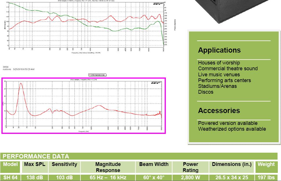

One of things I do to help myself with some of the Akabak script is look at the current Danley models. I try to visualize what is going on behind the scenes. Since the horn I've be working with is 60 X 40, I took a look at the SH-64 spec sheet. I glanced at the impedance curve and about fell out of my chair. I can't believe how close my model's impedance is to the SH-64. Everything is shifted up in frequency as expected - my model is designed for a Fo ~ 100Hz. This appears to be comfirmation that I'm very close to making this real.
