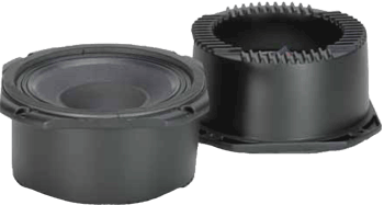

Midrange appears to be six of the RCF M8N301s:
$1800 for six :O
The mids are 5" custom units and not the M8N301. Still don't see how they can compete on price with Danley unless they sell at a loss until they get their scales of economies up. You can see what EAW is doing is throwing a lot of money around with custom drivers to do what Danley does with off the shelf parts. Its just my opinion, but from an engineering perspective this makes EAW look pretty bad and exposes their lack of innovation.

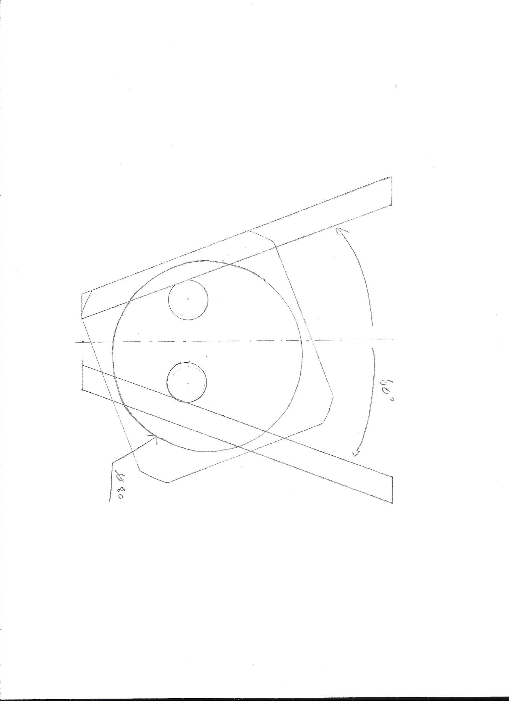

Question about port location relative to wavelenght:
I know that this has been disgussed on numerous ocassions, but I need get it cleared one more time!
Can one just place the holes to best fit as long as they are located such that, the distance from anywhere on the driver surface to the nearest hole will be less then 1/4 wavelenght relative to the x-over?
Won't turbulence cause some of the the waves to travel to the farthest hole, or is this negligible?
/Thomas
/Thomas
You can use Akabak to look at the air velocity at the ports, and also the horn cross section. As long as it is kept below about 17 m/s it should be fine.
Now you've just completely lost me:confused:
Maybe I didn't asked the right question - I'll try to rephrase.
With a 6.5" driver you have diameter of appx. 130mm. Let's say you have to place the holes near the egde of the cone and not far apart. This means that soundwaves emitted farthes away from the ports will travel appx. 98mm. before it hits a port With a 1500Hz x-over a 1/4 wavelength is 57.3mm. Will this not cause delay/phase problems?
/Thomas
