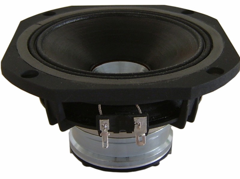

It has a 5" coax with unity style entry holes for the midrange. See the patent for details. I guess it is this BMS driver:

To get 'in the ballpark', find one that either is a closed back unit that resonates at ~SQRT(200*1400) = ~529 Hz, or if open back, then ~529 = 2*Fs/Qes. How you get there doesn't matter if you're not trying to get max efficiency out of it with 'X' diameter x 'Y' long vents. IIRC, TD's prototype driver's published specs were ~2*250 Hz/0.99 = 505 Hz, so I wouldn't get too hung up on the apparent need for a low Qt just because it's a horn app.

First off, the BMS 5CN140 which appears to be used in that new synergy horn. Our goal is to pop the values of FS and QES into the equation "2*fs/qes" and find one with a value of 500hz or higher. The higher it is, the higher we can cross the compression driver over. If the value is too low, we get a gap between the midrange and the tweeter. The BMS weighs in at 317. So that's pretty darn low. In my experiments I've found that it's possible to extend the upper frequency limit by carefully manipulating the volume of air under the cone, and the shape of the ports. I'd guess that Danley did the same thing, and extended the response via trial and error.
Assistance Audio doesn't list the BMS on their site right now - if someone wants it, they should give him a call. Jack has been known to do special orders, and has offered drivers that aren't on the site.
I checked out the options from B&C, but the smallest option is 8". At that size, geometry starts to limit your options. The closer you can get them together, the better.
I'm surprised the Beyma works as well as it does. Most of the ones that work well have a paper cone, an accordian surround, and a massive motor. Basically an ultra-light cone and surround married to a powerful motor.

I suspect the Fs is a little bit high on that driver. The Celestion has an Fs around 400Hz. Many of the Danley designs use the TF0410MR. Generally speaking, you can get a little bit more useable output below Fs. The original Unity midranges had an Fs of about 500Hz, but had useable output to 300Hz. That KT410 should be useable down to around 650Hz. However, I'd need more specs to model it before I would put out any cash on it.
