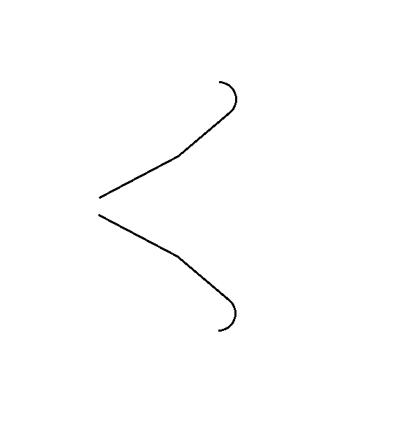

Harman has a great paper on loudspeaker ports, and one of the things noted in the paper was that bowtie shaped ports performed very well.
So basically a port that's shaped like this:
works better than a port that's shaped like this:
Now a horn is not a port, of course. But this is still air we're talking about, and if you think about the air path in the horn, it's basically a giant version of that bowtie shape above.
IE:
big volume of air ---> necks down to small volume of air ---> expands to giant volume of air
big - small - big
Also, they found that the 'bowtie' shape shouldn't be symmetric. It should neck DOWN faster than it necks back UP. And if you think about it, that's what the frustum is doing, as it feeds the conical horn.

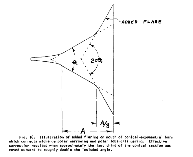

Increased flare angle
A question about the increased flare angle on the last ~1/3 of the Synergy horn:
How large is the angle increase, it does not this seem to be a fixed angle ratio? - What I mean is: some designs employ a 50% increase, others much less. Is it more a trial and error thing?
/Thomas
/Thomas
Trial and testing, available mouth space, horn depth, all play into the design, but as Don Keele wrote back in his AES paper "What's so sacred about exponential horns", approximately the last third of the conical section is roughly doubled.
So a 25 degree horn goes to around 50, a 60 to around 120, but as the main angle increases, the "break" angle does not need to go as wide, a 90 would not need to go to 180.
The additional angle does end up making the conical more exponential at low frequencies, increasing output over a conical.
Thank you again, Art.
Is it of upmost importance to widen both the horizontal and the vertical plane or can one just (for easy of build) increase the horizontal angle?
