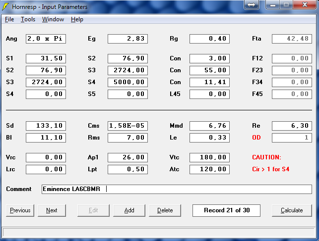

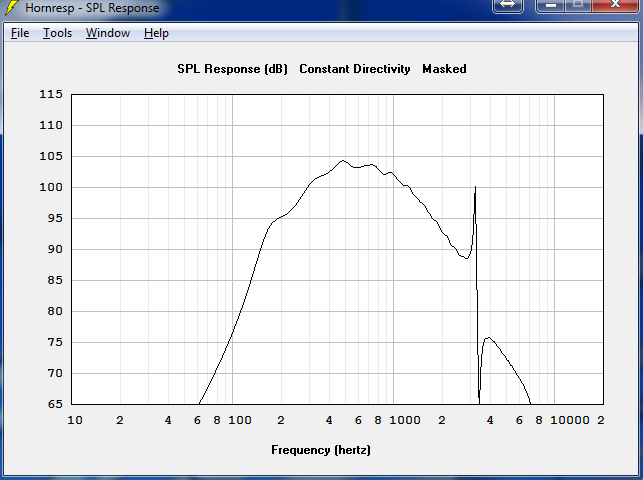

I am using Eminence Alpha 8" and 6" with relatively small (less than a 5/1 compression ratio) exit holes, they sound and measure well.
Maybe I'm doing it wrong, with 5/1 ratio my sims look like (see pics). The larger entry hole/s also gives me a spike at ~3000Hz.
Hornresp exaggerates the peaks and dips, the spike at 3K may hardly be audible or measurable.
Hornresp also does not take cone breakup into account, the upper response may not follow the sim all that well.
Hornresp will get you in the ballpark, as you can see from your sim, a crossover in the 1000 to 1500 range will work OK.

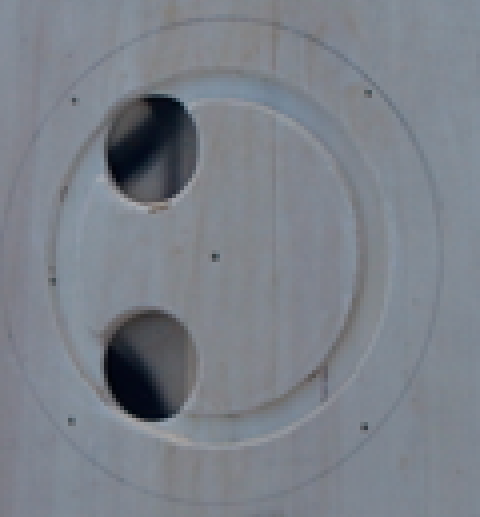

What i mean is: won't the big mid-holes mess up the high frequency response?
Thomas,
The exit holes as in post #709 (an 8") had no measurable effect on the output of the Paraline HF, I tried "before and after" holes, the graphs overlayed precisely.
If you plan to use a TPL, the throat will be between the Paraline height and a standard compression driver exit size.
Using a standard 1" throat conical horn the holes may have a slight effect as the percentage of open to closed space would be larger, but by locating them at the corners of the horn and making the exits "sausage shaped" any adverse effect would be minimised.
Also, larger cones put the holes further away from the throat apex, the further away from the throat apex the less effect on HF waves, which are already "formed" in the first 4-5 centimeters of the horn (or driver).
Art

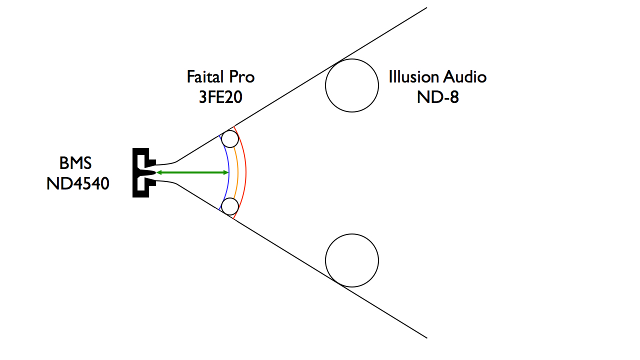

For a unity/synergy horn, I understand the midrange and woofer ports are placed 1/4 of the wave length of the desired crossover points. However, that is a little vague. For example (see attached diagram):
1. Where does one begin measuring from? Is it the diaphragm, acoustic center, or something else?
2. Where does the measurement end? Does one measure to the near side (blue radius), center (orange radius), or far side of the ports (red radius)?
I've made a mold and would like to try using the BMS ND45 crossed over at 1200hz to Faital Pro 3FE20's at 250hz to Illusion Audio ND-8's. I don't know if each crossover point is too low, but I would like to try. If anyone is willing to model these drivers, it would be appreciated. For those who want to know why these drivers, because it is for a car and I already have them.:) FYI, the drawing is not to scale or proportions.:eek:
Thanks!

The local area of expansion (flare rate) dictates how low the mid will play. The cross sectional area dictates how high you will get high frequency loading from the horn. This is a different issue than the 1/2 wave length cancellation notch. The area the mid taps into needs to have a circumference less than or equal to the wave length of highest frequency of interest. For 900Hz you want to tap into the horn where the area is approximately 115cm^2 and 146cm^2 for 800Hz. You have to balance the 1/2 wave length cancellation notch, the local area of expansion, and the area of the tap in point all simultaneously to get a Unity or Synergy horn to work correctly.
Thanks!
