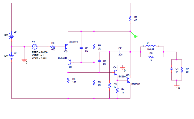

I'm trying to build a class-A buffer for a transformer-based headphone amplifier. The idea is to have a very transparent buffer so the distortion of the transformer can be heard. The distortion of transformers is very nice from a theoretical point of view (it decays with frequency, which may allow to have a sweet midrange and clean voices), and has low intermodulation. It can also be increased by adding a small bias current.
After some playing in spice I've come out with the attached design. Distortion is excellent: 0.0001 % THD (almost all second harmonic) at 1 Vpk and 20KHz, which should drive my pair of AKG 701 to the unhealthy SPL of 102 dB's. It also has power to get to more than 110 dB's so there is headroom for peaks, which will have a slightly increased distortion. It should be noted that this is a huge improvement when compared to class-B operational amplifiers of the breed of the LM4562, which performs better at 1Vrms but distortion skyrockets at lower volumes which will constitute most of my listening, and it also contains less benign higher harmonics.
I'm having a couple of problems with this design. The first one is that I need a transistor for the output stage. The BC550B that I'm using in the simulations would blow up immediately if used with this current, but most power transistors are too powerful and too sluggish. I'm looking for something in the vein of the 2SC3505 but with slightly higher current capability (even if it comes at the price of lower breakdown voltage, certainly I do not intend to go near 300V). Any idea of how a power JFET would behave there? They seem very fast and don't have problems at 250 mA, but they are hard to find and poorly modeled in spice. Cascoding is another option but it comes at the price of decreased stability when compared to a single high-frequency transistor.
The second problem is not exactly a problem but an issue I'd like to improve on, and it is stability. The square wave response, while stable up to 500 pF loads, shows some nasty ringing that I'd rather not see. Obviously I can increase compensation until it goes away, but this would come at the expense of higher distortion. What would be really great is to make the amplifier faster, so the poles that are causing the ringing went upper in frequency were the gain is lower. I would appreciate very much hearing suggestions in this aspect.
Disclaimer: This is untested, design-stage schematic. While it is intended to work, it may need some modifications (the most notorious is the change of Q5 and the addition of a DC servo) and may present stability issues.

My idea is to use a 150:600 step up transformer, hence the 600 Ohm resistor in the source. I see both CineMag and Jensen do manufacture them. The CineMag has some nasty peaking at 150 KHz, but in the Jensen the distortion is quoted at -20 dBu, so I have no idea how they will perform at normal listening levels around 0 dBu.

I reattach the schematic in PNG format for those who don't like to open PDF's.

Thank you for your suggestion. I did a considerable amount of research before deciding to build my circuit, and I found there was not an actual reference buffer that had a truly great following. In fact most of what's out there falls in three categories:
  • Simple followers (For some reason people love to build them using FETs, even when they usually have large distortion and some not-so-benign high-order harmonics)
  • Random stuff in the feedback loop of an op amp
  • Diamond buffers (either integrated like the one you mentioned or discrete)
The first ones just don't do well compared to more elaborate topologies. The stuff in the feedback loop of an opamp does well but I think its quite inelegant, besides the fact that the opamp is a class-b circuit and in a headphone amplifier it will literally not leave the crossover region. Crossover distortion is not as nice as the second harmonic from single-ended class-A. Stability may also be a pain if it operates as a follower. The BUF634 that you pointed out has the problems of class-B, and I think distortion-wise it does well but its not great.
So basically I've decided to try my shot at a reference buffer for headphone applications. Certainly if my present design behaves as well in reality as it does in simulations I may be close to have just done it.

If i'm well informed, The Wire is based on the LME49830. This would be 100x overkill for my headphone amp!
Regarding the circuit destroying itself when connected to a capacitive load. I measured my headphone cable capacitance to be around 1 nF. This was too much for my previous design, but the present iteration seems to hold it well and therefore I will remove the RL network from the design.
When I discussed ringing, I meant ringing at the output of the amplifier, before the load. This ringing is due to the phase margin not being high enough, and it is bad stuff because in my experience phase margins are always lower in reality than they are in spice.
Now I have replaced the input transistor by a Sziklai pair taken from Douglas Self book and the performace seems much better. I get a THD 0.0002% of (almost) purely second harmonic at 20 KHz 1Vpk an and a nice, critically damped square wave response on 1 nF without filtering. Please see the attached schematic (Disclaimer, it is untested and may not work, or even blow your headphones). If I can beat the 0.0001% THD mark I'll design a PCB. It would be awesome to see people changing the parts I've chosen because they sound bad :D. (Please note that I have not invented this circuit. It's close to an output-stage-less blameless amp with two pole compensation.
EDIT: But it has my contribution! While Douglas Self says cascoding the input stage does not make a difference, I've found that in this circuit does indeed provide an improvement by a factor of 10 in the distortion. I guess it is because of the non-inverting unity gain operation.

your assumptions about monlithic op amps are wrong/outdated
op amps driving output buffers usually work Class A in all stages - the output of most "audio recommended" op amps are internally biased ~100 uA or more (based on indirect evidence from open loop output Z plots), driving 100+ kOhms, single digit pF at the buffer input they never leave Class A for audio signals
if you want deeper Class A output bias people have long loaded op amp output with few mA ccs to one rail to force the output into SE Class A - depending on op amp, fab tech the rail polarity, current magnitude may vary for "best" distortion - disappointingly for most the only measured improvements with this technique I've seen published are < 10 dB distortion improvement
while "discrete is superior" is well established meme in audio - I would claim for most consumer line level audio applications it has fallen to the technological advance of monolithic process development and design expertise at major linear op amp manufacturers competing for precision instrumentation, medical imaging, telcom markets over the past 20 yrs - it is no longer 1970s
you may say the “the wire” is overkill but it or related op amp + monlolithic buffer circuits take lots less design effort for results you are unlikely to approach within orders of magnitude with available discretes, less than decades of design experience
look at TI’s OPA164x series as a modern example of current performance for “audio” – if you have high source Z then consider OPA827 as a cheaper update to the OPA627 if low order ppm distortion from the input jfet parasitic C modulation worries you

I agree with you in the fact that modern op amps behave better than what is achievable with discrete parts, but they still require the buffer stage to drive a pair of headphones. What I'm trying to do here is to improve in the CFP buffer stage to get it to perform comparably to the globally closed-loop system with the opamp. It may be just a matter of elegance to improve a stage that is already on the design so it makes another stage unnecessary, and the overall performance may be marginally minor (You will probably agree with me that a class-A buffer with 0.0002% THD will not sound much worse than an opamp with 0.00004% THD), but I'm definitely interested in finishing this design.
I must disagree with you on the orders of magnitude thing. If there is the blameless amplifier that can repeatedly drive 8 Ohms loads to 50W with < 0.0008% THD, It must be possible to drive headphones to a few milliwatts with 0.0002% THD. This is not within orders of magnitude of audio opamps. Please note that I respect very much the designers of such IC's. They do 5 or 6 times better than my design goal with microamperes of bias current, while I'm running all the stages so hot that they only use a small portion of their transconductance curve. But I think an output stage can be made clean enough so as to simply not get any audible benefit from the opamp.
