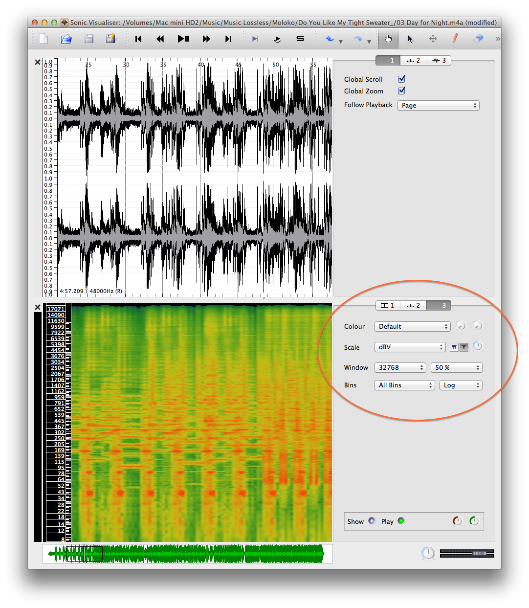

I tried it but am not sure what I'm looking at, any tips anyone?
Open a sound file and select Pane > Add Spectrogram > <filename> All Channels Mixed
Set FFT parameters like this:

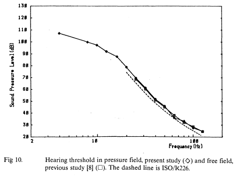

"Bombarded"? I don't think this was the point. Our hearing becomes increasingly insensitive towards lower frequencies. Here's the detection threshold for low frequencies:
attachment.php
(From Watanabe/Moeller, "Low Frequency Hearing Thresholds in Pressure Field and in Free Field")
Physics prevents smallish woofers from delivering distortion free sound pressure levels.
