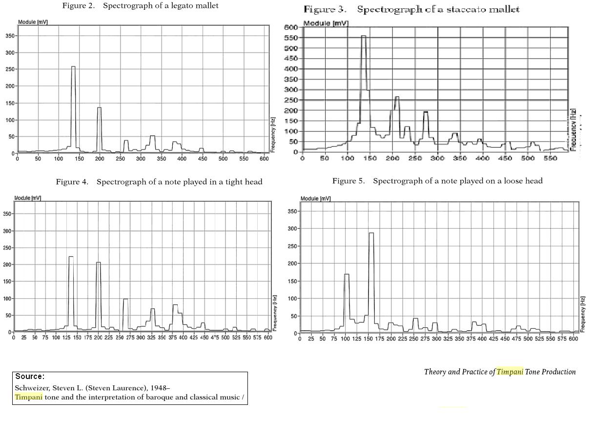

Timpani goes down to around 100 Hz.
It gives the acoustic impression of producing lower frequencies but this is due to it’s harmonics, which lead to the “missing foundamental”.
Musical instruments with low foundamentals
Frequencies
George

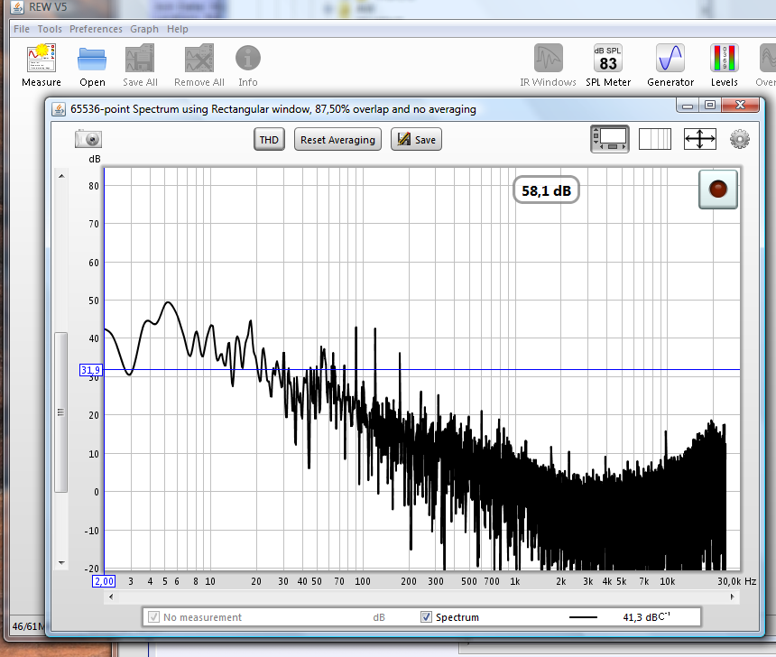

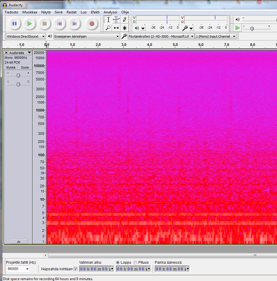

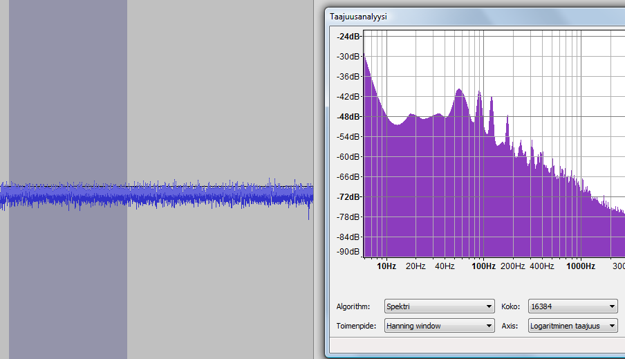

My methods were questioned. Seems to me that I'm the only one who is telling how they measure! Is this why I am under charge? My graph was meant to be a teaser for this discussion, not a "truth"
I quickly took new measurements with three different programs and this time the microhone is Microsoft LivCamHD. Yes, it has an amazing mic! I didn't even try to adjust levels.
Audacity graph is comparable to Zoom measurement, but location is different and this time the mic was lying on sofa (different place) Same position here in every measurement.
REW was set to C weighting.
Yes, i Can hear the ambient noise very well! The PC makes noise and air criculation system is on. Cars and trains are 600m away. Nobody was walking or talking in the house.
Can you set me free now? What about other peoples methods? I am not a scientist and I'll not spend money on a specific calibrated measuring microphone. I don't get paid for this and I don't own stocks of any AV company.
About measured responses and music - commercially produced music hardly ever contains signals <30Hz (noise at level of -70dB and less though) The speakers have trouble trying to put out those fQ and they have significant distortion then. Some of distortion is 1/2 of main Fq. Low sounds also excite the air, window panes, curtains, tables, paintings on the wall etc. They make resonances too. All this contributes to measurements done at listening site. This shoud be a well known fact, only the level of this noise is vague without some measurements of it! Every measurement gives slightly different results, because there are so many variables.
Have you ever heard of anechoid chambers? They have ambient noise too. You can't get away from it but you must know where and how much of it is.
Peace!
Juha

Sorry, I meant to imply that probably none of the measurements being posted were valid below 20Hz (if that), and also that noise in the measurement system needs to be measured and considered. Not only your measurements.

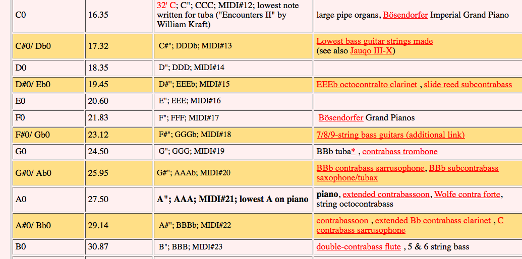

Best avoid music containing frequencies below 16.35 Hz then ;).
I'm not sure what you are up to :D
Your table lists the lowest available frequency from certain instruments. Not all piano for example will go as low as a grand piano.
And as we see, the pipe organ is the lowest on the list. But electronic music can go lower and deliberately so.
Many live performance of piano doesn't even go very low. But live double bass is very impressive, usually better than recorded sound from my systems.
Usually, type of music determines what instruments to be used, and then there is little inclination to choose what low frequency to reproduce. Piano, just doesn't sound at it's best without 40Hz. Double bass, rarely cover 30% of a jazz performance.
