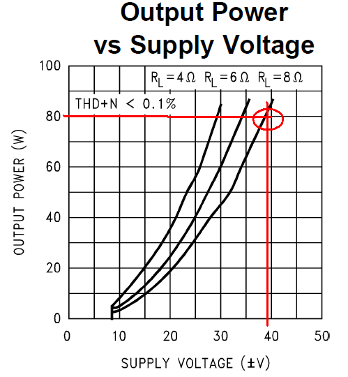

You won't gain much by paralleling into 8ohm.
+/- 35VDC is pretty good for 8 ohm speakers with the LM3886. The datasheet curves say about 64W, but I would be more conservative at about 50W output.
The speaker "specs" say 40W RMS. 50W would hopefully be plenty. Instantaneous peak power is often an entirely fictional number.
The maximum output power of the 3886 running on +-39Vdc is about 65W (+-5W) into 8r0.
If you parallel a pair of 3886 on the same PSU you might get an extra 5W.

Nice information. Very easy to understand :) thanks for that.
Now I slightly opened my eyes & can see the real situation.
I just postponed my subwoofer project because my wooden subwoofer boxes will arrive somewhat two weeks ahead.And also my my mind is moving to stereo listening after reading many passed threads.Many people here didn't make subwoofer amps using these chips they all stereo lovers :)
For the time being I'm going to build a hi-fi stereo system using two LM3886.
By using a 28-0-28 AC transformer it will deliver 39.5V DC per chip. According to the graph in the datasheet it will output 80W of power.
By using two of these chips as stereo system it will sound a lot. I’ll also add an active preamp with tone control to adjust bass & trebles.
Can I be able to make a high quality amplifier using this chip?
80W + 80W = 160W
What you think of this design?
