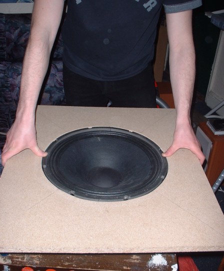

here is a pic of the beta15 in the baffle of my current sub (taken a year or so ago):
cool. im surprised you are so eager to get rid of it. i will find a way to send you the money (probably by check). thanks :D

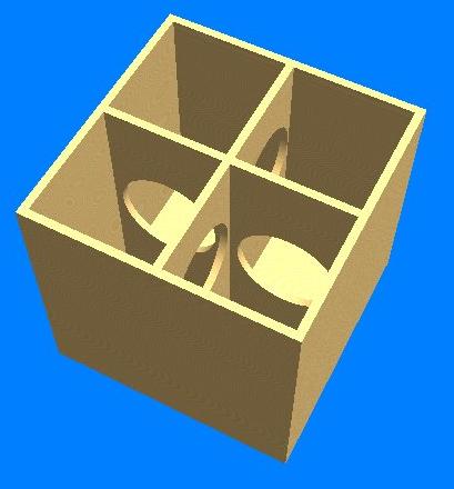

Out of interst - if you use the bracing - where would you put the sub?! :scratch:
Gaz
SimontY said:
Yeh, looks excellent.
The more the better, with 25mm and that size box it won't be perfectly inert, but with cross bracing like that it should be pretty good.
-Simon
Gaz
arg. ill just make do with the PDF.
i would have to cut the bracing on one of the sides, it was just a quick drawing.
