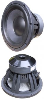

I am limited to a 14" wide and 24" tall front on the cabinets; the depth is 30" or less. This allows them to serve as sofa end tables. I don't think that the 12" drivers will conform to this dimension restriction or will it
You should be able to -- just -- make a 12 fit into a 14" wide cabinet (i assume you need to put the driver on a 14" face?) I am hot on the new 12" from CSS. It would be easy enuff to rejig the aspect ratio of the sealed sub to meet your dimensional requirements -- i think you'd even have room to do a push-push per side -- with sufficient power 4x12" should move enuff air to make your smallish room bulge if needed -- 4 even fit into your budget.

disclosure... i will be selling these -- a 2nd woofer to add to the Extremis in my limited line-up

Ray Collins said:
How important is it to use the Golden Ratio in the re-configuration of the box?
In a sub -- not very important at all. Everything happening inside is much higher in frequency than the sub will produce (excite), and from the outside the box the driver does not see the box.
The biggest concern is detailing the mounting so that it fits in 14". If i was doing push-push i might even consider 15mm sides.

I understand; I suppose that an additional 1/2" to make it 14.5" wouldn't matter.
I could mount the drivers on the wide sides of the enclosure which would also solve the breathing problem. In this orientation would it matter that one of the drivers would be firing into the arm of the sofa?
Ray
That is what I thought Dave. They will be offset but snugly integrated with a rigid brace which should preserve the desired physics.
