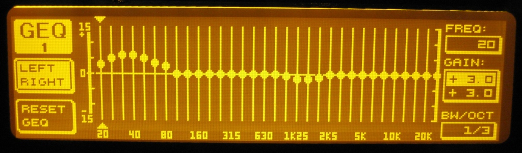

What are your plans in terms of EQ? Do you have a DSP based EQ like the Behringer DEQ2496? If not, then I really would suggest that you invest in one. I was inspired by Roger's articles in Speakerbuilder, but i never really did like the analog EQ implementation he used. To his credit, there wasn't really any other options out there at the time, but with the advent of really cheap DSP based EQ, you can truly fine tune the response on a pair of arrays to be perfect over as much of the audio band as you want. I have four different EQ presets I use depending on what I'm listening to, and how I'm listening to it. I have one that is perfectly flat at the listening position for critical listening, one that is intended to sound best when I'm moving around the room, one for movies/TV and one with a leaner bottom end if I really want to listen excessively loud (who doesn't from time to time). Having that kind of flexibility is a huge advantage!
As for comparisons to the arrays 18hurts built, it's going to be hard to do. I don't mean this as a knock against the guys who have built arrays here, but proper EQ is an extremely critical aspect of making these work. My arrays sound like absolute junk without any eq, and I knew full well that they would going into it. I've attached some pictures of the EQ I have implemented for my "Sounds best everywhere" EQ setting which is basically aiming for a flat anechoic response. If you look closely you'll see that they needed almost 10dB of cut through the lower midbass (around 160-800Hz) and about 15dB of boost from about 80Hz down. They're relatively flat through the midband until you get into destructive interference territory above about 8kHz where you need between 6dB and 8dB of boost depending on how you like the top end to sound.
For the arrays 18hurts built, he's probably fine without boost in the top end thanks to the tweeter array, and if he was careful with the crossover between the woofer and tweeter arrays then they might actually be pretty flat from 1k upwards. Anything below that though is probably not too great, and will definitely require good EQ and a measurement mic to get it right.
When properly implemented, I would honestly rate these as a true world-class loudspeaker. They have all the magic of a really good fullrange loudspeaker with none of the drawbacks. They image extremely well, and as I mentioned before, the bottom end integration is like nothing I've ever heard before. It's the best bass I've ever heard. The top end has all the sparkle and air of a good tweeter, and doesn't sound like most single fullrange drivers which always remind me of a 1950's radio, with no bottom or top end to speak of. The dynamics they're capable of is incredible, and if you relax the bottom end EQ you can play them at absurd levels with minimal distortion. I've never owned a pair of loudspeakers that were able to to all of the above as well as the line arrays can. My Ariels (Lynn Olsen design) have a slightly better midrange, but almost no bottom end. The Usher TL's I've used in the past have great bottom end but they can't go as deep and they don't sound as well integrated, and the only thing I've heard that is notably better in the top end is a NeoPro5i with a well implemented active crossover. Basically, you can do better in terms of individual aspects, but as a complete package, nothing even comes close to the line arrays.

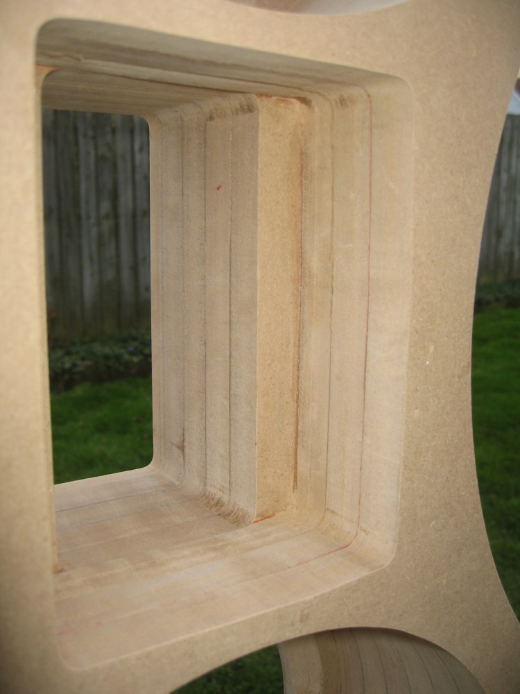

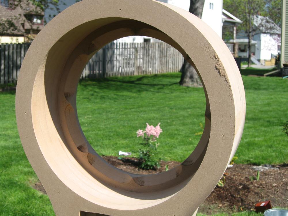

As for box construction, I'd really suggest that the large box be broken up into smaller sections to prevent standing waves in the enclosure. You should also never let drivers wired in series share the same sealed volume. If you have the patience, it might actually be beneficial to give each driver its own sealed enclosure using 1/2" or 3/8" dividers between each driver. This would make for an extremely stiff cabinet, and give each driver its own volume to work in.
You also need to be very cautions with mounting drivers that are so small. Use a thinner front baffle and make sure to chamfer the rear of each cutout. Letting the drivers breath freely is very important.
I can share my box plans with you if you'd like. I'll see if I can dig up some of the pictures I took during the construction phase.

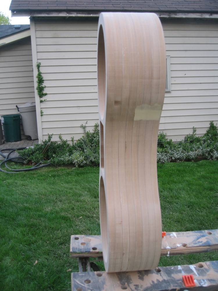

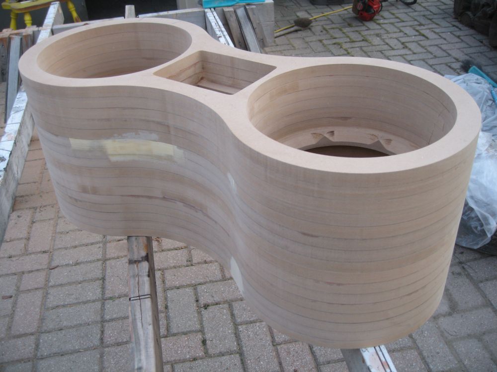

My cabinet plans looked like this but are open to change as I have not cut anything yet:
The plan was to buit this from 18mm and 12mm MDF in a (very) big stack.
The 12mm would be used for bracing and the 18mm for the actual chambers.
Stacking gives me the opertunity to make a round shape on the outside, helping with the WAF (GAF in my case ;)) and limiting difraction while the inner cavity could be made up with a wavy shape to limit standing waves.
The four holes around the circumfence are used for dowels while the bottom stack used threaded rods to connect to the footplate.
The inner parts would get a round over but because I want to water cut these parts I haven't drawn that.
As a backup plan if water cutting is too expencive I have a friend who is willing to CNC these for me.
The outer shape would get a layer of fibreglass bonded to it to strengthen and smooth it out. The plan is to mount the drivers with the frame touching and fill in the sides to the outer box to have them close to flush.

You are 100% correct, those things NEED EQ to get the proper sound. I went with the Apex Jr. tweeters since they having a 3dB rising response from 4 to 8 KHz which gets the response fairly flat past 10 KHz. The 2-way design was chosen to limit the amount of EQ required over full range designs. Where the upper mids mesh with the tweeter line is an EQ issue and I'm going to construct a tapped horn for 16 to 60Hz bass response (I like pipe organs)
Since I will never again build a two-way array, I find the full range versions very interesting. Tangband almost builds something that might be better for full range arrays with a low 60Hz Fs, 86dB 1w/1m, 5mm Xmax and a rising response at 8 KHz that jumps 4 to 8dB from 8 to 15 KHz. The TB W4-1720 returns to "normal" at 20KHz so might work well with arrays?

That looks like quite the undertaking, but it's a good plan! You'll have your work cut out for you getting all those pieces stacked and glued.
I did something like that, but with a meager 16 layers. I'll never do it again since it was an obscene amount of work, but the result was better than I had expected. Just glue and flush trim each layer, one at a time!
If you do decide to go that way, you should really consider a thin layer of wood between each driver since it would be really easy to implement. That would allow you to do away with the braces entirely, and would have a minimal impact on internal volume. Giving each drive its own volume would definitely be beneficial.
If you're good with fiberglass and auto body filler, I think the finished result could be very impressive looking.

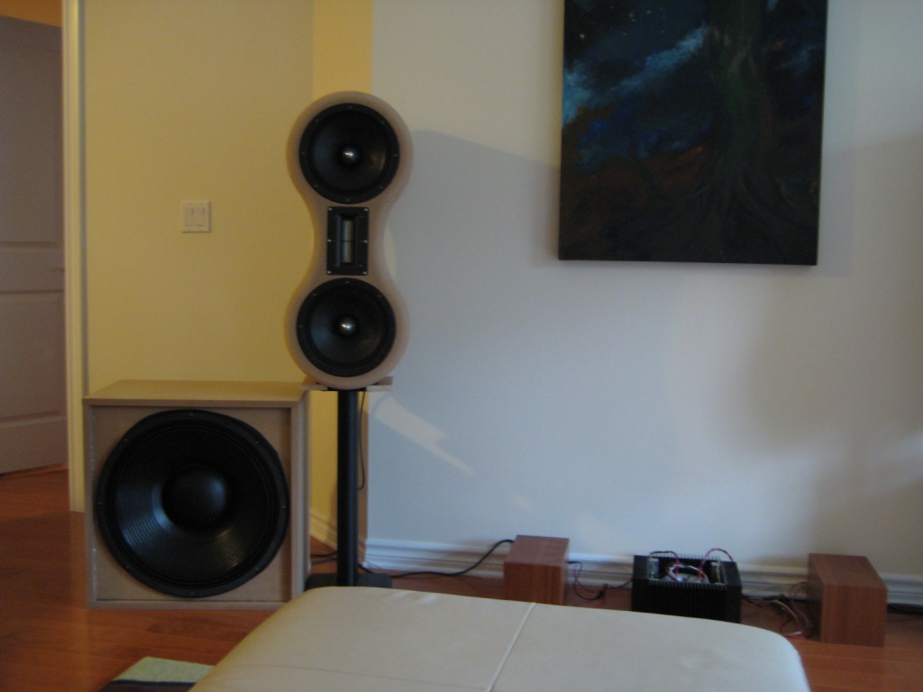

Thank you very much for the heads up, Owen
At this point, I'm just happy that my hands quit vibrating from all the machining required for 96 tweeters! :eek: My wife is thrilled with the arrays, it gets me out of the house so she can listen to her music--and I can listen to mine.
At this point, it is tweak time as I attempt to get them to sound correct for classical music and they are getting close. The feedback destroyer might work well for me as it has 12 parametric bands per channel... more stuff to mess with! Since a "digital EQ" will eventually be thrown in the mix, I'll ponder that solution after I go with a proper tapped horn subwoofer and mixer (guitar connection).
I have been asked at least a dozen times to "build a pair of those for me!" since the populace at large either likes the sound or the "look" of the things. For house use, I'll leave it up to those that have built and operated arrays in their house for wisdom. A nice solution for acoustic hell in a metal walled garage with cement floors and plenty of objects to reflect from but I'll leave it to you for proper music/HT design philosophy. My wife absolutely refuses to allow those monsters back in the house.
At this point, I can highly recommend arrays for garage/party speaker use since they sound better than point source in a highly reflective environment. For those pondering building them, I give two thumbs up for full range construction since 2-way fixes EQ problems but also creates a few issues at the same time. Basically, you'll need EQ anyway so go with full range and get the proper EQ and run.
Passive solutions need not apply for DIY--JBL can hook you up if passive is required.

So tow thin could that layer be without possibly going to resonate/vibrate? A 12 mm layer would take up most space there is between the drivers if they are mounted flange to flange.
Mr. Russell used one large space only devided by about 12 braces with two big (1-14" or 63mm) holes. I sort of copied that concept but made sure the other brace shape blocked the holes when looked at vertically. They have the opening near the baffle to be able to wire the speakers there.
So in short, I know what you're saying but it is kinda hard to realise.
opc
Joined 2004
You'd need to use a 6-8mm sheet between each driver if you were going to go that way. That's about as thick as you can make it while still mounting the drivers basket to basket.
That would be more than enough thickness to prevent any sort of resonance. Keep in mind that they have strength in numbers (there would be 24 internal dividers and 2 thicker external tops and bottoms), and there is technically no actual net pressure drop between the internal dividers (since the adjacent drivers will all be in phase) so they will not be prone to resonate. For added effect, you could always add a 2mm layer of bitumen sheet to both sides of each divider once you're an inch or two back from the driver.
Wooden airplane wings are built like that, with multiple thin wooden braces which provide incredible strength simply because there were so many of them. This would be the exact same principle.
Owen

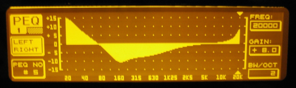

Take a look at the EQ profiles I posted a few posts back. I have a PEQ at 20kHz with a gain of 8dB and BW of 2. This is specifically to counteract the HF rolloff caused by comb filtering. With that EQ in place, the array both measures and sounds perfectly balanced in the top end.
Again, it's a little more complicated than just taking the C-C spacing and saying "It's going to comb filter above this". In actual fact, you start getting lobes in the far field at the frequency with a wavelength that is equal to the C-C spacing, but the first actual comb "cancellation" doesn't happen until twice that frequency. So in the case of the Vifa drivers, the C-C spacing is 83.75mm which is a frequency of 4100Hz. The first actual cancellation doesn't happen until 8200Hz. That's where the output is going to start to diminish, and where you'll need EQ.
The problem is further compounded by the fact that the driver dispersion is no longer spherical at these high frequencies, and to get comb filtering, you need spherical dispersion. The little drivers start to be become more and more directional at higher frequencies, and this counteracts the effects of combing, much like an array of ribbons would. The reason an array of ribbons doesn't comb filter is because the dispersion patterns of the ribbons don't overlap, meaning there is no cancellation and no combing. All of this is covered in Jim's paper.
