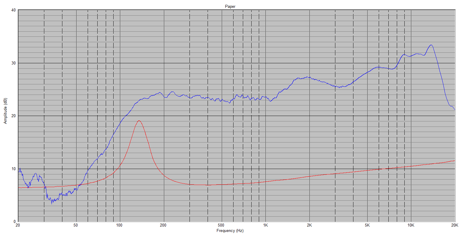

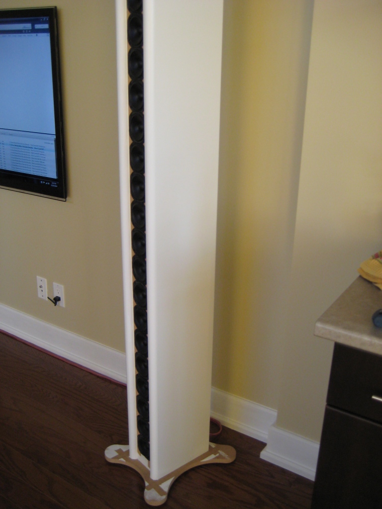

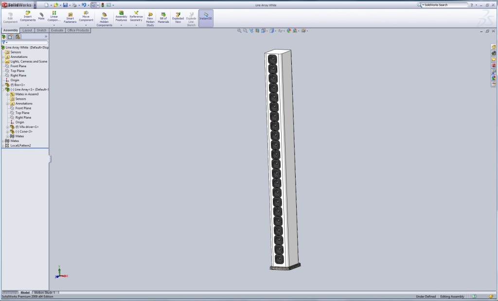

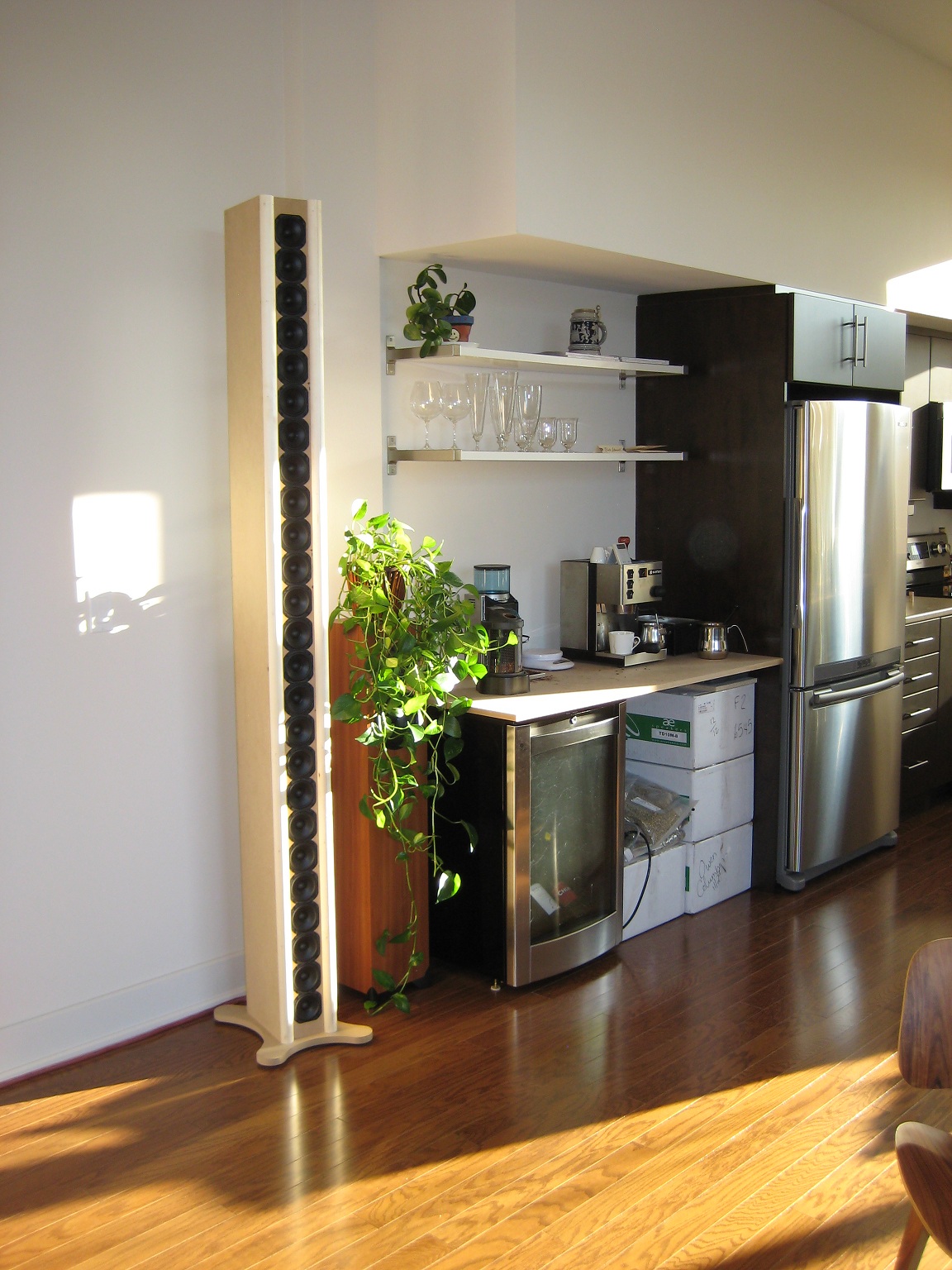

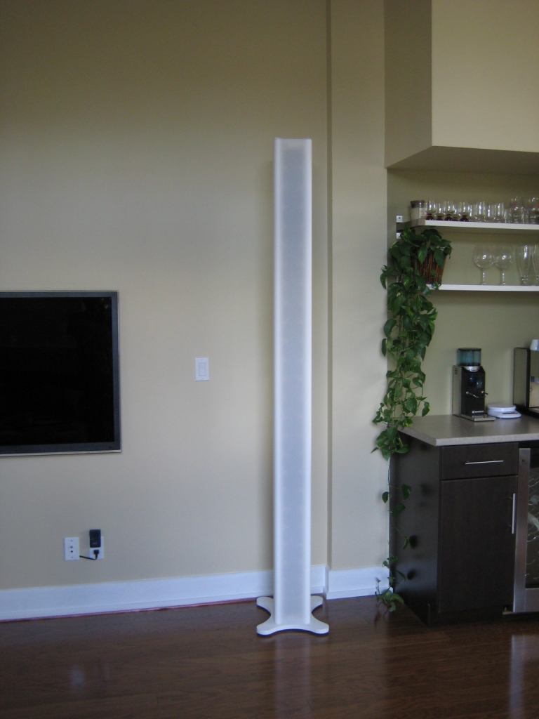

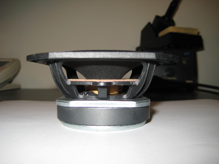

I just thought I would chime in here since I've built and have been living with a full range line array for the past year and a half.

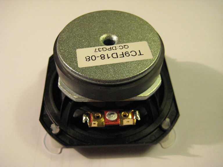

I used 25 Vifa TC9FD18-08 3" drivers per channel, for a total of 50 drivers. The lines stand about 88" high, and the ceilings are about 125" high. The drivers are mounted frame to frame to get the closest possible C-C spacing which ends up being 3 5/16". The drivers are arranged in groups of 5 where each 5 driver group is wired in parallel and shares a common sealed section of the enclosure. Each group of five is then wired in series so you end up right back at the same impedance as a single driver. This arrangement is important because it does two things:
1. Prevents standing waves in an 88" high enclosure.
2. Prevents series drivers from sharing the same enclosure volume (this is critical)
I use a Behringer DEQ2496 before my DAC (entirely in the digital domain) to provide the necessary EQ for the lines. I'm sure you could tackle the EQ in the analog domain, but the DEQ is such a capable device that it's worth 10 times what it costs to buy, and the end result is better than you'd get with an analog filter. If you're building a line with full range drivers you absolutely will need active EQ of some sort.
I'm running the lines full range (without a sub) in a very large room, and I get genuinely flat response (-3dB) down to 20Hz. It's the absolute best bottom end you will ever hear from a loudspeaker. It has all the impact and depth of a really good subwoofer, with none of the horrible integration problems. It's literally seamless. My jaw dropped the first time I heard what they were capable of. They are also capable of playing at astonishingly loud levels, which translates into very good dynamics. If I were to relax the bottom end EQ so they rolled off at 40Hz, they would be more than capable in PA applications.
Of course, there's the elephant in the room which I'm sure half of you were repeating constantly in your heads as you read this: comb filtering.
Honestly, it's not that big of deal. As speaker dave mentioned a while back, if you're playing pink noise, and standing within a meter or so of the loudspeakers, you can definitely hear the lobing effect by moving your head up and down. It's also very easy to measure with a measurement mic. Once you're out around the 2 meter mark, it's barely noticeable, and any farther than that, you simply can't hear it anymore. Same applies with music, except you need to be about half the above distances to get the same effect. In other words, if you're playing music, and you're more than a meter from the array, it's not an issue.
The common argument is that point sources that radiate spherically into space will start to interfere with one another at frequencies with wavelengths that are equal to or shorter than the C-C spacing of the sources. This is indeed true, but since we're dealing with full range drivers, they're not perfect spherical radiators, especially at high frequencies. The narrowing dispersion at high frequencies helps to counteract this effect, and makes the drivers behave more like a line of ribbons at very high frequencies, which is exactly what you want. In practice, the arrays require very little EQ in the top end to counter this effect. For me, it's about a 6dB rise from 10kHz to 20kHz to make it sound and measure flat. My listening position is about 3.5 meters away from the front of the speakers.
Finally, I'd like to address the single biggest problem I have with the way people build these things:
DON'T USE CRUMMY DRIVERS!!!!!
This thread started off just like so many others:
"I found out that I can get a box of 50 terrible drivers for $25 and I think I'm going to build a line array out of them".
This is a HUGE mistake, and I can promise you that if you start with junk, you'll end up with junk (just more of it). All 50 of my drivers cost me $333 which is actually cheap compared to most loudspeaker projects. I picked them after carefully considering and auditioning 8 different 3" drivers. You really need to listen to the driver you plan on using as a full range driver with just one driver in a mocked up cabinet. If you don't like the way it sounds by itself, then using 50 of them isn't going to change that. I listened to each driver exactly the way it was, and then with EQ to make it flat. The Vifa drivers I chose were a little bright straight out of the box, but with some EQ they were by far the best sounding of the group.
The amount of work involved in actually building a pair is enormous, which is why you really need to put the effort and money into using a good driver to start with. Putting that much work into something only to ruin it by using 50 cent drivers is a genuine shame. Time and time again I see people putting hundreds of hours of their time into building a pair, and then skimping on the drivers to save a few hundred dollars. It's really sad, especially when there's so much potential!

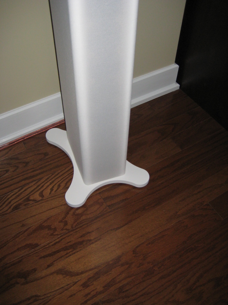

I've attached a few pictures of the finished arrays, and hopefully someday I'll get around to properly documenting these in a proper project thread.

Thank you for the report, Owen
After I read about arrays, I decided to run a 2-way crossed at around 4,200 Hz to limit beaming. The tweeter line should also limit excessive EQ requirements which is important when used with guitar amps etc.
Very interested in your comments of the 1 to 2 meter sound change. I noted that when I was 1.5 to 2 meters back, testing my 5" woofers "full range" sounded much improved. Can't wait until I can hear the tweeter line come to life as I'm still waiting for XO parts to arrive.
You stated you tested eight different brands of 3" woofers and FRs--any of them Dayton ND-91s or Tangbands? My only concern is up to 4KHz with efficiency and bass response critical factors. My minimum efficiency is 85dB 1w/1m since I'll be using it with lower power amplifiers (guitar, car amps etc) and need final efficiency at least 96dB at one watt/one meter. The dream 3.5" would run 89dB with decent Xmax and Fs of 65Hz but I'm not holding my breath.
