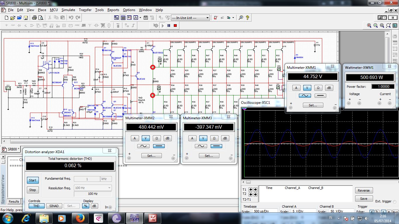

today I tried to simulate the SR200 using multisim software, I tried using a voltage 77VDC and try to power up to 500W with 4 Ohm load. I get THD at 0.062% and the low distortion. I'm still a beginner using this software and do not quite understand about the power amplifier, I need guidance especially to Mr. Power's Mile designing.
My question, when running the simulation value of the voltage at the red dot, for at the + value always increases until it reaches a peak at 500mV and the red dot part - always below the value of +. why not draw? if like this then? I do not really know

I would think that using a simulation package for predicting maximum power is probably not going to be useful.
The Maximum power is limited by the supply voltage while the load is pulling down the supply and the current passing through from PSU to Load.
These two limiting factors can be more easily and accurately determined by measuring the amplifier.

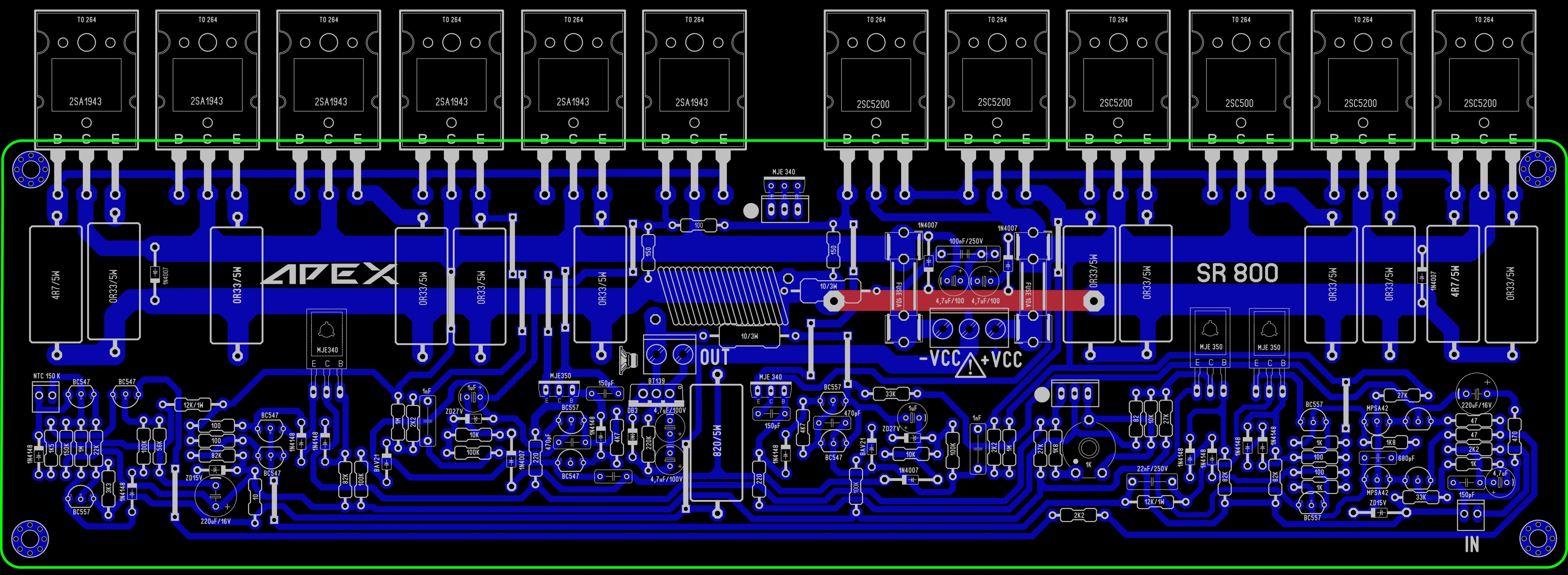

..... PCB ready , please someone check if it's correct layout . I will post in B&W the layout of PCB .
Schematic will follow soon .
Regards ,Alex
I can't find the schematic but it looks like the base ties to the output through 4R7 resistors?
